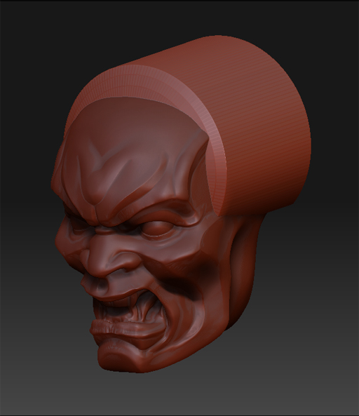

So I have basic question I hope you can help me with. I want to add a separate object to my scene. Here’s what I did. Please tell me if this is the correct procedure?
From the “Subtool” layer I selected the “Append” button then I selected the Cylinder, then it is added as a separate Subtool.:smiley: but when I try and rotate the cylinder the head rotates too.:cry: I only want to rotate the cylinder. What am I doing wrong?
If you are going to sculpt one of the ZBrush primitives you need to convert it to a polymesh first. So this would be your workflow:
  1. Select the Cylinder3D ztool. Change the settings in the Tool>Initialize menu if you wish.
  2. Press the Tool>Make Polymesh3D button. This makes a sculptable version of the primitive.
  3. Select the head model in the Tool palette, open the Tool>SubTool menu and click Append. Select the PM3D_Cylinder3D tool from the pop-up. (This is the polymesh you created at 2.)
  4. Select the new cylinder subtool in the SubTool list by clicking on it.
  5. Switch to Move mode. Hold Alt and click on the cylinder you will be able to drag it to move its position relative to the head.
  6. You can also switch to Scale and Alt+click+drag to change the size.
  7. To Rotate you will need to use the Transpose Action Line. Click and drag to draw out the Action line, then click+drag the end of the line to rotate.
