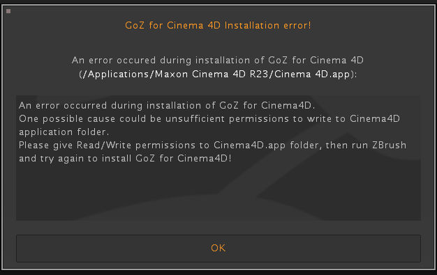

How fix cinema r23 goz installation?
How do I fix goz Cinema 4d r23 installation issue?
Screen Shot 2020-12-20 at 4.16.07 PM
Hello @jBibble

Hi,
looks for me that you don’t have the rights to install this app in the C4D directory.
If you on Windows then you could try to install GoZ for C4D as administrator.
Right click on the Goz installer app and select ‘Start as administrator’.
Good luck
I have got the same problem. Could not solve it via administrator rights. Apprechiate every tipp.

OK I had the same problem and I tried to fix it several time in zBrush without getting it workin. For my workflow it is really essential.
Today it dawned on me that I should try to clean the pipes from cinema4ds side.
I closed zBrush and went to C4d -> Plug-ins -> go zBrush -> GoZ installation
Now it is working again. I hope it does the trick for some of you too!
Grazellka
¡I tried this and works for me! I am using the “zbrush 2022 and Cinema 25”
I copied the file what they told us in the instruction but i changed the folder destination, in my case i just paste the file in the main folder of the Cinema that you are currently using
Here is the instructions manual:
http://docs.pixologic.com/user-guide/zbrush-other-programs/goz/manual-installation/
