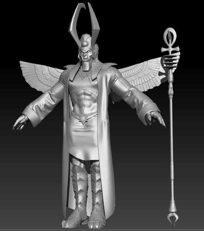

Here is the model so far

You can’t see it in the pic I have attached, but the clothing parts like the leather jacket and chest pieces all have stitches etc, once I lower the subd, the stitches don’t look as good, you can tell that the mesh needs more resolution.

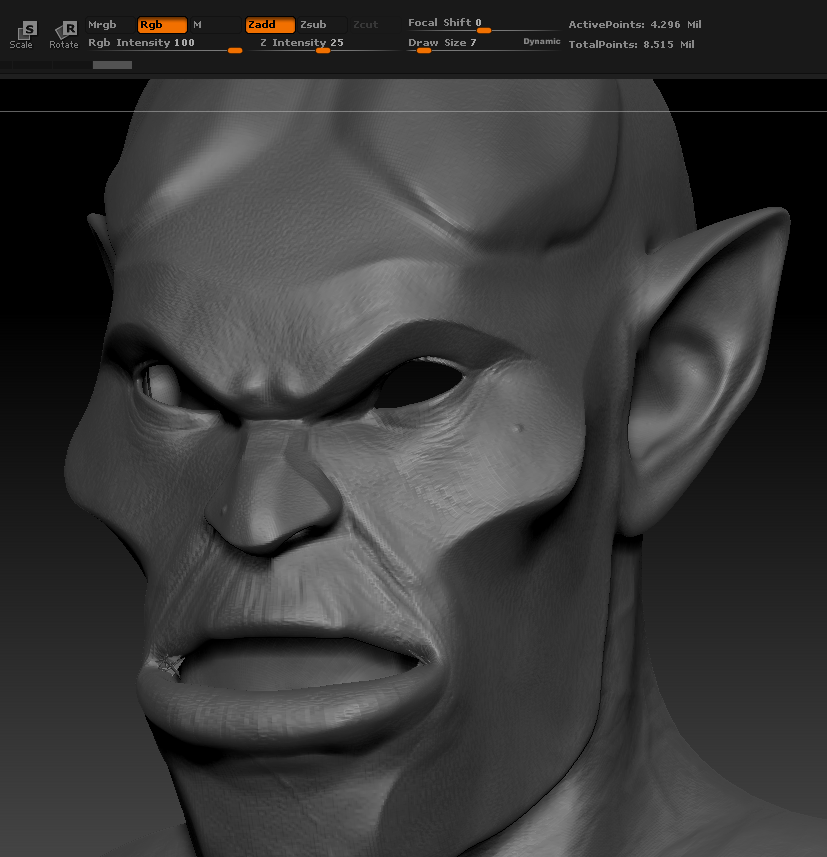

Ok, so Im adding some pics to better illustrate my point, maybe someone can see something in my modellng that I am missing.
Image 1- This is the big poly detail, Even at 4million Polys, i still get facets in the mesh, the model does not need to be close up so it’s fine for now.

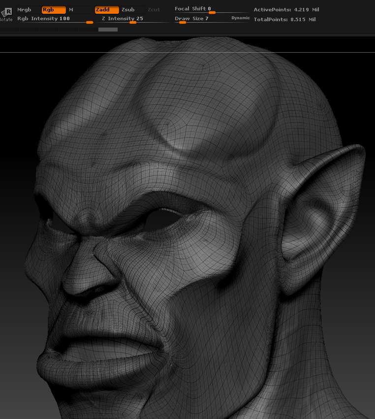

Image 2- This is the same mesh, showing the topology, so in order to get he level of detail I need in this mesh, I’ve had to go to 4million Poly’s. which is fine. But all these Polys for like 20 something subtools adds up, and brings my file size above 1gb, so I don’t get how so many people keep such low file size with all this high level detail.

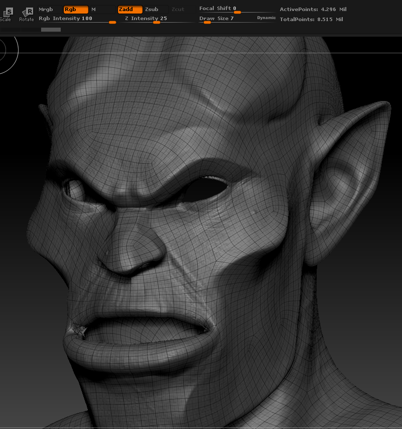

3- this is the Zremeshed model, showing the same level of detail, still at 4million Polys.

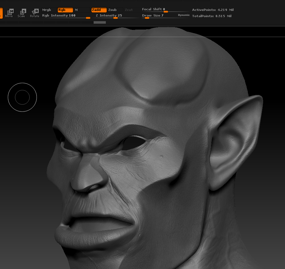

4- This is the topology flow.

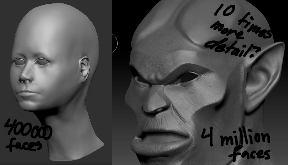

This is my point, you don’t need that many faces. :wink:
thanks for responding Djdor, If you wanted to start scultping in pores and wrnkles etc on the mesh head you have there, you would be able to do that on your current mesh with 400000 polys?
So why does it take me up to 4million to get the same detail, if i reduce the amount of faces as your suggesting, then I lose the detail I have. no? How are you able to do it 400000,
I think he’s comparing a head mesh with 400k polys to your full body mesh where you have 4 million polys distributed across the entire figure. That’s not quite the same situation.
