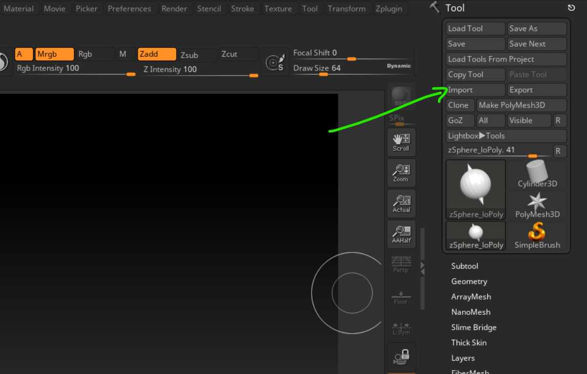

You can import 3D Files into Zbrush through the tool menu, located by default on the top right-hand section of the screen. Here is a video that explains the process in simple terms (beginning at 1:45) : https://youtu.be/8U7XnnL1HHE?t=107
