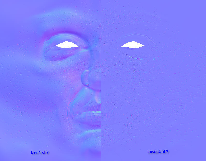

You would go down untill you are at a level that is within this limit. There still isnt enougth deformation change between these levels to make a normal map retain un wanted displacment. My maps from testing this are only showing micro details, not huge displacments, perfect.:smiley:
I havent done any further test, but I asume making normal maps this way would help smooth bad seams by only making normal maps based off micro details?
