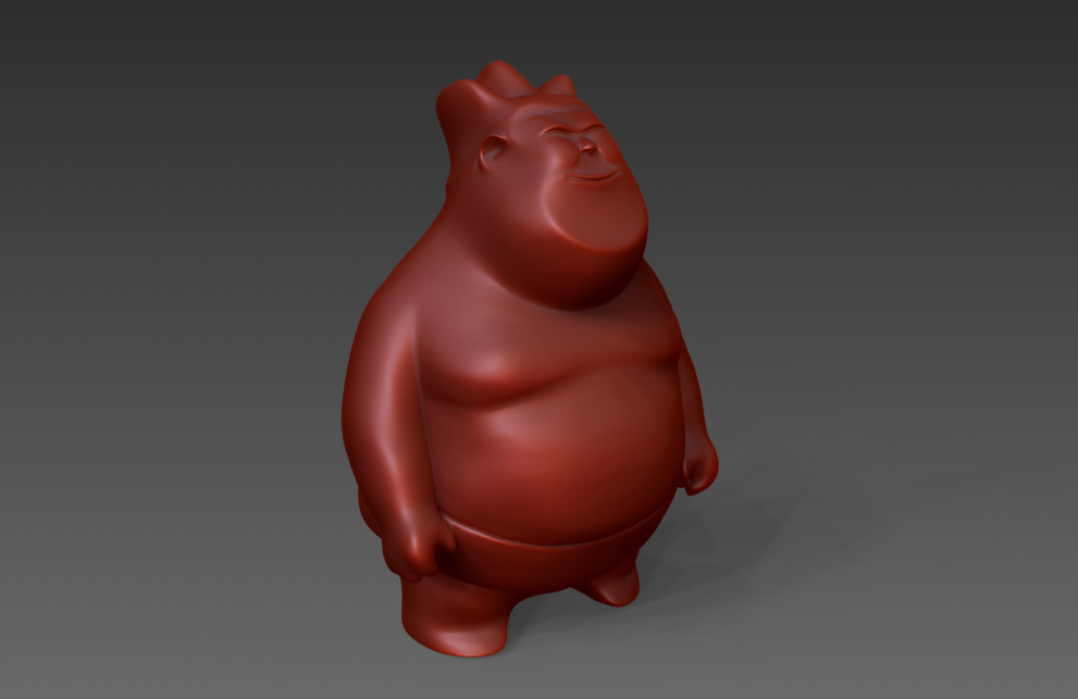

I’m posting this message because I’m an animator looking for a job, and to earn a little money I accepted a character modeling mission. Unfortunately, I’m not a Zbrush pro!
So here is my problem: I modeled the body of the caracter from a sphere, and then to have the arms come off the body, I added Zspheres. I merged the meshes, but now I have this ugly line on the shoulders that I have to erase in order to complete the modeling (and be payed, at last).
I’ve searched on the internet but couldn’t find any post or tutorial that would help me.
I precise that if I import the character’s OBJ in Maya, the arms and body are 2 different objects, whereas there are one in Zbrush.
Many thanks in advance for your help, I can’t wait to get rid of this mission.

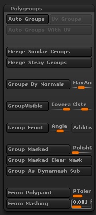

But yes I did go to the polygroup section, and tried all the grouping options.
Here is a photo of all the available options.

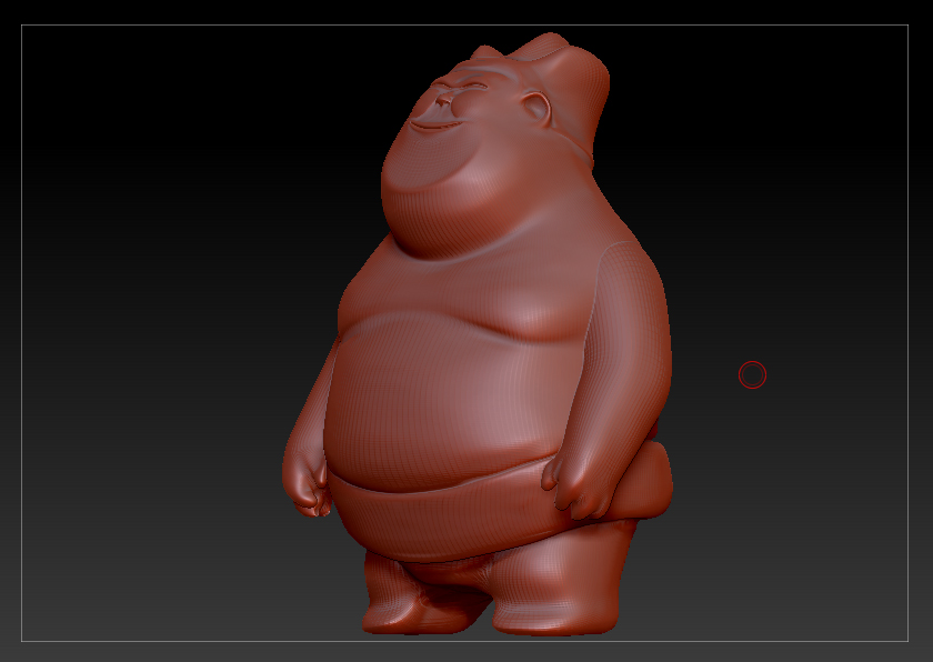

Hey killer,I apologize… I wasn’t notified of replies to this thread.
I saved a couple versions of what I thought was the ztl that I screen capped… but they’re huge files, and I’m not sure they’re the right ones.
I also couldn’t remember exactly how I went about it… so I’ll try starting over…
Loaded your ZTL.
Duplicated it. In order to keep the detail for projecting, I divided your original and the duplicate to subd 3.
To combine the groups before dynameshing, I think I used decimation master on the dupe (at the default settings).
For dynameshing the decimated copy, I use the DynaMesh Master plugin.
Just the default settings, but I reduce blur to 1, and turn on project. 1.5 million polys.
Project all again to get detail back from your original.
Now the dynameshed copy is all one group. Smooth brush on shoulder seams worked.

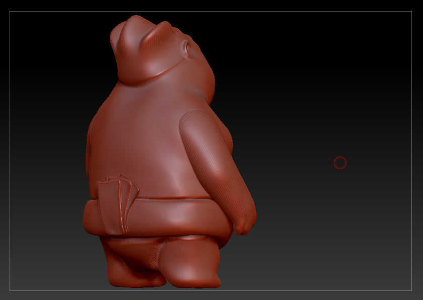

Now you can zRemesh to get the polycount back down. NOTE: because of the stuff on his back, you can’t have symmetry on when you zRemesh. If you want a nice symmetrical remesh, you should split that stuff off of his back before you start any of this.
Also, his eyes and mouth are a little sketchy in the dynamesh, so you’ll need to tweak (perhaps with the pinch brush).
