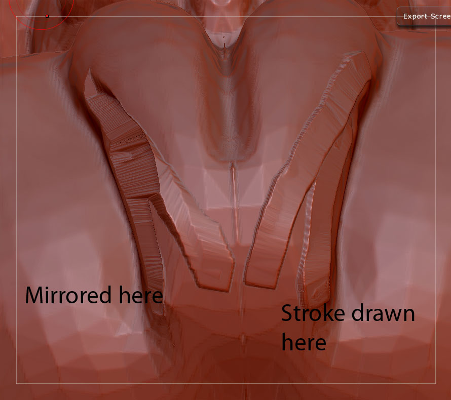

I am having trouble with the new release of 4R2. It seems like symmetry or mirror are acting on the model in opposite directions, one side of the model the points get “pulled” and the other get “pushed”. If you look at the line of symmetry one side the brush stroke raises off the model while the other pushes into the model. Also Having trouble getting the pivot centered and lined up properly on the model.

I have tried turning mirror on and off in all three axis, i have resim’ed and smart resim’ed the mesh. I have tried clearing and resetting the pivot point. I have mirror and welded the right side to the left, i have exported the mesh as an obj and imported it again. I have tried to unify the mesh. I have tried these steps, and a few others, in different orders just to see if I could stumble on the right sequence of commands but nothing seems to work. If I go to earlier saved versions of the mesh than this problem does not occur but using the most recent couple of save files i have the issue. The mesh is %99.99456 symmetrical so that shouldn’t be an issue.
Will post a screen shot later on when i get a chance, I would be happy to send a .ZPR to someone interested in checking the file for me. Thanks again.
Make sure Transform :small_orange_diamond: Activate Symmetry :small_orange_diamond: >M< is turned on, in addition to the desired axis of symmetry. That tells ZBrush to mirror across the symmetry axis.

Thanks for the reply, that solved the issue, i must have inadvertantly switched that off and not realized.
