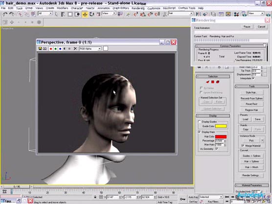

Thanks for that advice… Also can anyone tell me how to get hair shadowing like this on Hair and Fur? This is off the the 3d max demo video.
