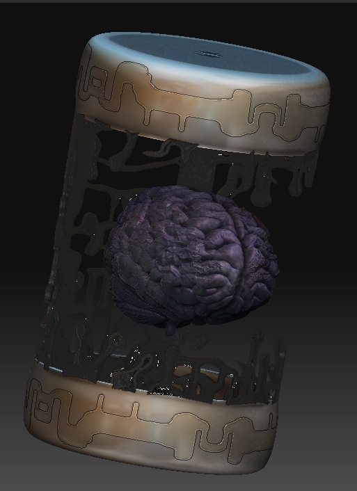

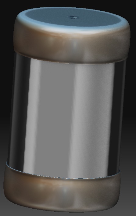

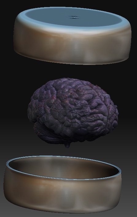

I am trying to make a glass jar. A creature is holding it, and i want to see what is on the inside. i have followed a few different ways to do it but with no success. I am a little confused that there aren’t many up to date tutorials on glass. Or even a Glass material, is it just that i cant find them? :ex:

Thanks Aurick and Marcus, i will give it a shot tonight.
