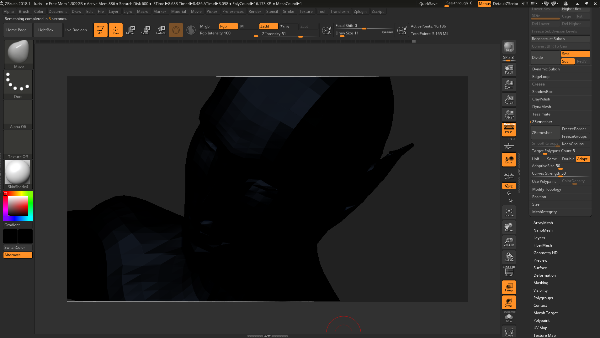

Figure turns black when pressing ZRemesher
Hi all! I’m incredibly new to Zbrush, so new that I’m still on a trial version that I just started. I have no idea how to navigate this site, so I’m sorry if I’m doing anything wrong.
I’ve done a few tests sculpts so far but today I decided to download a free base to see how that’d go, and so far so good, but there’s an issue - when I press ZRemesher the figure turns entirely black. What am I doing wrong to enable this?

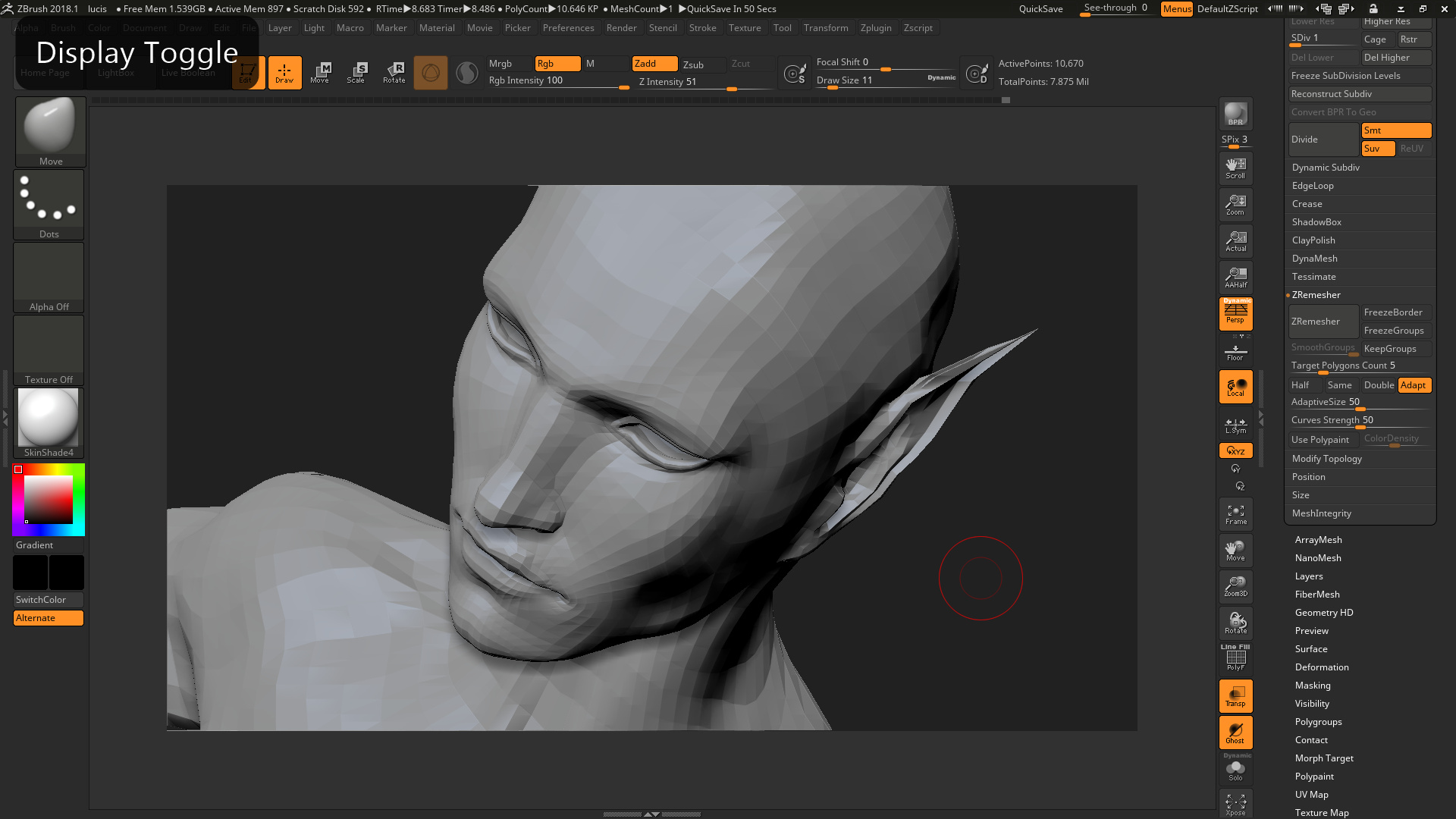

As a side note, it seems like Dynmesh isn’t doing anything when pressed either… and when pressing Divide a few times, the sculpt gets weird “pinched” areas that look anything but smooth.

As to your issue, you’ll notice that your color selector is set to black. By default, Zbrush will display the currently selected color and material on tools/subtools that have no active polypaint. What probably happened is that the mesh has active polypaint which is then removed by the ZRemeshing, so the model is just displaying your currently selected color.
Thank you for your answer, it helped! I haven’t been playing with polypaint just yet, so I had no idea that’s what had been causing it.
