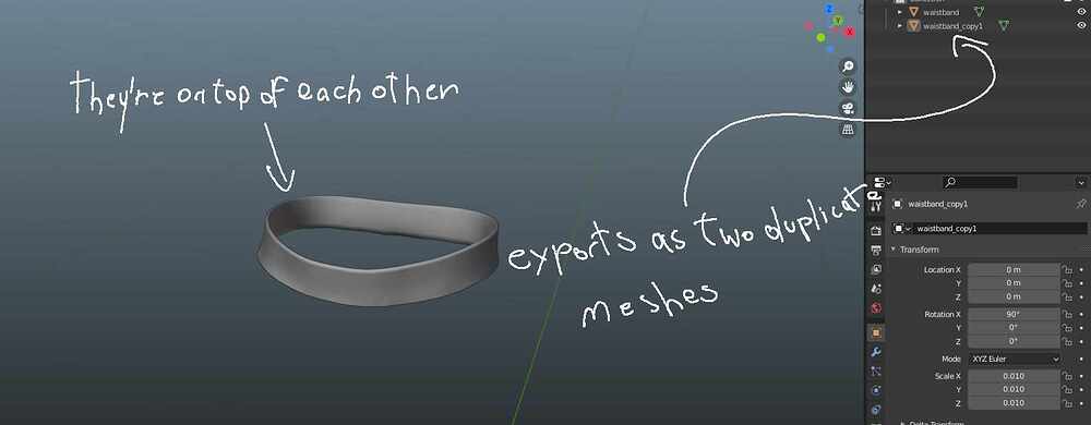

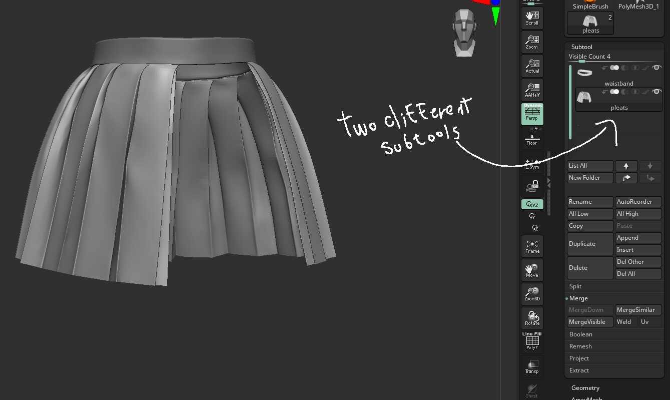

i imported a marvelous designer mesh into zbrush and after i was done with the cleaning up i split the mesh into two subtools respectively based on the garment
when i export the subtools as an fbx file. my pleats disappear and the mesh is replaced with a copy of the first subtool
im completely puzzled and confused as to why this occurs. no matter how many subtools i have they always get replaced with a copy of the first subtool.
merging works just fine on export but i would like to have different separate meshes under one fbx file.

i have tried, not the solution sadly. as you can see it doesn’t export a single subtool, it exports two but they’re duplicates.

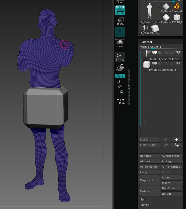

i was gonna provide you with the steps to see if zbrush would give you the same result. you just need to import a custom fbx mesh, append anything to it and export it out as multiple subtools. when i do this the appended subtool doesn’t show up and instead the custom fbx mesh i add gets copied.

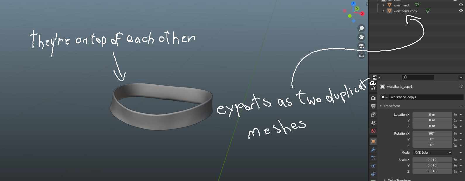

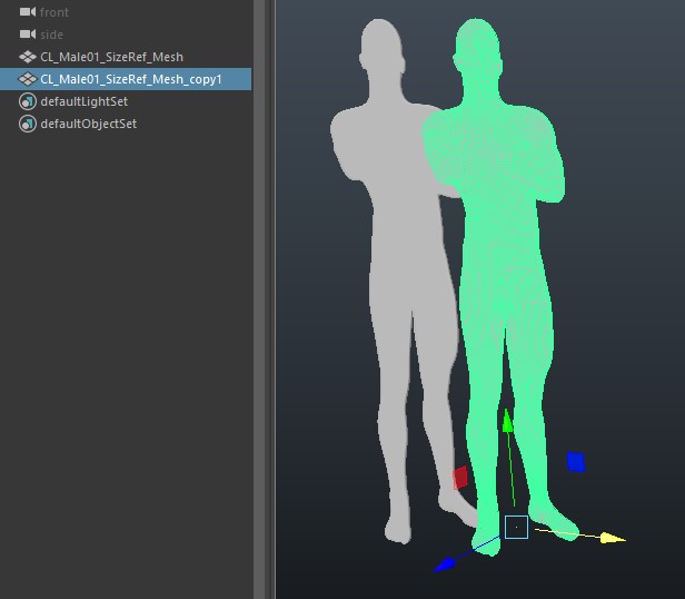

Okay I tried it that is weird, it exported the 1st subtool twice just like your issue you had. I have no idea why it dose that.
Exported FBX file
Screenshot_1
Imported FBX file
Screenshot_2
Pretty Crazy
