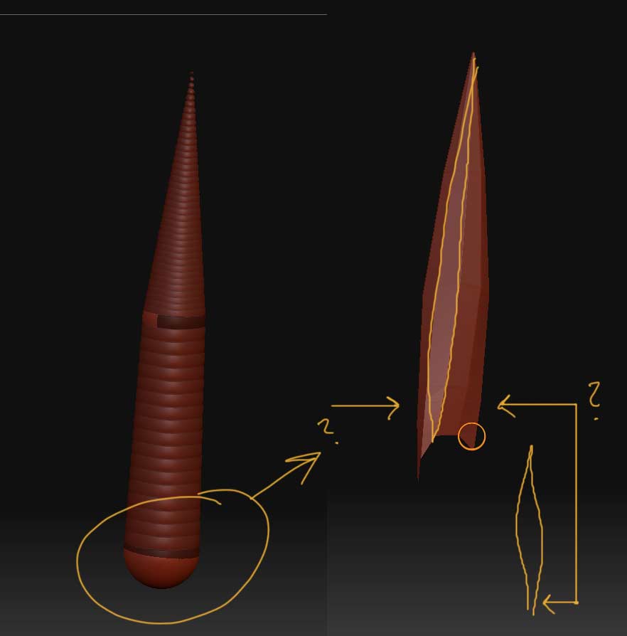

Why does this happen?.
I can’t find a “reset” for the ZSpheres.
Ok, so I missed a detail. Now it worked.
BUT! When I’m applying the lash it flies around as hel**, annoying!

I’m not sure what your question is but I do know that the error that your showing in that picture is because you haven’t started your zsphear chain right. It make no sense but zspheres like to start with the first zpsheres, then with symmetry on, add a zspheres to the top and bottom. I think its a bug to have to start this way. After that, use then normally.
cheers
Dylan
Thanks man! Yea, I noticed this and got it right this time :slight_smile:
