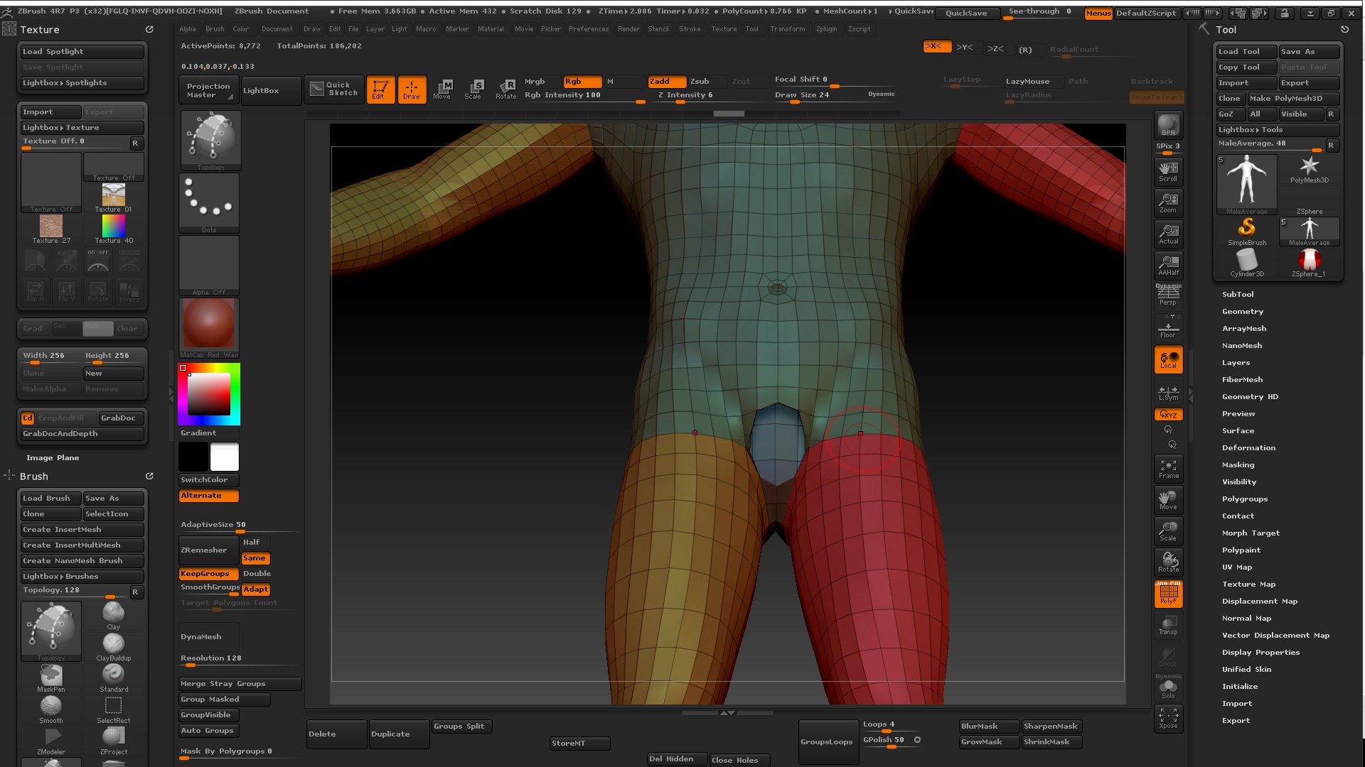

Hi, I have a model that I want to edit. I want to remove the genitalia :stuck_out_tongue: from this mesh, and when I do I’m obviously left with a hole in the mesh. When I try to use close holes or stitch it with ZModeler brush, it creates triangles.
How do I close the hole without making triangles? Is there a way to edit the existing topology/geometry to create squares directly? I have seen an instructional where the guy deleted and inserted new edgeloops into an existing model/mesh.

B Z M ,lots of options :slight_smile:
Ouch!! DIY vasectomy gone horribly wrong.
I second Doug Jones…B - Z - M
All the tools you need are available in the ZM brush.
Could you be more specific as to the approach? I have tried using the ZM brush, but I can’t figure out how.
Remember that you want to close a hole :wink: A bunch of tips here>> http://www.zbrushcentral.com/showthread.php?191472-Z-Brush-4r7-tips-(Zmodeler)(nan-mesh)(array-mesh)(zremesher2-0)
Close hole using ZModeler.
https://vimeo.com/178635091
Thanks guys, I figured it out… why is nothing in zBrush straightforward? :stuck_out_tongue:
