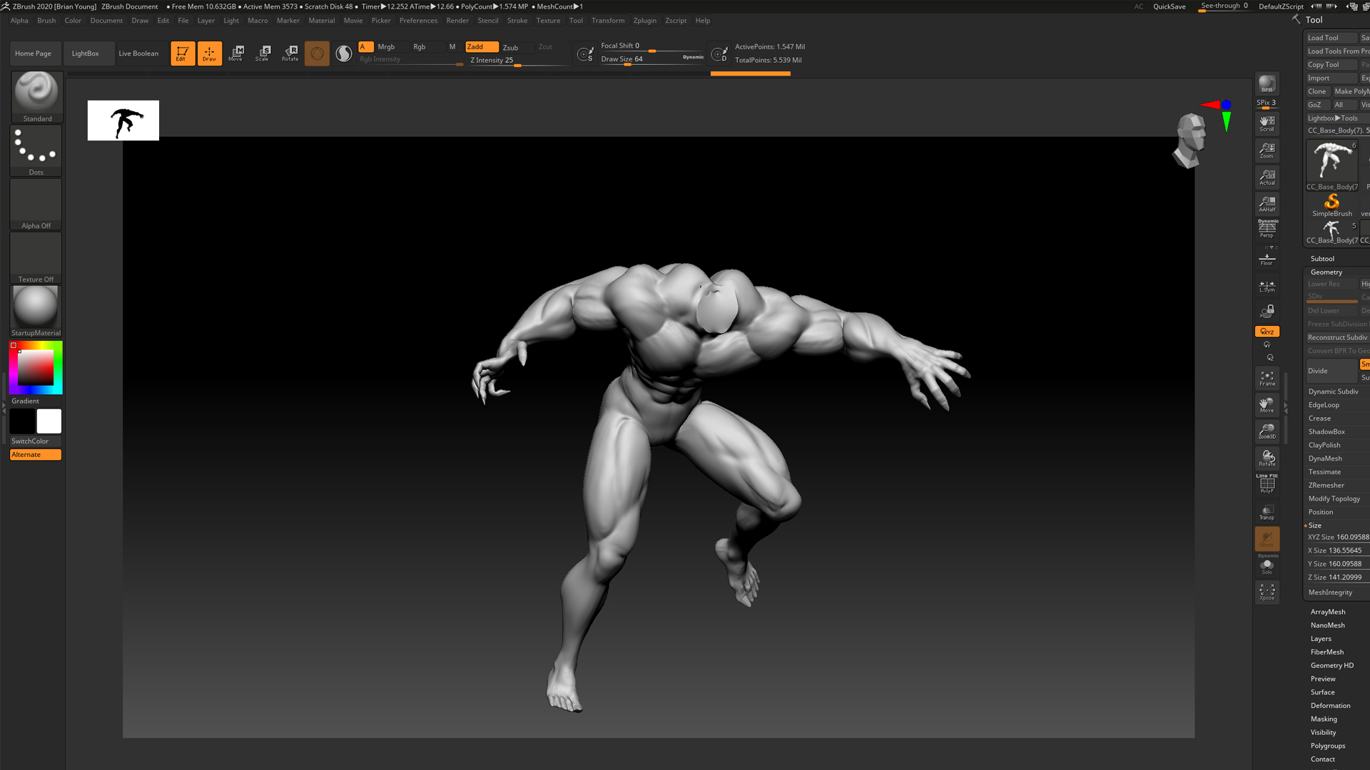

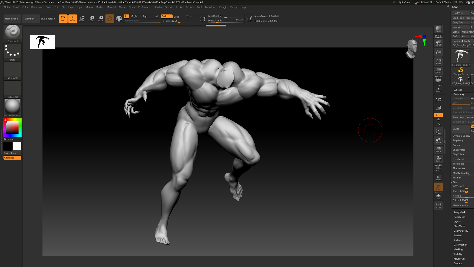

The first pic you can see the piece is abnormally large, before dynamesh it was about 3 mill polygons. The second pic the mesh has been unified and then dynameshed. Both times the resolution in dynamesh was set to the max 4096.
Ok, the first thing I notice here is that your Dynameshed subtool looks really good. I assumed your problem was stemming from a loss of detail, but there’s no significant reduction of detail here.
One point:
If it was originally abnormally large in the Zbrush worldspace, then it would have received a greater amount of polygons when dynameshing. The reasons for this are explained in the video I linked above. The size of the polygons Dynamesh generates at a given resolution is fixed, so larger objects simply receive more of them by virtue of having more surface area. In this scenario, I believe it is probably the 3 million polycount that is abnormal.
So my best guess, is that Dynamesh simply doesn’t need more polygons to capture that detail. It would force more polygons if you increased the mesh scale, or increased the slider rez if it wasn’t already maxed out. But that polycount wont change significantly at this stage with dynamesh unless you add more detail/surface area.

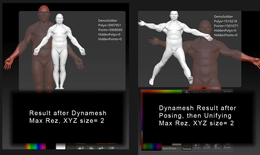

I had to test this to make sure it was happening the way I thought, but here’s one scenario where you might end up with that rez on a figure mesh.
I notice your mesh there is posed in a wide or splayed stance. This effectively increases its “bounding box” over a character mesh in a more neutral position. When you use the Unify command it fits the mesh into the preview window (Tool > Preview, not the Canvas). Since the posed character occupies greater bounds, the body must be scaled smaller in order to fit, resulting in less surface area available to receive polygons from Dynamesh. This is also why your head model achieved a higher resolution–more of its surface area can fit in the preview window with less negative space.
See the image below:
dynarez
