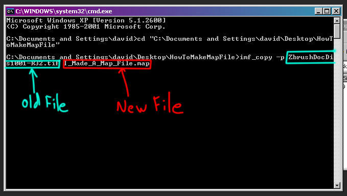

One last thing. Did you convert the Zbrush .tif file into the MR .map format. I know the PDF file says that MR will just have a little trouble with the .tif file, but I have had times when I couldn’t make it render. You really do need to use the command line to convert this file.

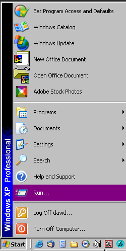

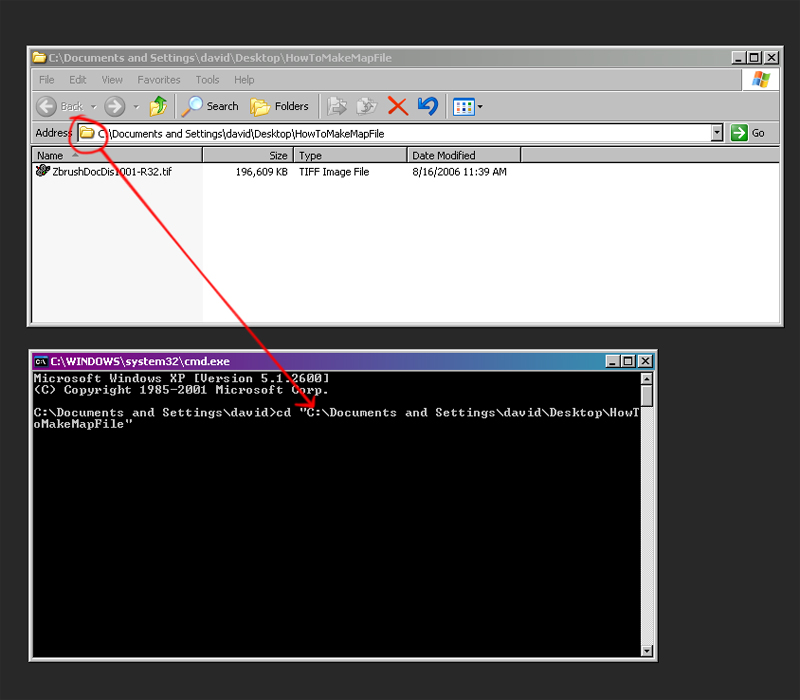

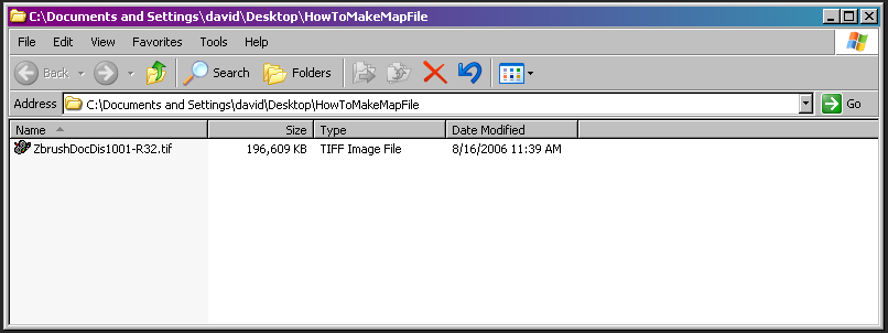

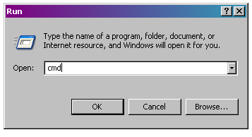

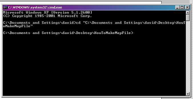

This is the long way to do it and the way that it is the Zbrush to Maya PDF.
I will do this step by step for people that haven’t used the command line before.
I have a directory with a displacement map generated from Zbrush and want to convert it to a .map file for use in MR.
Little D.
