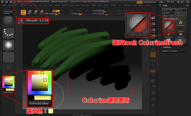

Forgive me, but are there some steps you can give to show me how it works, because everything I try with the Colorize Brush just paints things black (even the colours I see when I turn on Render>Flat) so I have no idea what the brush actually does. The Intensity Brush does the same.

everytime I use ColorizeBrush or IntensityBrush, everything turn into black, no matter whether Render>Flat is turned on or not.

In addition, I tried the colorize brush on another computer (13" MacBook Pro) but it worked wrong.
Now I consider this problem as a common problem and I hope this problem will be solved in next version of ZBrush.

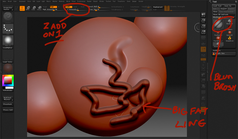

One thing I have noticed is that the BlurBrush only seems to blur colour information, but not depth information. The tool tip says it also blends depth information.
Am I missing something again?
ZAdd perhaps? :wink:
I tried that, but ZAdd with the BlurBrush just draws a big fat line instead of blurring, even on 1.
Zbrush 3.2 (Mac)
OK, I can reproduce that. I’ll pass on the information, thanks.
