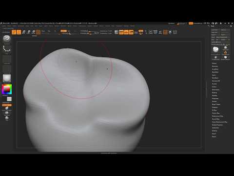

Depending on which I’m drawing on (Intuos or Cintiq), the Zadd and Zsub behaviours are reversed.
Everything works fine when I work on my main monitor using my Intuos, but as soon as I move my Zbrush over to my Cintiq Zadd turns into Zsub.
Here is a short video demonstrating the issue:

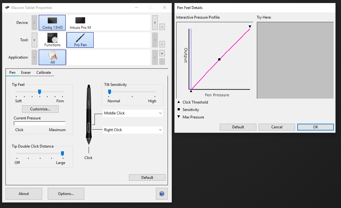

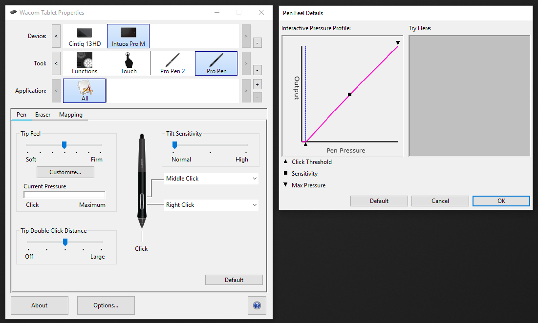

check your pen settings for each tablet in the wacom prefs.
I’ve double checked my Wacom tablet and pen settings twice now - both devices are set up identically.
Using the “Pen Feel Details” window in the Wacom settings to test the pressure levels works fine - pressure levels are not flipped there. It gets all weird in Zbrush.
