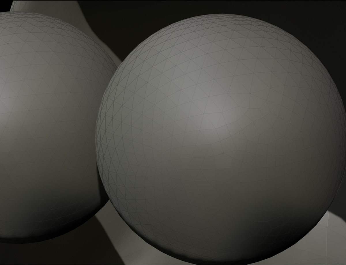

I can’t show the model publicly so this is a part of it. This is a BPR render with Smooth Normals on. I can’t get rid of this wireframe on the shaded model even if I subdivide multiple times. Again, this is model exported from Sculptris using GoZ, then remeshed.
What Material are you using? That’s probably the cause.
It’s most of the standard materials. Some are worst than others.
The one thing I can see is tri’s. No settings or other clues. Your model isn’t divided too much. Still guessing material choice.
Just did a quick test here. Had 3 spheres in Sculptris, did GoZ to ZBrush. Used ZRemesher to lower point count and then SmartDiv a couple times to get the count back up. Point count is 30,358 and its smooth with SkinShade4. :slight_smile:
Well, I can’t figure it out. The lines don’t even follow the divided mesh. It’s like a permanently painted wireframe of the original Sculptris model. I’ve been able to dial it back a bit with smoothing and tweaking the material’s crevice detection (for some reason). But it won’t go away and it’s just for this model.
I guess the answer is that there is no answer because this is an odd occurrence. I’ll just keep pickin’ away at it.
Thank you for the input, guys.
Press Render>Flat
  • if you can’t see the wireframe effect then it is due to the material you are using
  • if you can see the wireframe then it is either due to polypaint or you have a texture map applied. Either way they would need to have the wireframe ‘painted’.
The material is the most likely cause. It may be that before you subdivided the whole model was creased and that’s why the material is picking out the wireframe. Choose a material like BasicMaterial which doesn’t have any cavity detection. You can see any creasing as dotted lines beside the wireframe when you have polyframes enabled (Shift+F).
Good ideas, but I did them. I guess I shouldn’t have said “painted” but that’s what it’s like. Applying a material with no cavity detection hides it but I want cavity detection and want to figure out what the problem is with this model that causing it. Polishing the model helps, but no level of smoothing completely eliminates it. I have also imported a .obj model from Blender with the same problem.
There’s no texture map assigned is there? Did you run ZRemesher as I suggested? Or maybe Dynamesh it, exit DynaMesh, run DecimationMaster and then ZRemesher followed by dividing one of about 3 ways. Or possibly export and then import the model?
