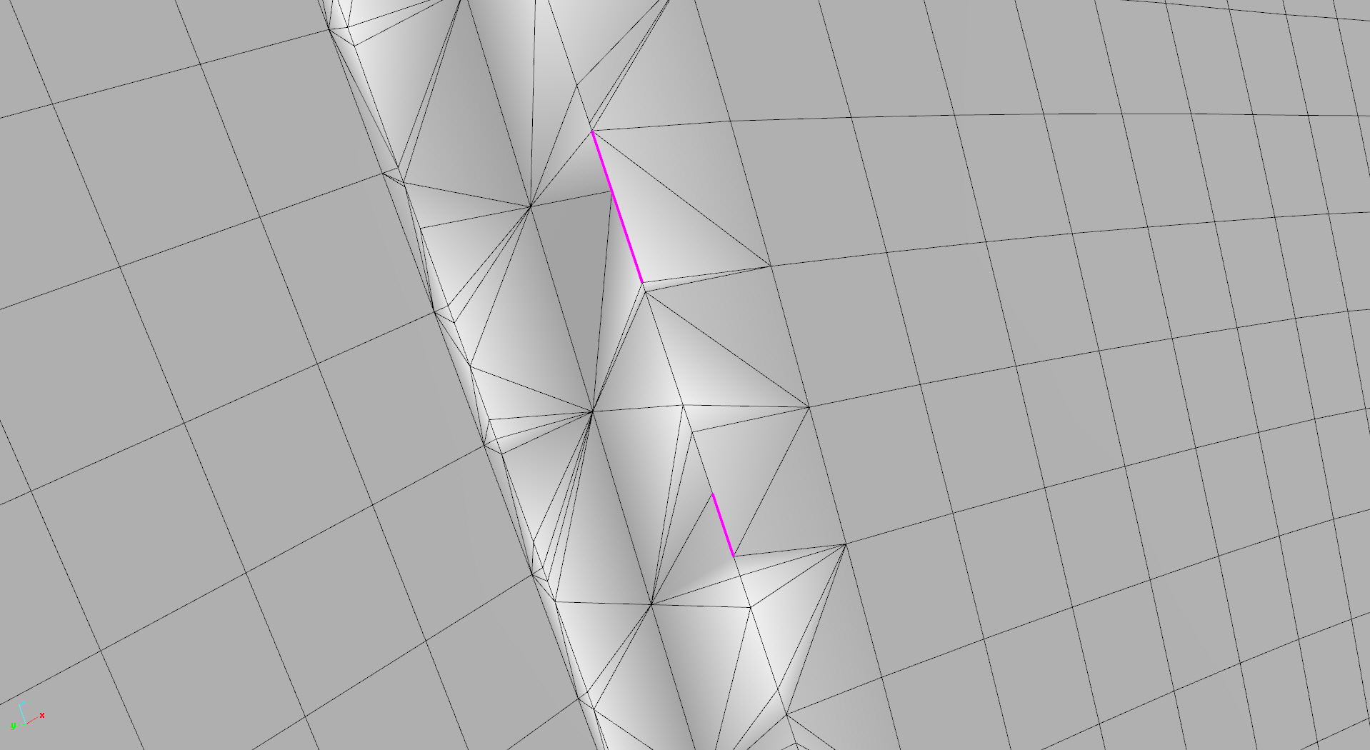

So I have been experimenting with the new 4R8 Boolean features and upon looking at some results of the Boolean joints
I saw some mesh geometry that I thought would be “bad”. See pics of a section of model ( I always thought this was bad geometry that resulted in naked edges?)
But then I brought this into another app Rhino, to take a closer look at it ( I thought maybe there were some " sliver" triangles I wasn’t seeing) and use the mesh checker in Rhino.
I didn’t find any “slivers” and oddly enough Rhino said this was a good mesh and after joining and welding there were no naked edges in the mesh?
Can some one tell me some more about this, is my understanding of what constitutes a “bad” wrong, or is type of connection valid for Boolean joints.

Ngons cannot exist in Zbrush at any time, so if a boolean operation would result in a polygon with > 4 verts, zbrush inserts geometry to force the polygons into quads and tris. Some of those resulting polygons may be very small and not immediately apparent.
This certainly results in geometry that is not suitable for sculpting, but whether it is “bad” depends on what you want to do with it. It would, for instance, be perfectly suitable for 3d print. But if you want to do further sculpting or smoothing on it, you’ll have to remesh the object into a more uniform quad flow, for instance with dynamesh or Zremesher.

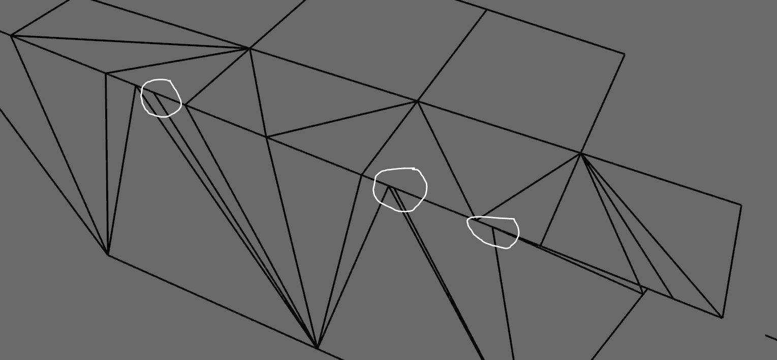

Thanks Scott,
I did not see any really small non apparent polygons when I zoomed in on the wire frame mesh in the pic on the bottom In my first post.

Zbrush booleans don’t produce meshes with “defects”, though the geometry may not be suitable for some purposes. If you look close enough at the geometry (turning on dynamic subdivision can help you see the geometry when smoothed, which may reveal things not readily apparent otherwise), you’ll see that every polygon is either a tri or a quad–even though some may be too small to see easily. Ngons cannot exist in Zbrush ever, so if there appears to be a polygon with more than 4 verts, you need to look closer.
For instance, the edges that appear darker in your original illustration? I guarantee there are actually very slender polygons there that you probably cant see unless the mesh were smoothed.

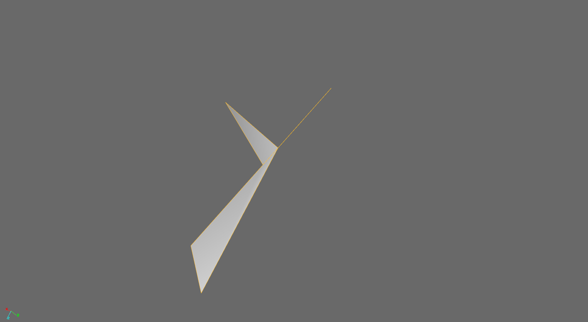

So after I did the boolean in ZB. I exported the resulting mesh to Rhino 3D, where I normally join meshes together via boolean operations.
and I used the mesh checker in Rhino and it found some naked edges and non-manifold edges.
(see Pic below of the Rhino mesh check showing a nonmanifold mesh area in violet)
So I was wondering what was the cause of this? I checked both the meshes before the boolean and the were both good, and I had no
coplaner issues.? (one of the meshes was itself a resulr of a previous boolean operation) I am trying to figure out whats going on and how to best boolean in Zbrush.

Next time, switch on dynamic subdivision on your freshly booleaned object in zbrush. It will reveal anything like an unwelded point in the form of a hole in the mesh, and reveal any polygons too slender to detect with the naked eye. There are mesh errors that can crop up, and zbrush has its own fix for these (tool> Geometry > mesh integrity > check/fix mesh).
I’m skeptical that the boolean process is generating unwelded geometry–much more likely that it’s just generating awkward geometry and points are becoming unwelded as part of the import/export process between programs, which is not unheard of–but my experience with Live Booleans is as new as anyone else’s right now, so who knows.
There are however settings in Preferences> Boolean that determine the threshold for dealing with things like co planer faces and slivers, if you think that might be applicable to your situation.

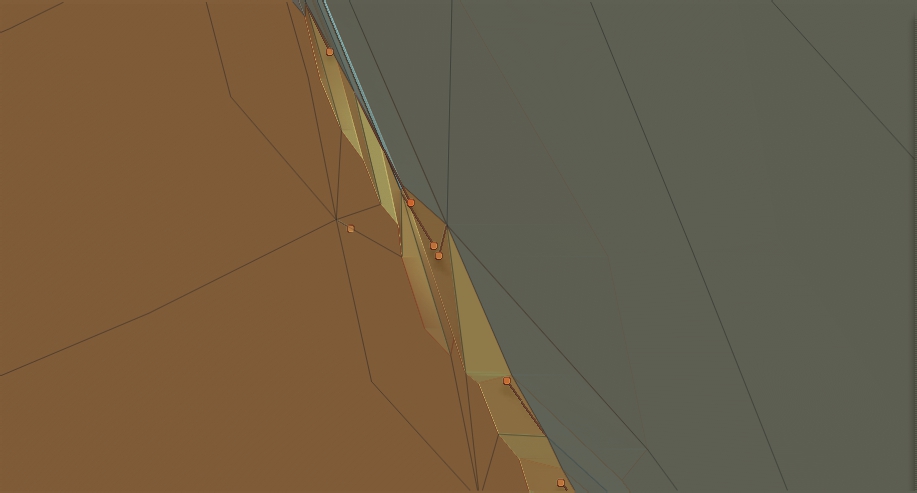

I tried to adjust the boolean preferences for slivers. It eliminated some of the non manifold type of geometry situations.
But I don’t know why but the ZB. boolean algorithm is giving me results like this at areas where there are 90 degree joints.
In this tiny part of the booleaned mesh, the line in the pic below is actually a mesh face.

“Next time, switch on dynamic subdivision on your freshly booleaned object in zbrush”
I tried that and here is what it shows in the problem area
I guess those dots represent sort of a floating vertices at the end of a sliver?
Just wondering why I an not getting a good result on a seemingly straight foward boolean in ZB that works fine in Rhino 3D?
But I can say that ZB obviously has no problem working with this type of boolean result , because I can use remesher no problem and then its all cleaned up. I just would prefer not to have to remesh everything before sending to 3d print.
