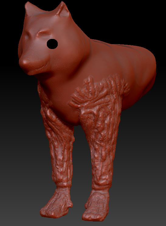

I don’t know what I am pressing to cause this but for some reason randomly while I’m modelling the camera kind of locks the zoom to a location
Example I’m making the foot of a character and I try to zoom in then for some reason it zooms in Towards the head which is making it very very hard to sculpt due to camera rotation/zoom going around the head and not changing position as I move the camera… How do I fix this? Really need help

The thing is normally when you are moving the camera it will rotate from the centre of the mouse, so if I right click the foot and zoom in then it will fly to that, if I right click the head and zoom in it goes to that but mine doesn’t no matter where I click it always zooms into the head, the camera basically has like a pivot on the head and I can’t stop my entire project from moving around it, trying to do fine details while it flies off instead of circling the foot is very hard

I took a screenshot and painted a circle on it to try and explain it
See I use Ctrl + Right click to zoom in and it normally goes into where my mouse location is, so when my mouse is on foot it should zoom on the foot but you see the black circle? No matter where I am it zooms into that and rotates around that black dot making navigating really hard

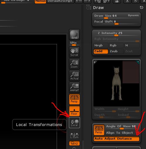

The effect you’re describing is because the Local button is on. (In the Transform palette or the right-hand side of the standard interface.) This centers the transforms such as rotation and zoom on the last portion of the mesh that was edited (touched with the cursor). Local transformations is on by default - if you don’t want it just turn it off.
Note: the Local button also affects perspective. In order to get the same perspective distortion when Local is off you need to turn on Draw>Auto Adjust Distance.
Thanks for the info marcus, It actually turns out the issue was that Local was not turned on, I assume that is what u meant…? Anyway thanks! I can get back to working on my model now
