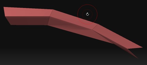

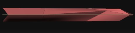

I am regularly having problems with symmetry in ZB3 on retopologised meshes.
Here’s an example.
Import the attached OBJ (zipped - exported from ZB3) into ZB3.
Rotate until the top of the head is visible. You’ll see bad sym’ there:
[BadSym.jpg]
Use ‘Smart Resym’ in ZB3. Nothing gets fixed.
Now, import the same obj into ZB2 and hit ‘Smart Resym’.
The mesh is corrected to full symmetry.
G.

I would have fixed those points (welded em) before importing, I took a look at the OBJ and those mad non-planar quads on the top of the head are not really needed and definately dont follow the edge flow…see below pic, I hope this helps a bit :+1:
EDIT: just noticed you said “retopologised meshes” but the same thing applies, delete some of the points and make you mesh flow with quads as shown??

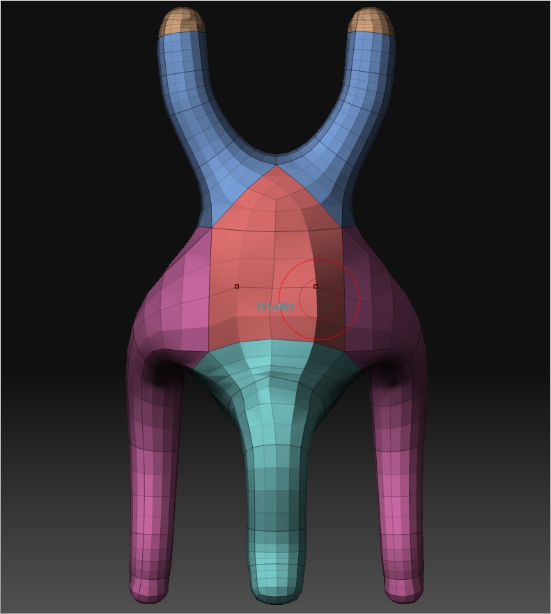

OK. Much simpler example. No retopo’ or anything
Basic ZSphere ‘alien’. modelled with symm turned on.
Polymesh created, symm turned back on and some very basic editing done.
I notice some messed up symm on the back.
Hit ‘Smart Resym’. ZB3.1 reports ‘Full symmetry Found’ But look at it…
[BadSym2.jpg]
I try ‘Unify’ and ‘Smart Resym’ again. No dice.
Export as OBJ, import to ZB2. Hit ‘Smart Resym’…Bingo! All fixed.
G.

In 3.1, Smart ReSym works best if you mask the good part of the model.
Yep. Masking one side and clicking smart resym works OK.
Unmasking and using resym again still works with no bad results.
(I guess my export/UV-unwrap/import somehow ‘bent’ the mesh. I’ll
try and figure out where.)
Thanks. I’ll remember the mask thing in future.
