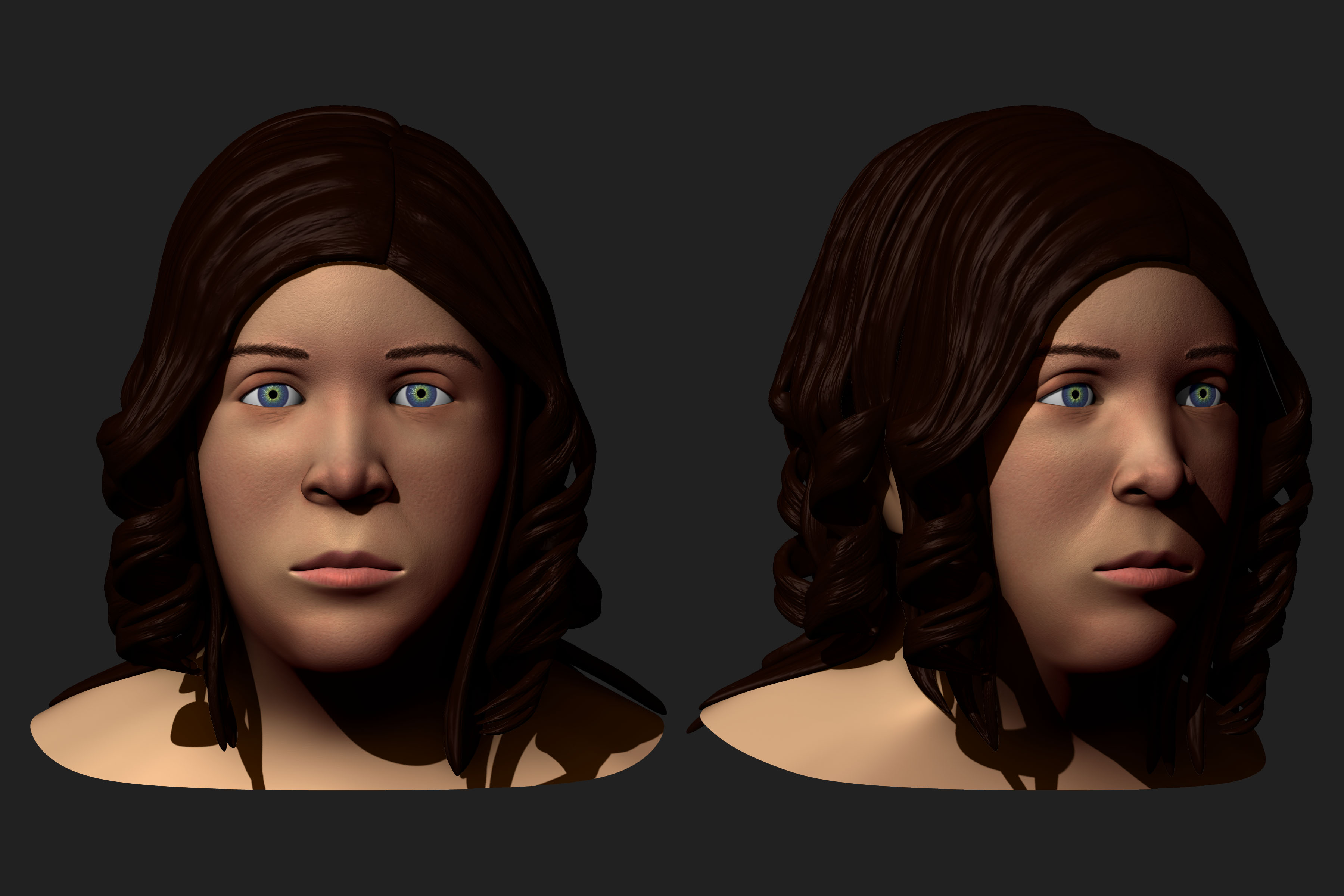

Okay, so here’s the finished head…

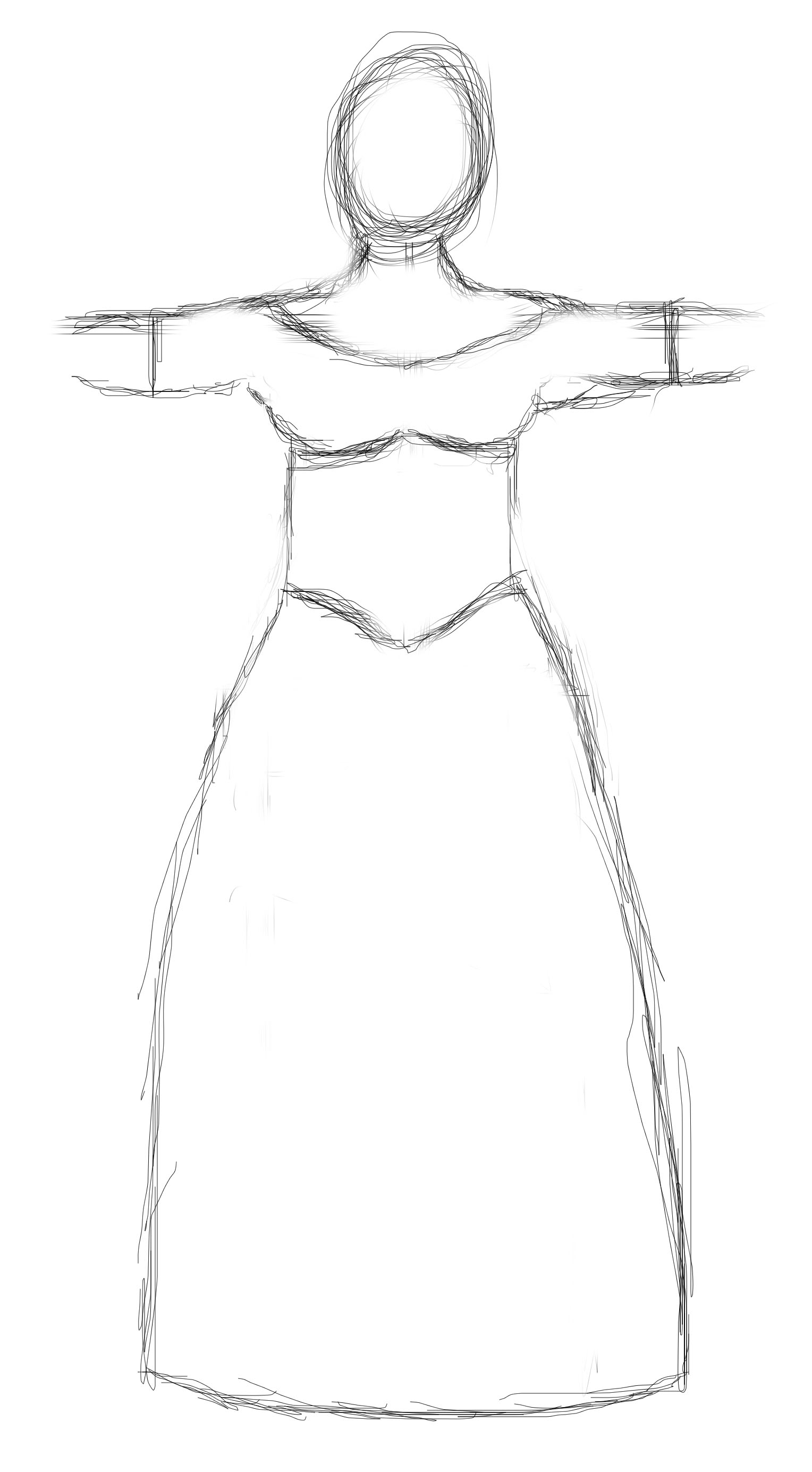

And here’s a quick sketch of the clothing I wanted to do. Basically, just some simple renaissance clothing.
But when I modeled the neck, I just did it to vaguely indicate that it isn’t a floating head. Now, it needs to actually come down and look like a proper neck, and somehow look like it goes under the clothes. I thought that maybe the best way to do this would be to use ZSpheres to make the body, attach the head to it, and then use my standard brush to pull the clothing shape out from the body, rather than having everything be a separate piece. I’m not sure if that makes sense, or if that’s the best way to do things.
I also don’t really know about the legs. I want there to be boots that you can see under the skirt, and I want to be able to model this character in a T/A pose, and then actually rig and pose this character later. So do I model legs under the skirt? Or do I leave them out, since you can’t see them anyways?
You only need to extend a bit the neck. If you want a quick work you could even simply extend a bit the geometry moving it. Currently it is a flat color and I don’t think any stretch would be visible.
If you more geometry and stretch is not enough it depends of the current status of your geometry. That model looks polypainted. That won’t be lost, I think. If you have subdivisions you could freeze the subdivisions, extend the model with zmodeler and unfreeze. If the polypaint has been affected you could keep a copy a re project the polypaint. Some extra modeling will be needed to smooth the new geometry.
If I’m modeling it I certainly would not connect the head to a full body. Leave the clothing disguise any seam. You could use the geometry of a body as reference for volume and proportions.
