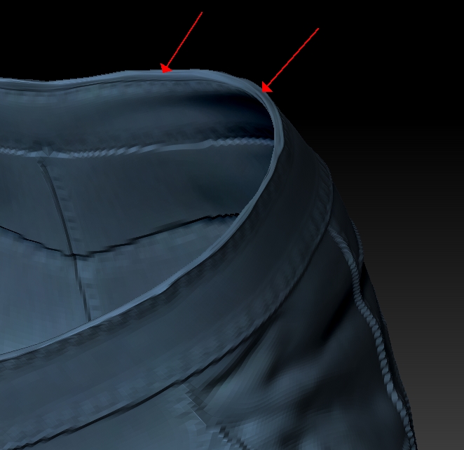

Which brush is best for relaxing faces that are close to each other.
Like when you for example extract geometry (pants on character) and where the belt are is I want to relax the polys (border) that are connecting outside part and inside part of pants. here I want to get rid of those sharp edges:
I am curious about what other people use as well. My typical work around is just to make the extraction really thick on the inside. Another method I use, if the extraction polygroups are really clean, is just using the regular smooth brush with the automask settings “Mask by Polygroups” and “Backfacing” on.
Smooth Valence with a lowered strength?
