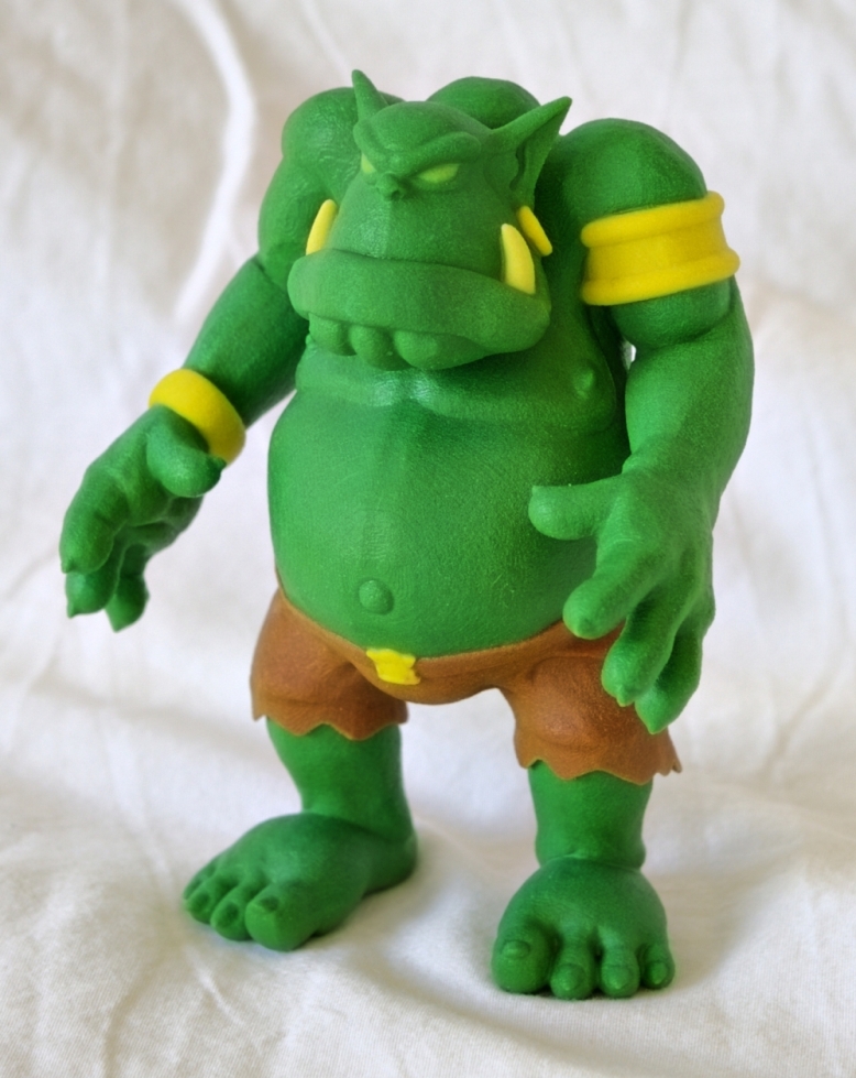

You might consider the 3DP (Z-Corp) product as with a 10"x16"x8" build size and a 0.0035" step size, a little surface prep goes a long way.
Also, the plaster like surface takes paint/primer very well. True the roughness may be an issue, but it may also be just the texture you want. Lightly sanded it can become very smooth.
We’ve been working with one for a couple of years now and have gotten results that look even better than the manufacturer’s demo parts.
