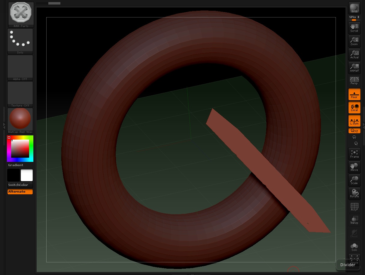

all my IMM brushes are suddenly squashed flat on insert!?!?!?!?! Please help
I was having a great kit-bashing session and I accidentally clicked or typed the wrong command I guess, because all my Insert Multi Mesh brushes are inserting perfectly flat objects.
It seems like the are scaled down on one axis completely. I can’t figure out how to undo this snafu.

Apparently it may be the Zintensity which applies a squash to the IMM brushes. or the Pressure setting under stroke.

This happens after moving the brush around so it can stretch and such, but after a while it’s all flattened into a pancake and even resetting the brush is not a fix.

(cliff notes: hit CTRL to set the size of the inserted mesh to your brush size; will also reset proportions of the inserted mesh)
As far as I can tell, if I set ZIntensity to 100 my IMM stops from beeing squashed
