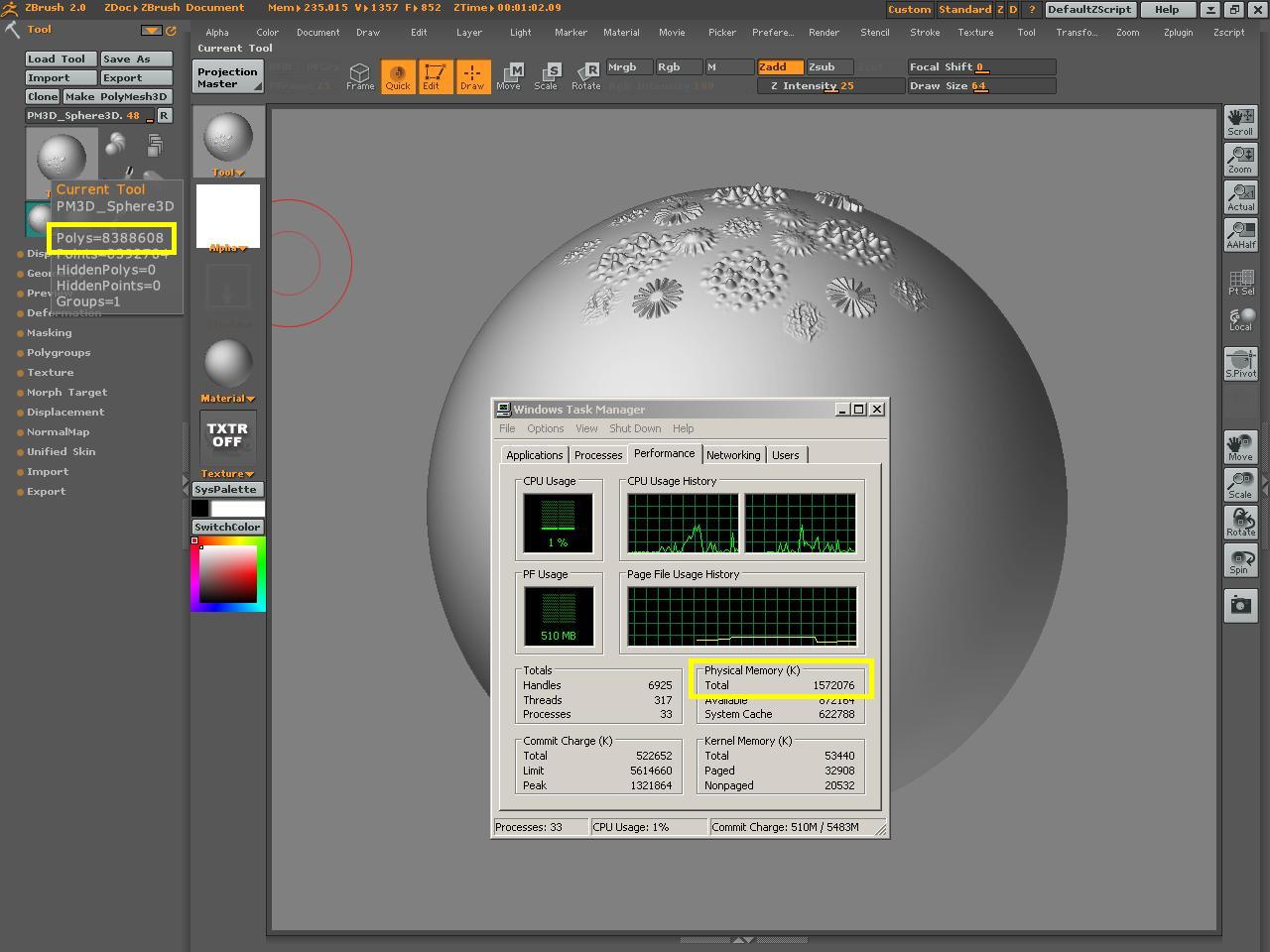

Hitting 8 million polys with 1.5 gb DDRam no problem.
Did this only by shutting down other apps, turning off memory optimizing program (rambooster), and setting COMPACT MEM to 4096.
Model still handles well with good speed.
Comp stats: p4 2.8 @ 3.4ghz, 1.5gb DDR500 @ 240mhz
Hi beeek,
With 1.5 GB of RAM you should NEVER set Compact Mem to higher than 1536. A setting of 1200 is better so that enough RAM is left over for your OS as well.
Compact Mem tells ZBrush what point it should stop writing to RAM and start writing to disk. When you set the value higher than the available RAM in your system, you have set a value that ZBrush cannot reach. Because it cannot reach that value, it never writes to disk – even when it really needs to.
It’s great that you’re able to hit 8 million polygons and still get good performance, but you have to admit that you’re taking some extraordinary measures to do this. :wink: That’s why we state that MaxPolysPerMesh should never be set to more than double the default value (which is determined by ZBrush based on your available RAM). Depending on the user and the computer, you MAY be able to go higher than that, but doing so is always a risk. Performance will almost always suffer, and you also risk getting into a situation where the computer can’t save your work or just plain crashes.
Please see the FAQ>General section here at ZBC. The Performance Tips entry will help you get your settings under control so that ZBrush can perform better. (And believe me, setting Compact Mem to 4096 is hurting your performance; not helping it.)
Aurick:
Thanks for the suggestion, program is considerably more responsive and compacts more quickly and less frequently with COMPACT MEM set to about 1GB (the amount actually available to ZB on my system).
beeek :+1:
