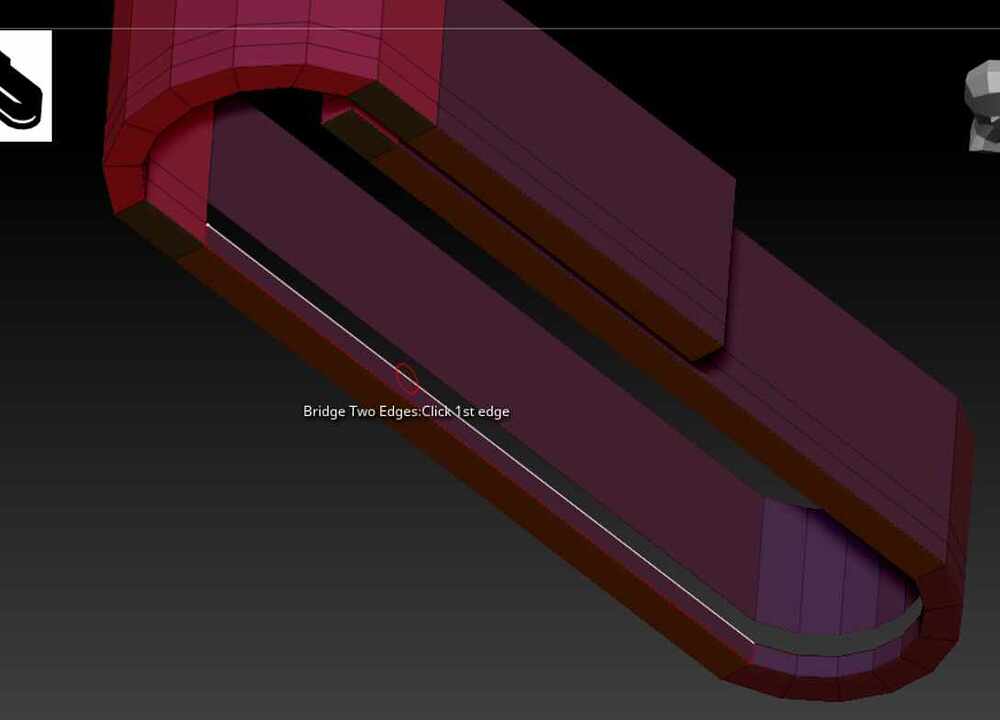

I’ve a very simple Tool that I just want to bridge 2 opposing edges (one of the simplest commands in every poly modeling app) but nothing happens, an error message, a crash, nothing. If a delete some random quad and attempt to bridge it, same result.
I’ve also tried some other intuitive commands like close hole or extrude, but they’ll produce a mess of topology or won’t snap to the opposing edges.
What’s going on, can anybody help of has a better solution to reconstruct faces?

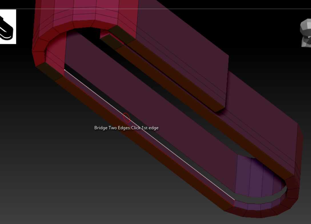

Okay so I’m actually just doing this tutorial right now as I’m writing this message out. What I did was click on delete hidden under modify topology, and then that seemed to fix the issue. Bridge edges worked fine for me after doing that. My assumption is that there are faces being made once you bridge the edges but it doesn’t show or is hidden for some reason.

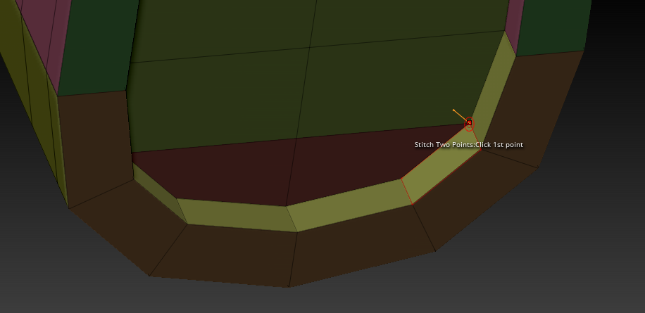

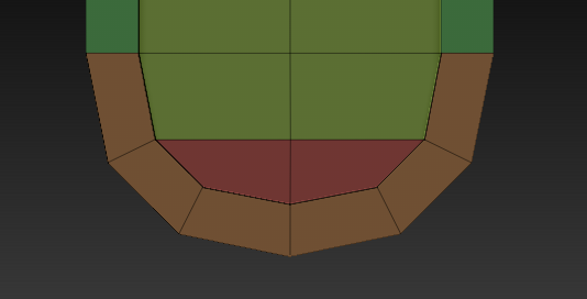

On another note, there was another issue of where in this section, there were edges running along as shown below: image
When deleting the slanted edges in order to make quad faces, it would end up deleting the face entirely. I found out that you had to stitch the points accordingly along the edge-loop of where my cursor is:
My guess is because they’re not stitched, the face is treated as being separate from the edge-loop of where my cursor is located, and thus upon deleting the slanted edges, treats it as not being attached to the rest of the pouch.
