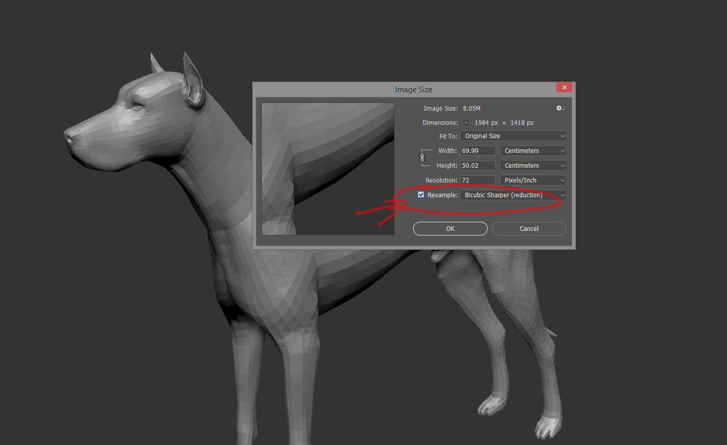

Is it possible to change the export document resolution settings of the PSD files form the current 72 DPI to 300DPI?
I realise most of the work is for digital/screen use but I would also like to print out some of what I’m producing and scaling up in PS is ok but they never print as well as when they are initially at higher res.

You don’t have to scale up or resample in Photoshop. All you need do is set 300 pixels per inch in the image size box, but don’t alter the actual pixel dimensios of the image, ie make sure the “resample” box isn’t ticked. You can also set 300ppi as the default viewing in PS preferences.
In ZBrushCore you are limited to the size of your screen, so on a larger resolution monitor you’ll get a bigger image. And that will determine the pixel dimensions of the image you can export. There’s no way to change that, so it will limit the size of printed image (if you change the dpi to 300 in Photoshop without resampling).

You’re misunderstanding dpi. What matters with an image is the pixel dimensions, the dpi just tells the output device - such as a screen or printer - what size to display the image.
When you change the dpi for an image in Photoshop you have two options: to use resampling or to not use resampling. If you use resampling then Photoshop does as you describe; it increases (or decreases) the pixel dimensions. This can lead to the image degrading.
The alternative is to not use resampling which is what both dillster and I are talking about. The image quality remains the same, as the pixel dimensions aren’t changed, but for higher dpi the image will appear smaller.
An image of 50 x 30 cm at 72 dpi will have pixel dimensions of about 1416 x 850. This same image could be printed at 300 dpi which would give an image of about 12 x 7.2 cm.
