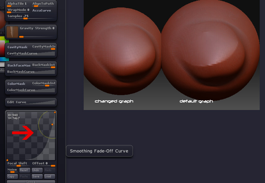

Set the graph like this :>
[smooth.jpg](javascript:zb_insimg(‘65409’,‘smooth.jpg’,1,0))
Hi,
what works for me is: choose the smooth brush,then set the smoothing
curve to something like shown above,lower the z-intensity (the sm br
should be chosen for that,if you do it with another brush chosen
and holding down shift you just lower it for the chosen brush not
for the sm br as far as i know) to 50 or so,then choose your sculpting
brush again now you should get the desired effect when you press and hold
shift for smoothing(in case z-add is on,that is).
Hope it´s not too confusing.:wink:

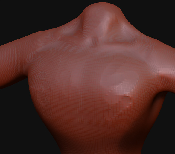

Thanks for the offered solutions. I tried all:
  • lowered intensity, but I really think smooth should also work with a high intensity
  • changed the curve in many formes
  • changed the ‘brush modifier’
  • changed from no alpha to a round alpha,
but nothing seems to work. I still get those strange flattening marks. This is how it looks:
[smootherror.jpg](javascript:zb_insimg(‘65416’,‘smootherror.jpg’,1,0))
It’s quite depressing. I never had to think about smoothbrush, it always did just what it should do. I hate whining, but… :cry:

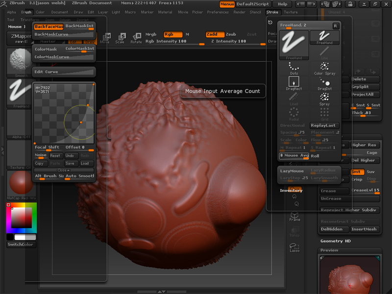

Ok i think I got it try this
Goto the smooth brush and under stroke turn up the mouse average all the way to 8
and setup you curve like this under smooth curve
wow you can even set the focal shift for the smooth brush and it works!
set the focal shift to -100 and try smoothing, it smooths with a very minimal dropoff.
