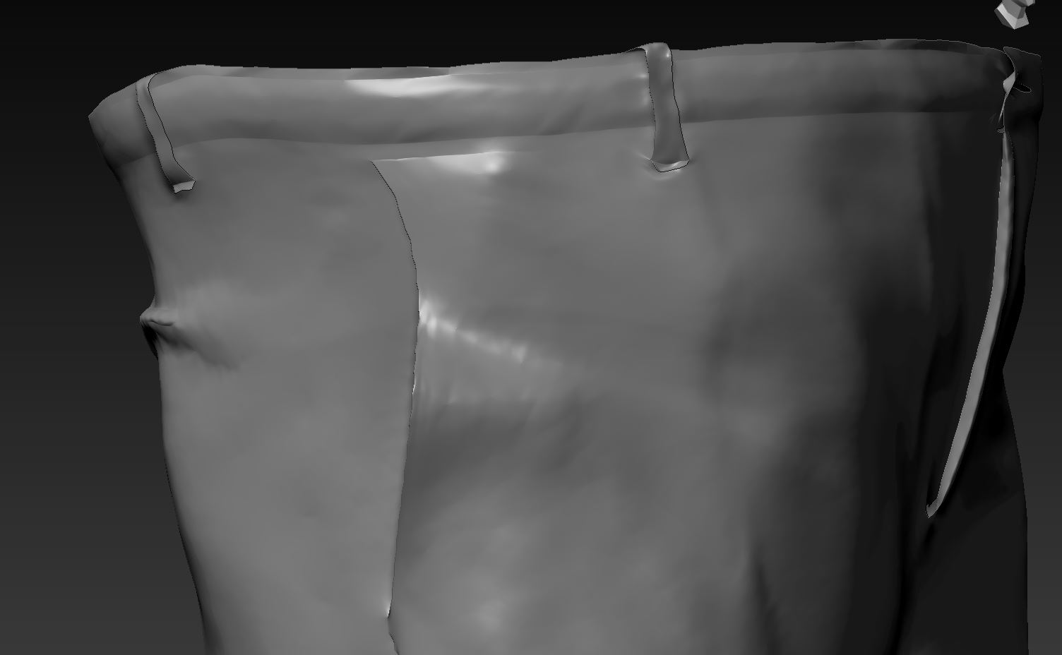

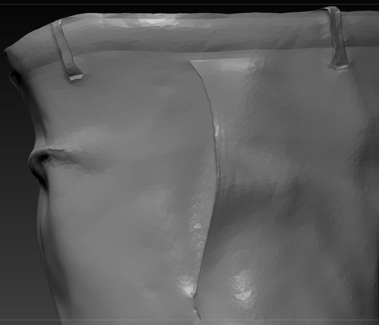

I have trousers exported from Marvelous Designer.
Because they haven’t any thickness like I am used to have in zBrush, they are a bit hard to sculpt realistically.
Is there a recommended workflow?
Attached some screenshots.
Thanks for any tips on this
this%20geometry%20trousers

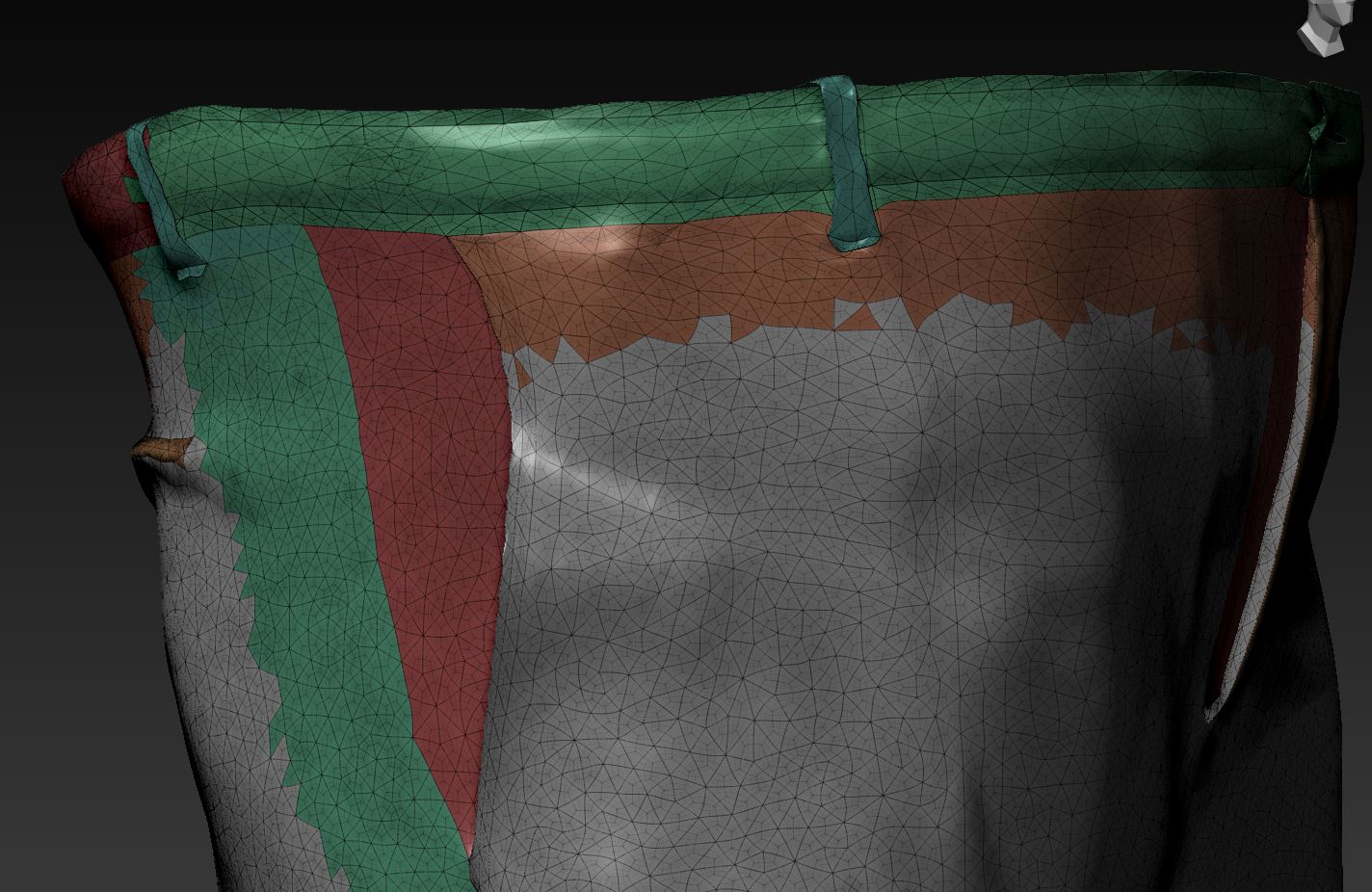

I am slightly concerned about the way the belt loops are joined to the mesh–this may produce odd results in that location, but we’ll hope for the best.
Next you ideally want to clean up that topology for best results. A quick ZRemesher pass should do the trick. Your only goal here is to get topology adequate for sculpting. There’s not a lot of detail on your garment yet, so a medium-ish target polycount setting should be sufficient. You may need to then further subdivide the mesh to increase its resolution high enough for fine detail.
