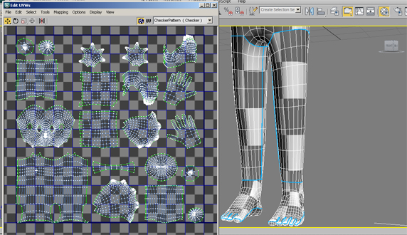

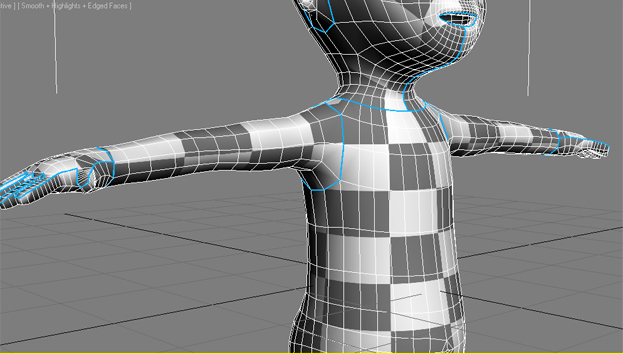

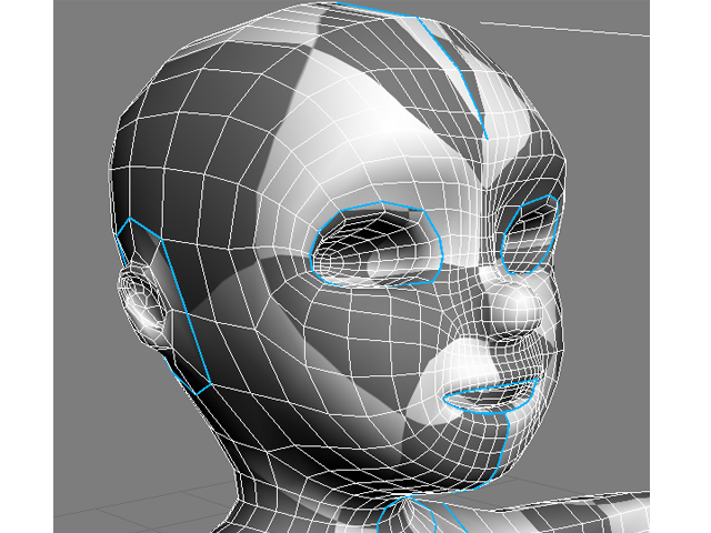

I have a character that I’m trying to unwrap in max2010 using the pelt map feature, but its not going so well. Is there any tutorials on the proper placement of seams when unwrapping a human? I have tried over and over with different variations of seam placements and can not get a good checker pattern reading. I’m getting so frustrated I feel like giving up.:confused: But I’m not a quitter and want to beat this burden, but I need help. Any help, pictures or links would be greatly appreciated.
Attached Is my most recent failure. :rolleyes: It was a done with a combo of pelt mapping and cylindrical mapping. Please Help.

For a human form, I use pelt mapping through out, but I do it separate groups. (I use Modo to do UV mapping work, so I just discuss generalities here.)
I cut off the head, hands, and feet and do each of these separately. For the head, I tend to have a cut along the hairline and down the back. For hands I usually cut them laterally so that palms and backs are two separate islands. These flatten nicely. For feet, I cut off the soles in a loop and then slit the tops up the back along what is the Achilles tendon.
For the remaining headless, handless, and footless body, I cut along the sides so that it splits into front and back. This means there is a seam that runs from the ankle right up the outside of the leg along the side of the torso, under the armpit down to the wrist; another two seams runs along the neck and down the arms on each side; and a fourth seam runs up the inside of each leg and under the crotch. This splits the body into front-back pieces.
There are other ways of doing this, of course, but as general method, it should give you relatively flat, low-distortion meshes which are relatively easy work with in an image editor.
