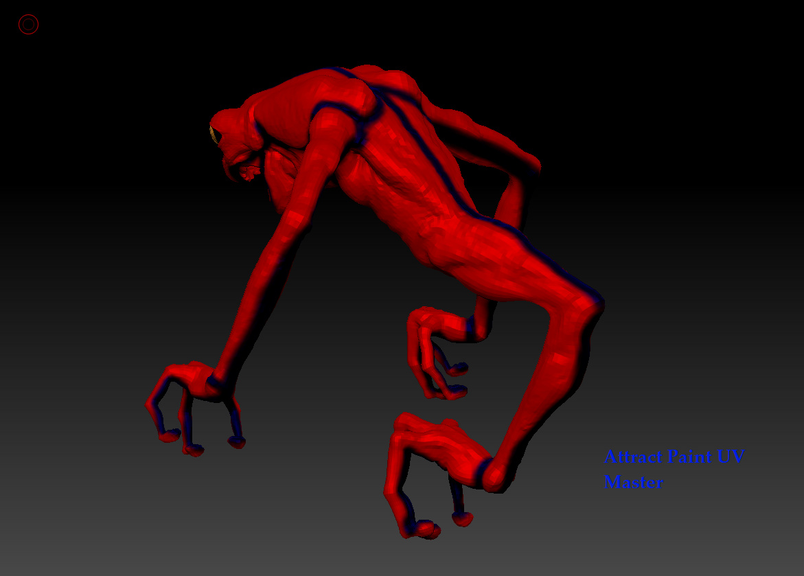

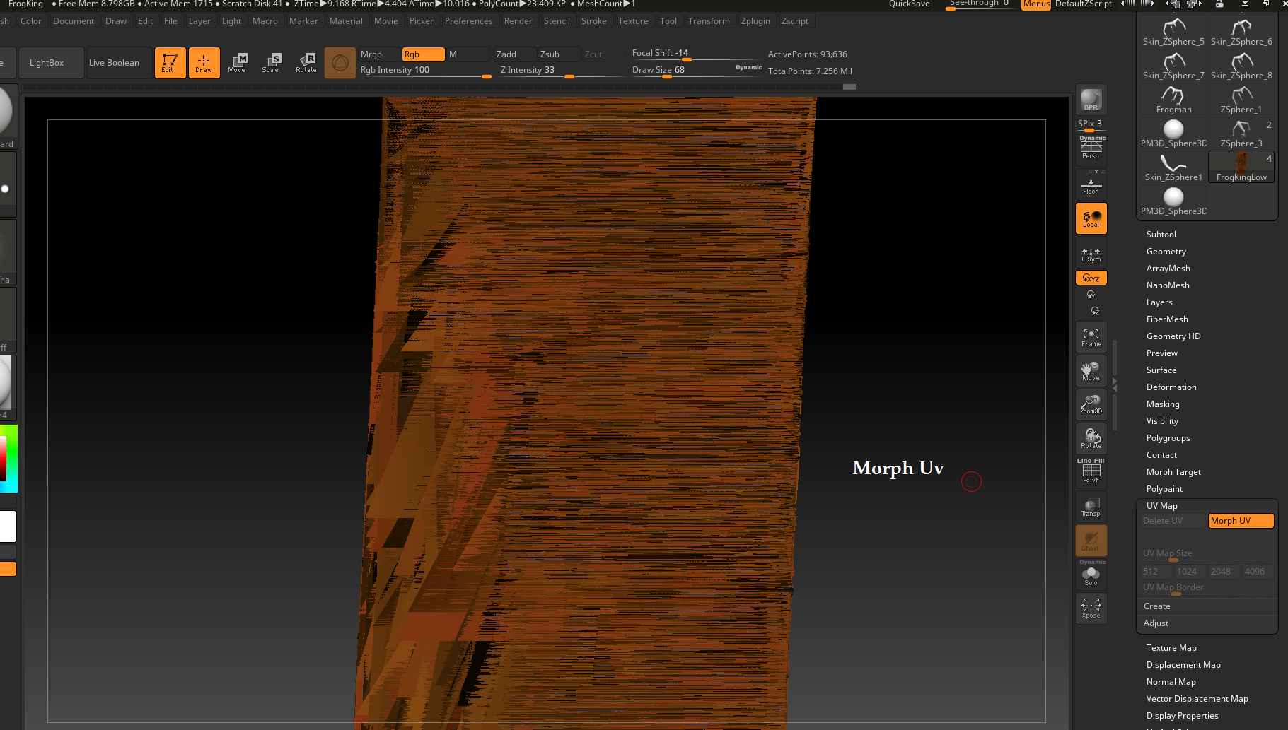

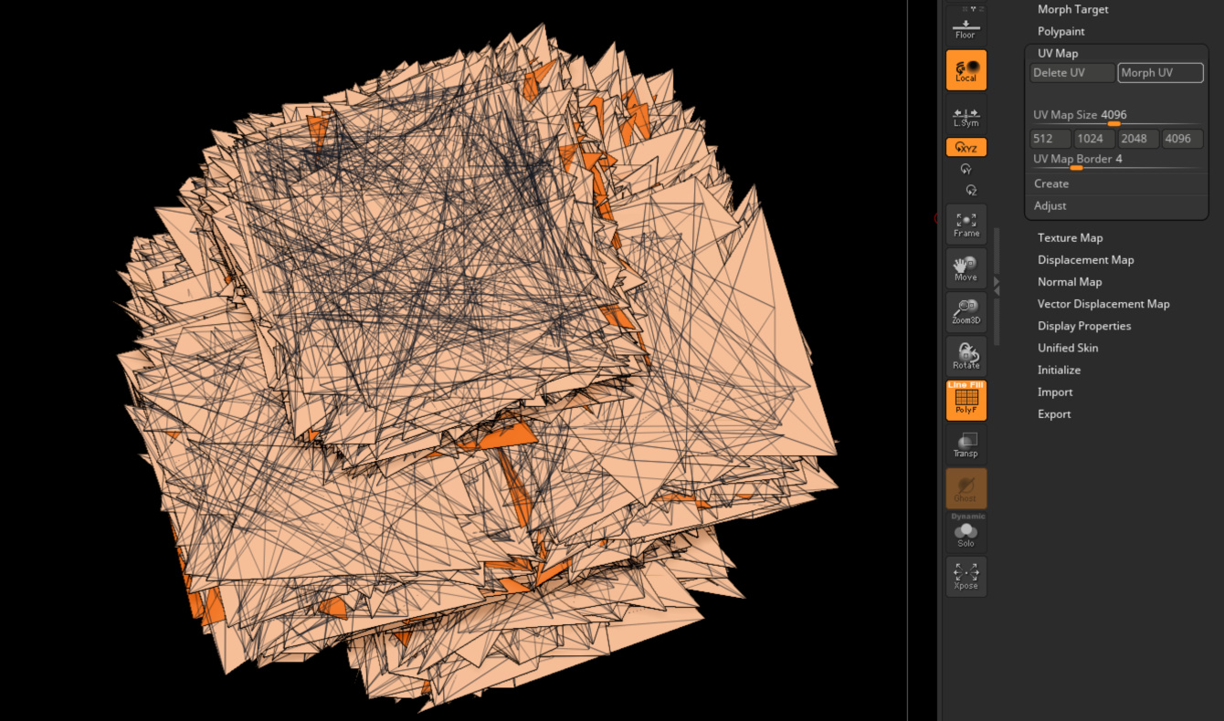

I have been using ZBrush for about 2 months now and it is awesome, I have made many models with no problems so far. I have just finished one and I duplicated it and Remeshed it to a lower count to use in Xnormal. I am trying to unwrap it using the uv master plugin. I use control painting to attract seams and protect the rest but after i hit unrwap and then morph uv to view the unwrap it breaks up into thousands of polygons that are just overlapping each other. I dont know if ive turn something on or off to cause this but im at qute a stand still strying to figure out why ? any suggestions would be appreciated. Thank you.uvs.jpg

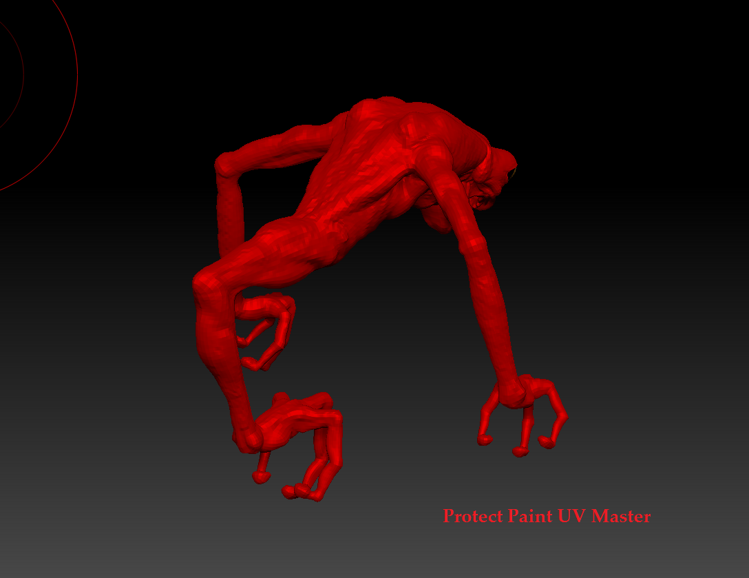

  1. Protect painting with UV Master
  2. Attract painting with UV Master

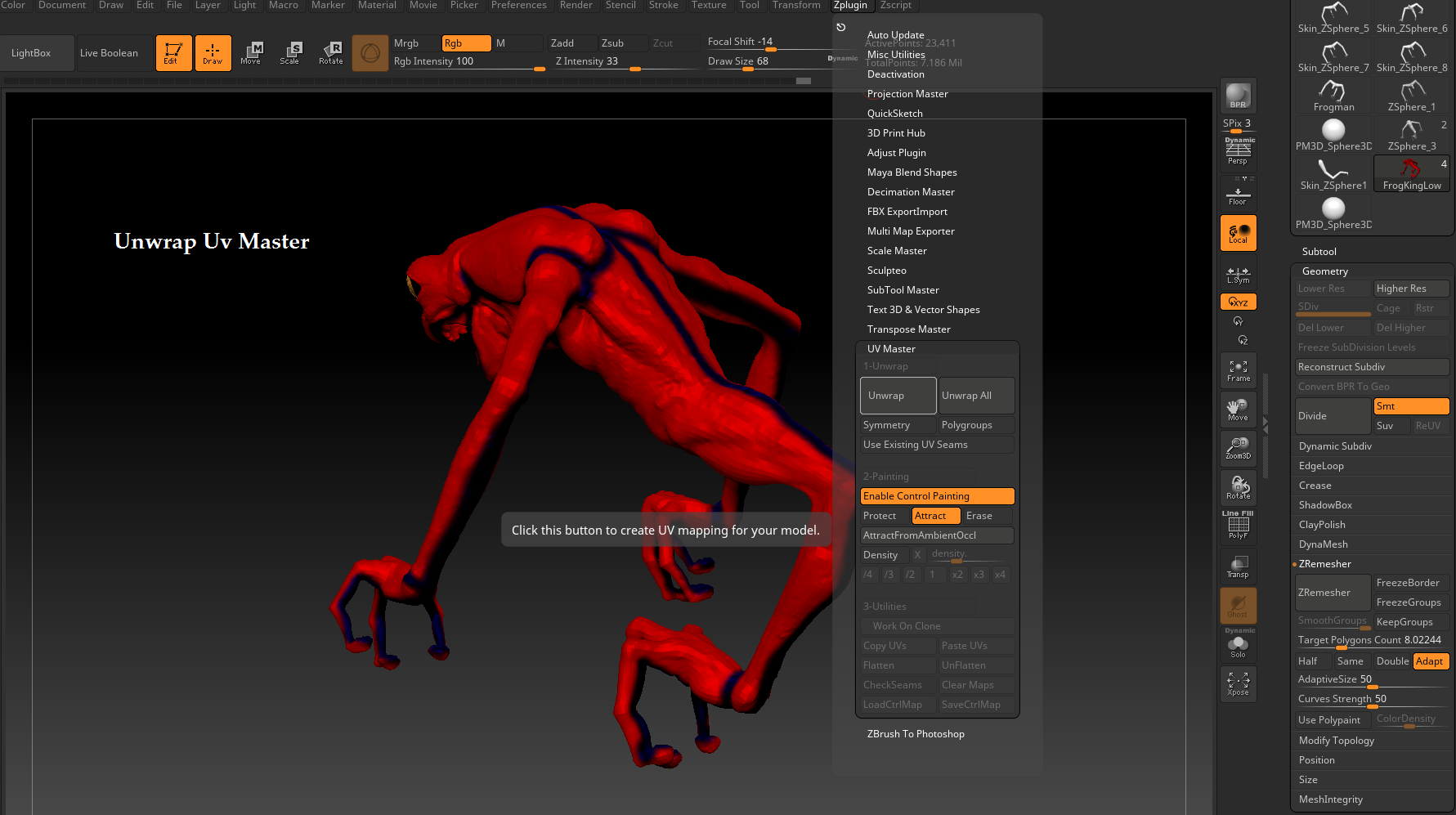

  3. Unrwap with UV Master

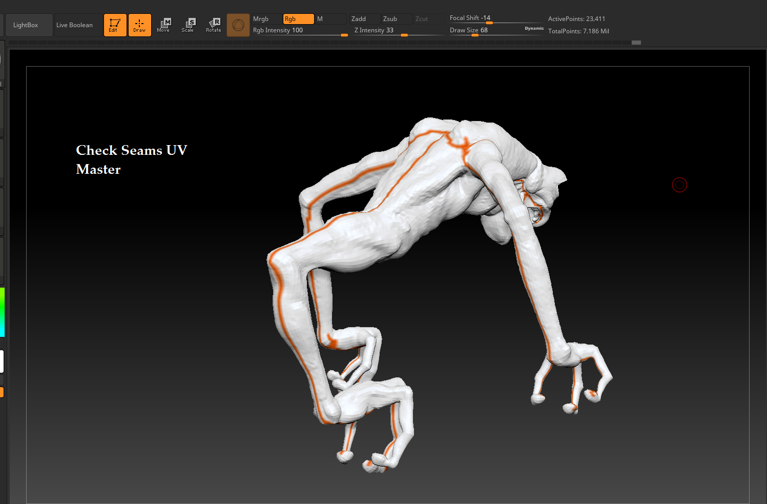

  4. Check seams with UV master
  5. Morph UV at UV Tab
you’re protecting the whole mesh? Try turning off all color info and see if that unwraps correctly. Also, don’t use morph uvs in UV tab. Use flatten in UVMaster to check your UVs first.
