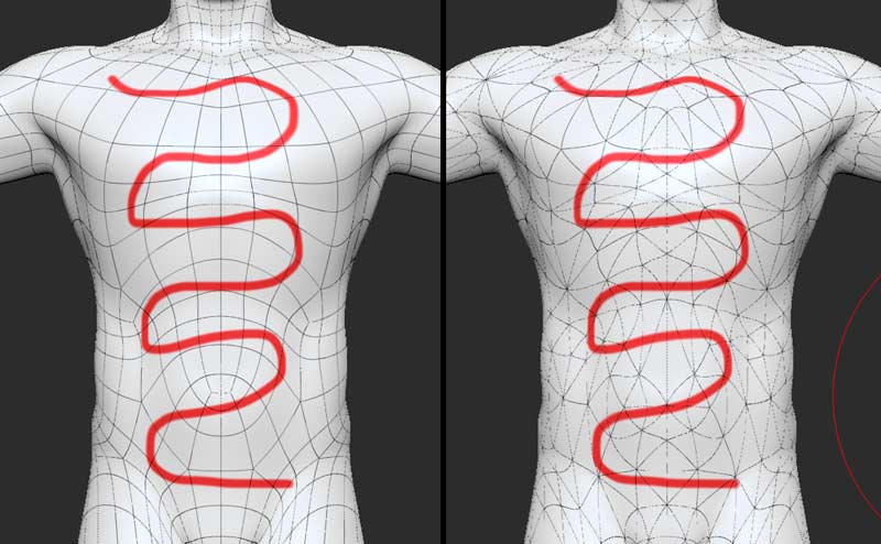

As far as the target mesh with tris.You might be surprised the quality of paint you can get on a mesh with tris if you throw enough polygons at it. Tris don’t sculpt well under any circumstances, but you can often subdivide them enough to get a good color transfer. I do this with decimated meshes a lot. If the tris are wildly stretched and distorted, you may not be able to do much with it, but that would be true of quads as well. If the tris are reasonably well distributed, you can work with it. It would require high levels of subdivision, but you only need those to catch the color and then generate a texture for the low poly mesh.
You can see me going from quads to tris below, with no noticeable lose of detail or crispness:
