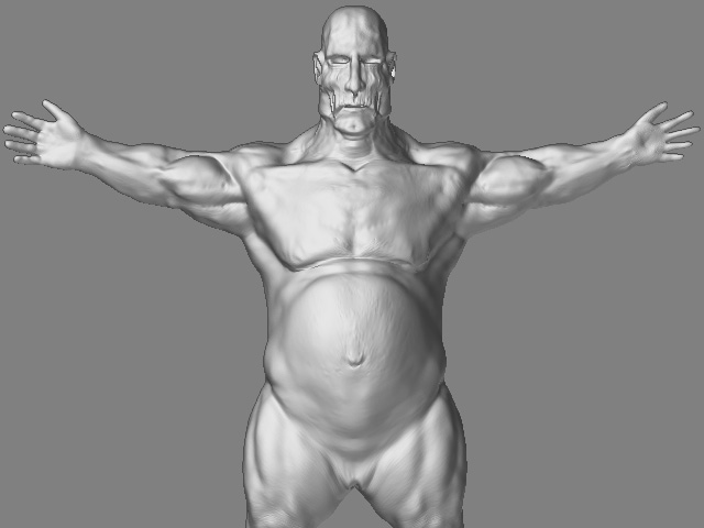

sorry to say. But I tryed jeje’s exact way but it still explodes my mesh into harmful and nasty spikes. Heres a picture. I wanted his right hand to be smart resym’ed onto his left. But I just have to go sad to bed :evil:
couldnt make it work even though i did everything jeje suggested.
Heres a pic of my dude.
His right hand is supposed to be smart resym’ed to his left.
But it just gives me vertices hell.
Very sorry Jais, i’ve no more tip for this specific problem…
hmmm… the initial mesh of your work comes from another soft, or you did it in zspheres ?
sometimes, very little mesh don’t respond to symmetry, you can try to export your mesh in obj, import it in max or maya, and reexport it, changing the scale ratio (x1000 for example) and reimport in zbrush, and try a smart resym… perhaps it will help you, but i’m not really sure…
tell me informed, we will finish to find a way !

I tried to do resym and then also smart resym up through the divisions.
It still wasnt too good, but I didnt have vertices flying all over so now I can work from there.
