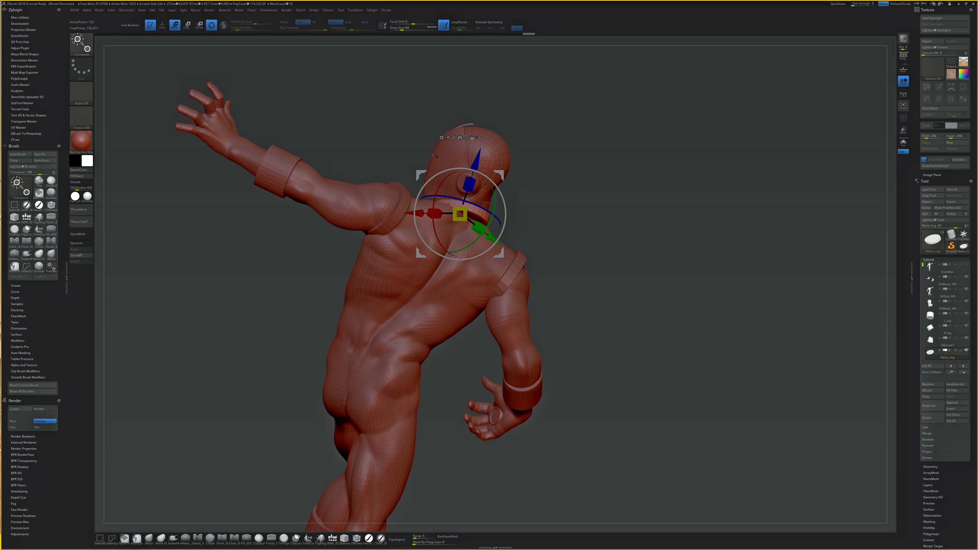

Still visible:

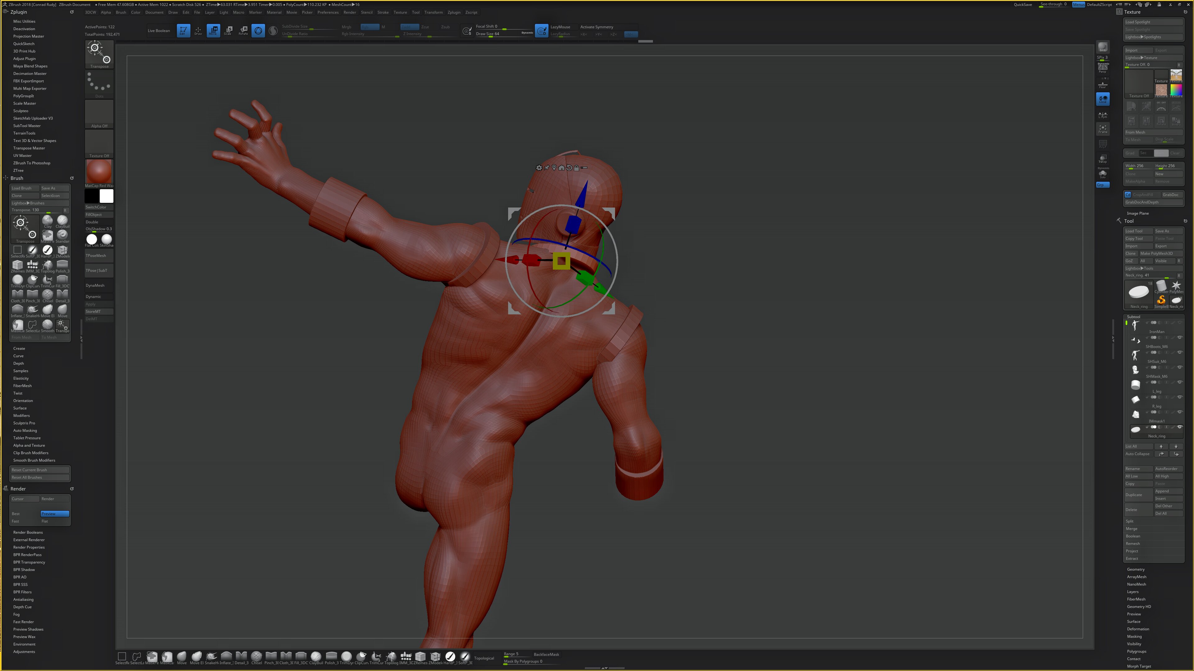

One degree more:

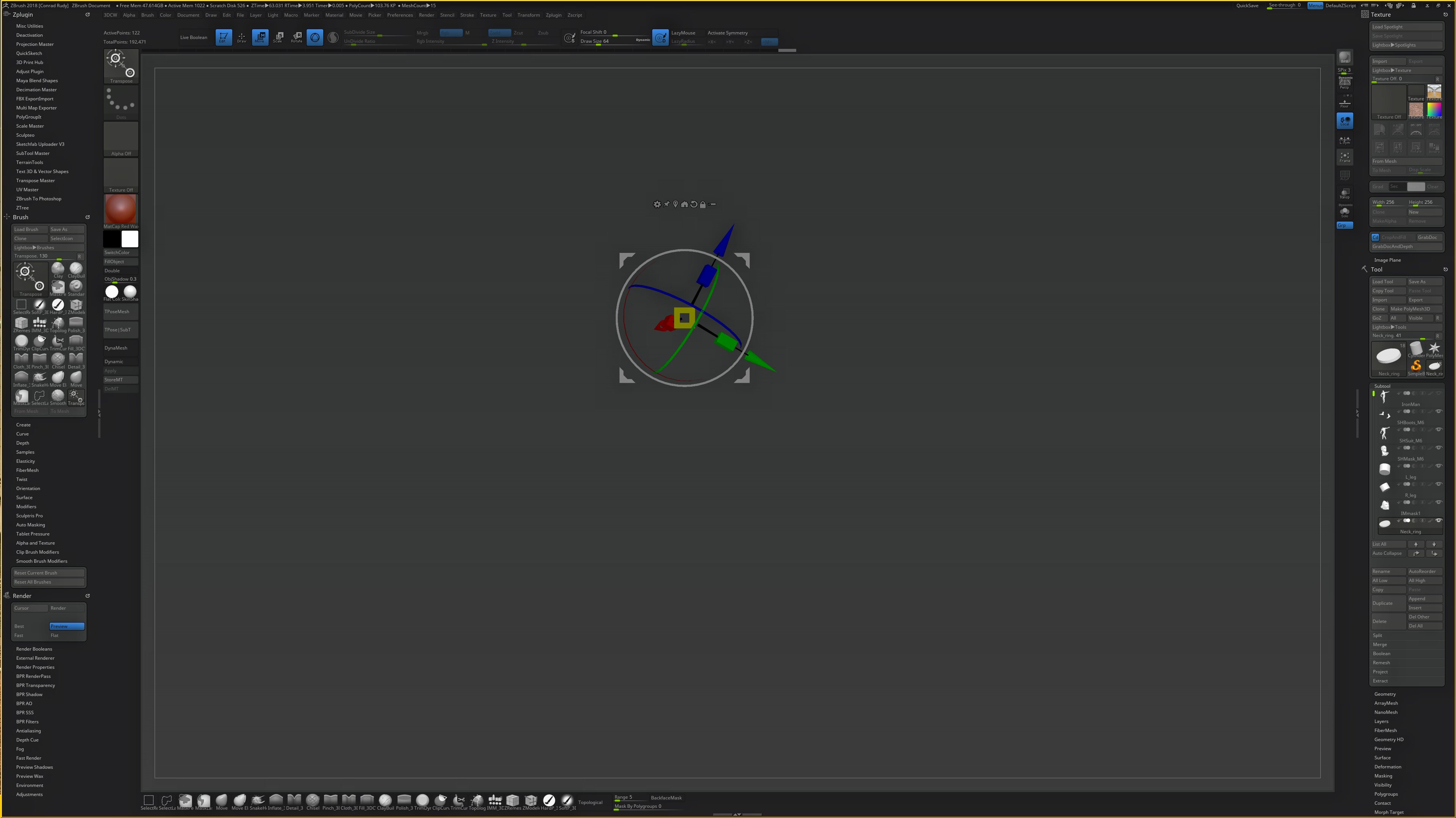

120 degrees rotation and it looks like some sort of clipping plane:
One more degree and all visible again:

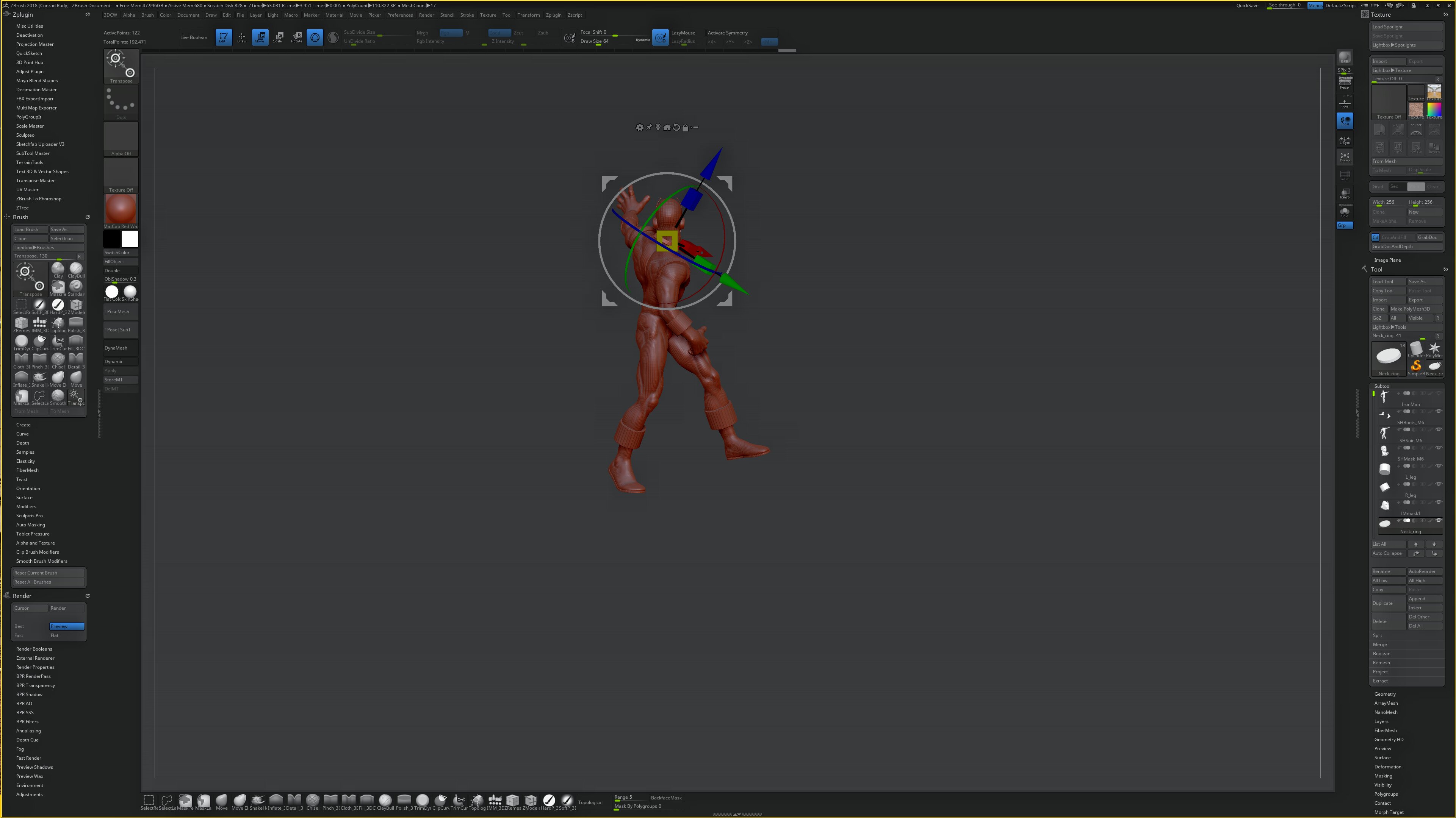

How far I must zoom out to make tools visible:

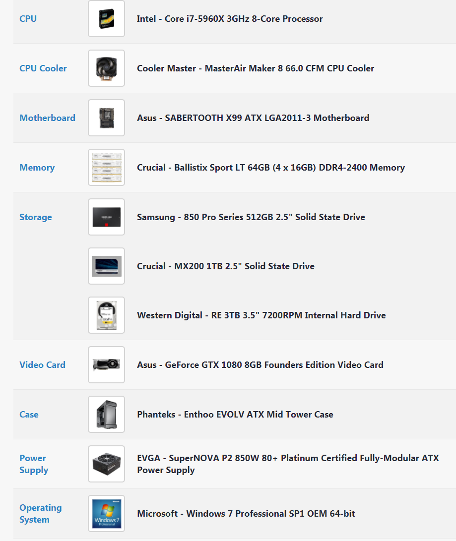

My PC specs:
I’m using Shane Olson’s UI from his 3D Character Workshop. Should I be scaling everything using the 3D Gizmo rather than deformation?
Intel i7 5960x 3 Ghz 8 core processor
64 GB DDR4 2400 RAM
Thanks for any help!
