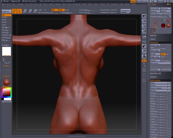

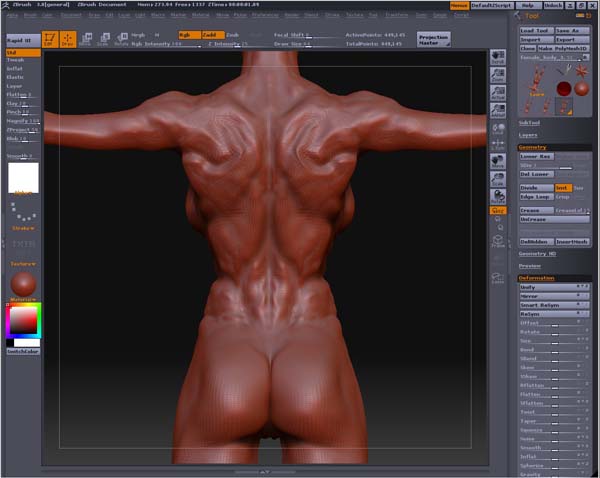

As for the other issue with the mysterious arm, someone suggested that I hit unify. I did it and now I’m even more confused. When I load the model from the most recent list the mysterious arm is still there and when I hit unify nothing happens. When I load the model the normal way, using the load tool menu, the arm is not there, like I said before, but when I hit unify this is what happens: check out before and after jpegs

Seems that clearing the mask before hitting unify took care of the gnarly looking deformation issue. I still have no idea how it happened or why.
