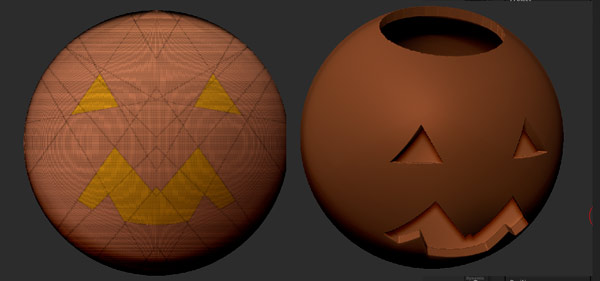

The Dynamesh Create Shell function seems exactly the tool for what you describe. Create your pumpkin shell, then cut out the face with Dynamesh inserts. See Pic. If the Dynamesh subtractions are failing to work as intended, and you’re certain you’ve eliminated the possibility of user error by being sure you’re able to perform negative subtractions with other tools reliably, then that is probably a separate issue.

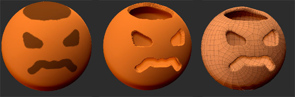

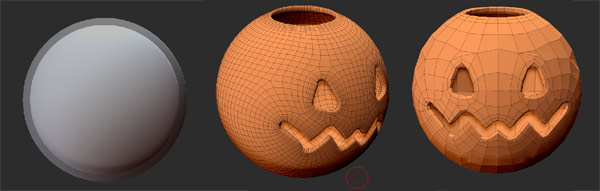

There are always a half dozen ways to get from A to B in Zbrush if that doesn’t suit you. If you want to draw the cutouts more organically, you could duplicate your pumpkin inside itself as another subtool, scale the inner pumpkin down, push in your face on the outer pumpkin with alphas or brushes past the surface of the inner pumkin, then merge the two subtools, group the inner pumpkin as a negative dynamesh sub, and subtract the core pumpkin from the outer. The Slice Curve brush can be used in conjunction with the transpose extrude function to get razor crisp cuts. You can then use the wonderful Zremesher to derive some more manageable low poly wires so you can isolate poly loops for creasing:

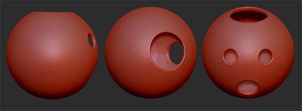

You may also want to play around with storing a morph target of your pumpkin, masking a face on via brush, alpha, or polypaint, inflating, then using the “Create Difference Mesh” in the Tool > Morph menu. Again, Zremesher can be used to clean up geometry.
