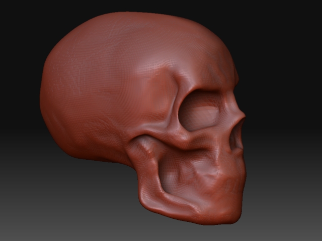

The image planes worked out pretty cool. Here’s my attempt at following one of the new tutorials.
[attach=144991]skull.jpg[/attach]
However, I’m still trying to get through the first tutorial. I can’t seem to get the Retopologization thing down.

Fiveby - that looks killer. I’m a major noob and was wondering how long that took you? Did you use the sphere3d tool to start? And then the tweak brush just like the tute - or did you stray on the methods? Seems like that tute might be easier if you started with a lower poly sphere and then subdivided as you went to get the extra detail… Like I said, I’m a noob with ZB, but those are my thought - curious if I’m right or not.
Later - Mike

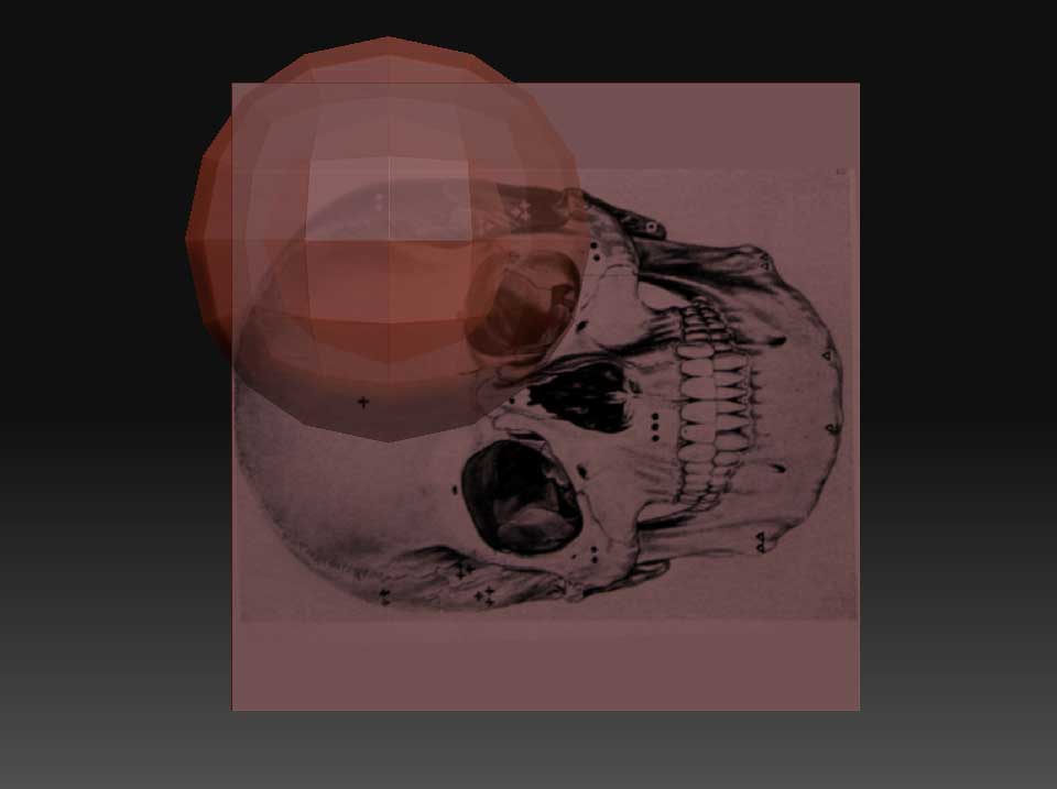

Hi,
Good start! :slight_smile:
Can I ask you how you managed to do the tutorial, because I get stuck after load the reference images, they do not appear orientated like in the tut. And It doesn’t says which tool you need to start it.
This are my steps:
1.- Open ZB3.
2.- On the Tool palette Load Tool, and Load the PolySphere.ZTL from the ZTools folder.
3.- Draw it in the canvas. Press the Edit button (t key).
4.- In Tool Palette > Geometry, press Lower Res. And then Del Higher.
5.- Repeat this step until you have alower version
6.- When you cannot reduce it more, press Reconstruct Subdiv followed by clicking Del Higher a couple of times.
7.- Now on the Tool Palette press Make Polymesh3D.
8.- Now on the palette Macros > Rapid Start > press Image PlaneX and load the Skull_xplane.jpg that you can download from the wiki page.
9.- Here is where I get stuck, look how ZB import the images and the position of my PolySphere.
Thanks in advance for any help.
Best regards,
David
[attach=56481]ZB3_ImagePlane.jpg[/attach]
Did you try to rotate it? Click outside of the objects and rotate - hold the shift key down constraing it to lock. Hope this helps - I didn’t have problems with the reference plane, but couldn’t figure out how to get the mesh lower - you helped me with that :wink:
Later - Mike
Hi,
Glad to help. I am sure there are other way to get a lower PolySphere with less step, but I didn’t found yet how! :slight_smile:
Yes you can rotate the plane and the sphere at the same time. But what about put the sphere where you can use the symmetry? That it is where really I am stuck.
Best regards,
David
Just hit the “x” key - that will turn on symmetry on the X axis. I’d have to dig around to find it in the menus. Good luck - looking forward to seein’ your skull!

Fewer steps:
  1. drag a sphere onto the canvas
  2. “T” into edit mode.
  3. click Tool menu: make polyMesh3D
At this point you can tweak it a little into an oval shape, then check the TOOLS:PREVIEW window to make sure it’s aligned. (I think this is the part that got ya, your sphere got moved from center somehow)
Time to load the image plane X
  1. MACRO: IMAGE PLANE X (now it should be on canvas, aligned and ready to go)
  2. toggle on Transp Icon so you can see through your sphere.
  3. start tweaking!
Step 1 could have been: import an obj from another package or a zsphere model or whatever you like to begin with.

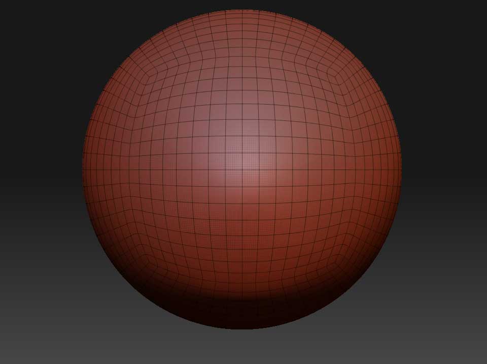

Hi FiveBy
You are right, but the polysphere I got has a LOT of polygons and it is not at the same resolution that you can see on the tutorial. I am posting a screenshot.
Then If I follow my steps, and ALWAYS the macro displace the planes.
If I follow yours, then works, but of course it is not the same as in the tutorial! :slight_smile:

[attach=56497]ZB3_PolySphere.jpg[/attach]

[QUOTE=dballesg]
I was aware of the prewiew window. But on the palette Draw > Preview, the PolySphere looks gigantic. On the Tool Palette preview I always got a star?
[QUOTE]
Hmmmm. First, it doesn’t have to be the same number of polys for you to do the tutorial. You start with the default, rough in your shape, then start dividing to add polys.
But then you said in your preview you see a star? That’s the import tool, so you’re importing a sphere? No need to do that. Just start out with the sphere tool, then make it a polymesh.

Hi,
Fiveby, I see what you mean. Starting with an Sphere and then simply start sculpting with the tweak tool.
And have the advantage that puts the planes where they must be! :slight_smile:
About the star on Tool > Preview, you are right as well, I was loading the PolySphere that is why always you get a star there! :slight_smile: It would be better if ZB put a copy of your loaded tool, less confusing! :slight_smile:
What stills surprise me, it is that problem if you load the PolySPhere, reduce it number of polys so it is more manageable, when you execute the macro, the planes appear on a different size and the reduced sphere it is not on the center, so if you try to use symmetry is impossible. I think I discovered a bug here with that process! :slight_smile:
Only to clarify, your way works perfectly.
Best regards,
David
