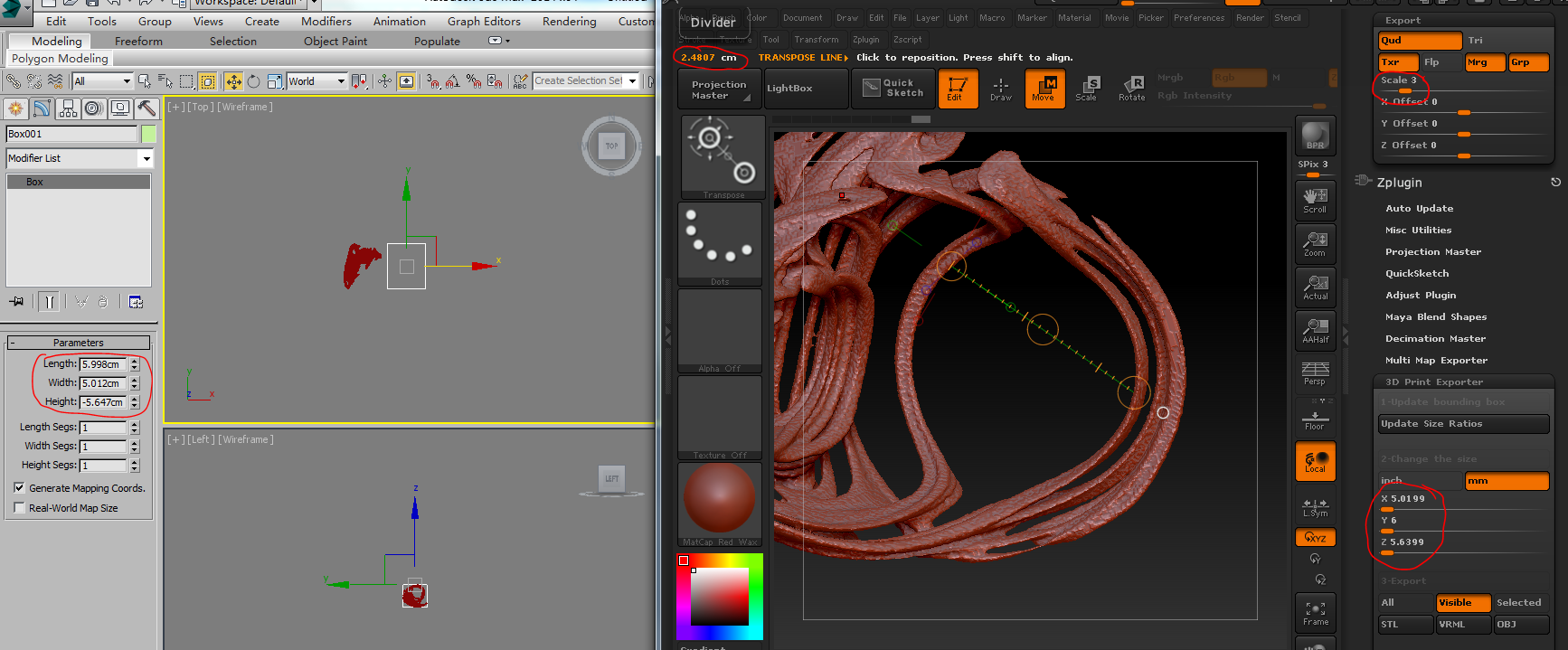

Also note that changing the Tool->Export scale settings will adjust your Zbrush units when measuring with the transpose tool. My 100mm model is 100 Zbrush units at a scale of 1 but too large to work properly with Zbrush’s brushes and tools. My same 100mm model at a scale of 50 will show up as 2 units on the floor grid but will still show at 100 units while measuring with the transpose tool.
