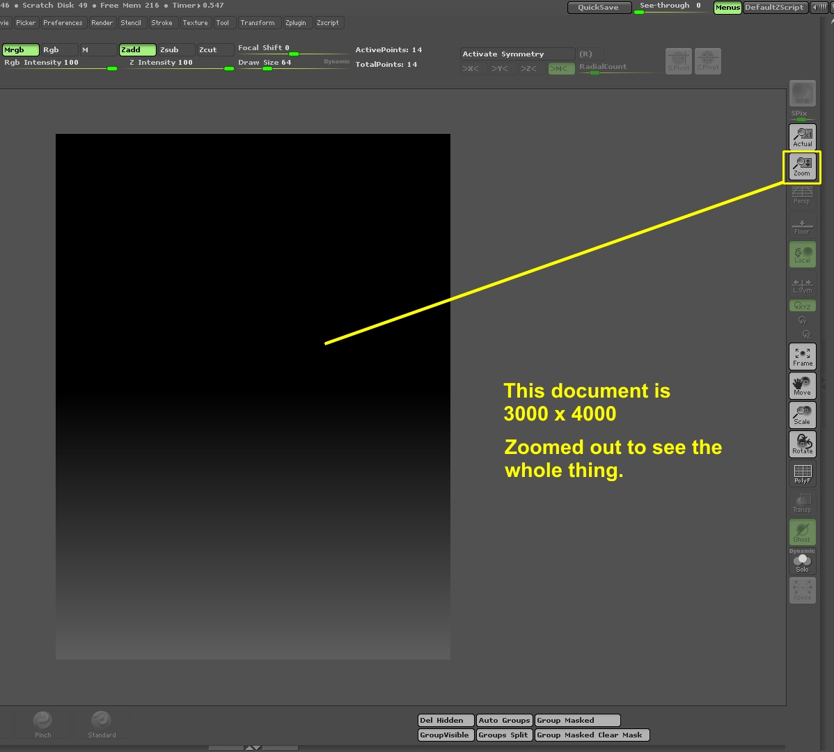

  2. On the right shelf, use the Zoom button to zoom your document out until you see the whole thing. You will see the borders when you have zoomed out enough.

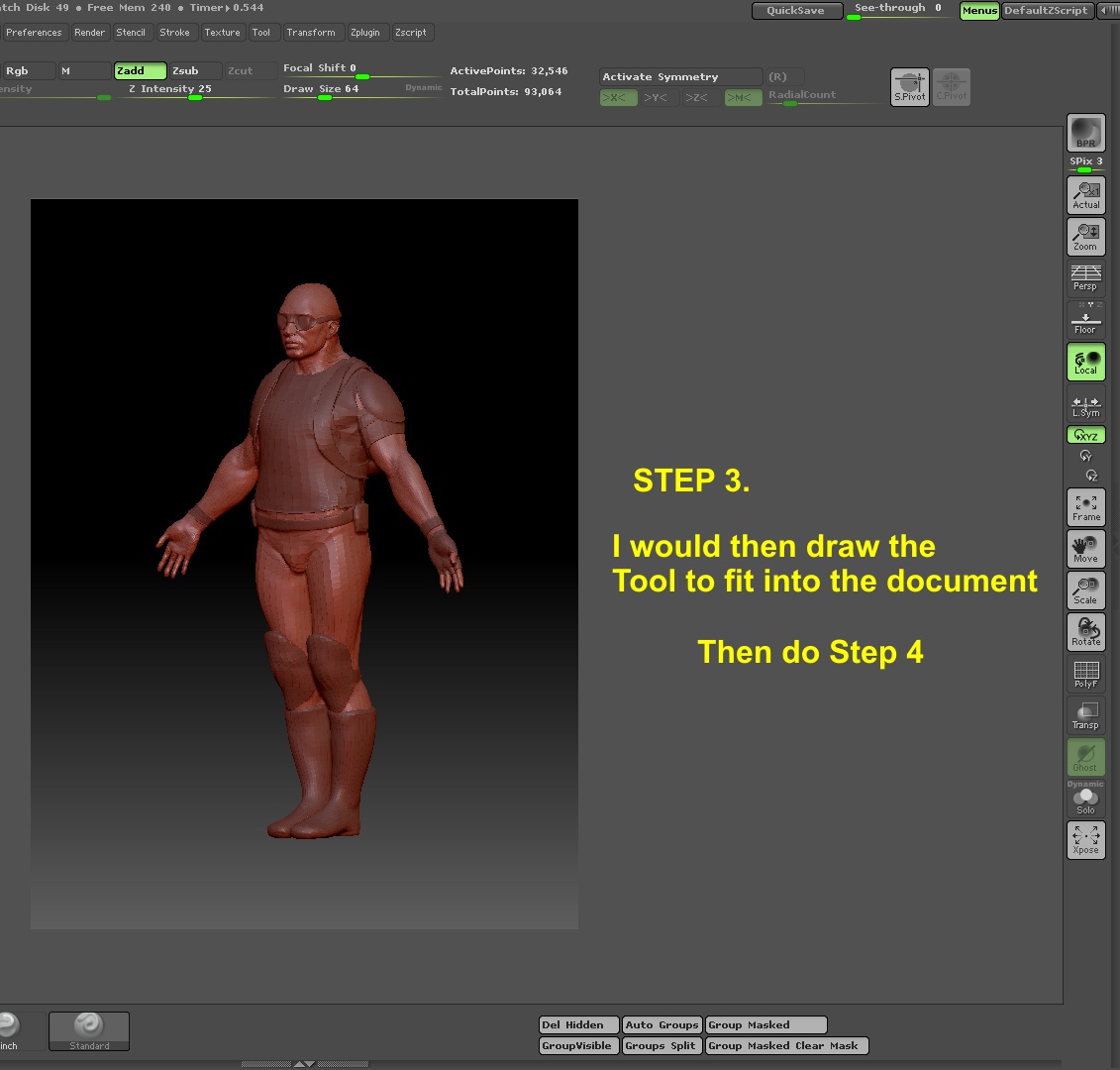

  3. Draw the Tool on the canvas to fit inside of the document and arrange as you wish.
  4. Do a BPR render then go to Document menu and click Export button to save your image.

After you do step 2 from my first post, that is your preview. You are looking at the whole document, so what you see is what your final image will look like. Just render and export that to see it in full size.
don’t mean to butt in here. just wanted to say note that in step 2, zber2 is saying to zoom the document, not the objects.
@ ebrake94… This is what I meant by step 2.
