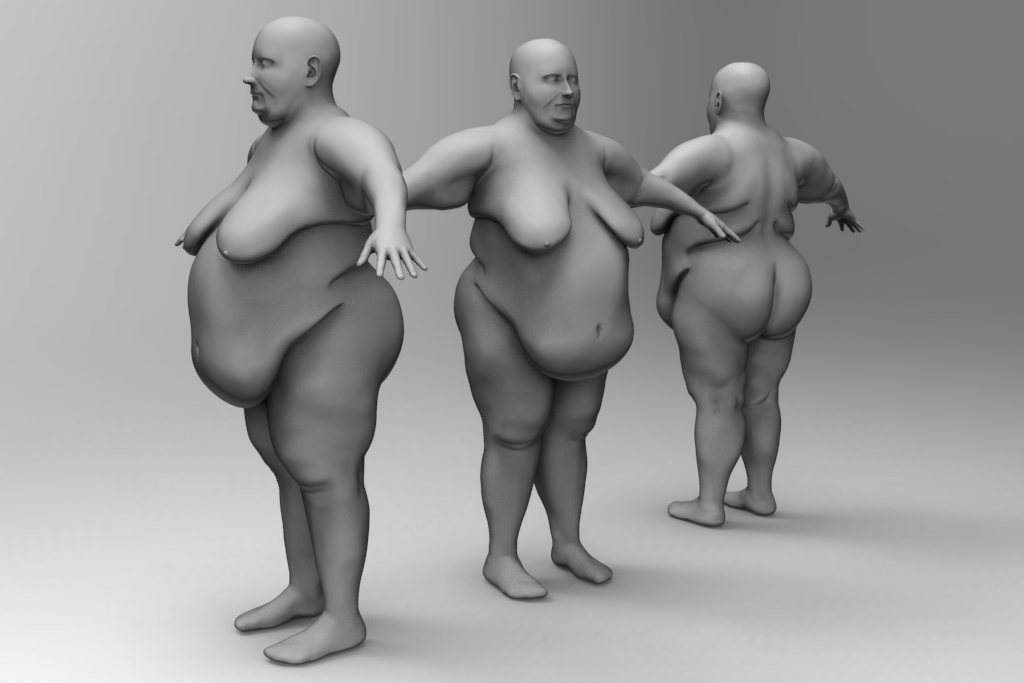

So I’m working on this model where the figures belly is large and intersects with the legs (see image below). Right now the body and legs are separate dynamesh subtools. I’m trying to figure out the best way to go about retopo-ing the entire mesh together. I was planning on manually doing the retopo in Zbrush using the zsphere method, but I know that you can only select one subtool at a time to do this and merging the body and the legs prior to retopo might make it difficult to do the retopo where the belly and legs overlap.

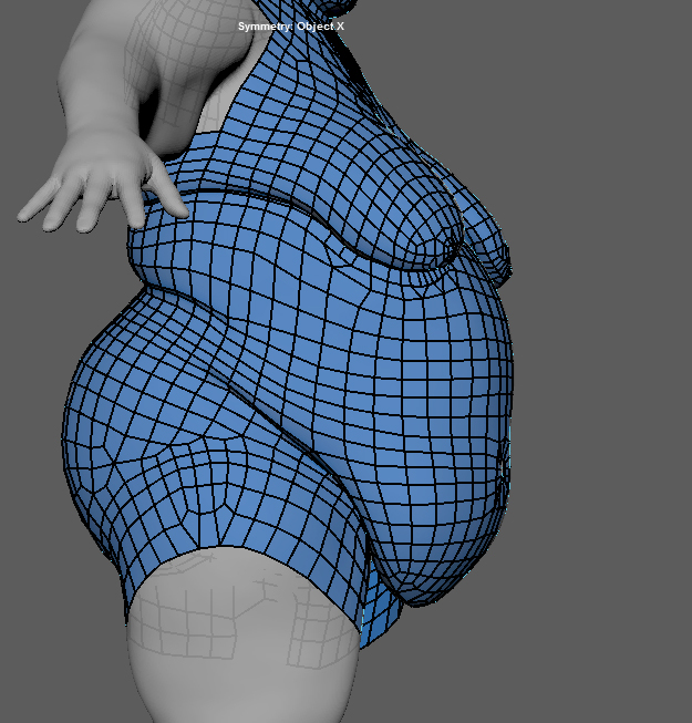

Yeah I didn’t want to retopo with zremesher. I needed to manually retopo. So I ended up just exporting to maya and using quaddraw to retopo. This way I was able to alter the live mode for torso and legs as needed. It’s still a struggle, but doable. I think it would have been impossible with zspheres.
