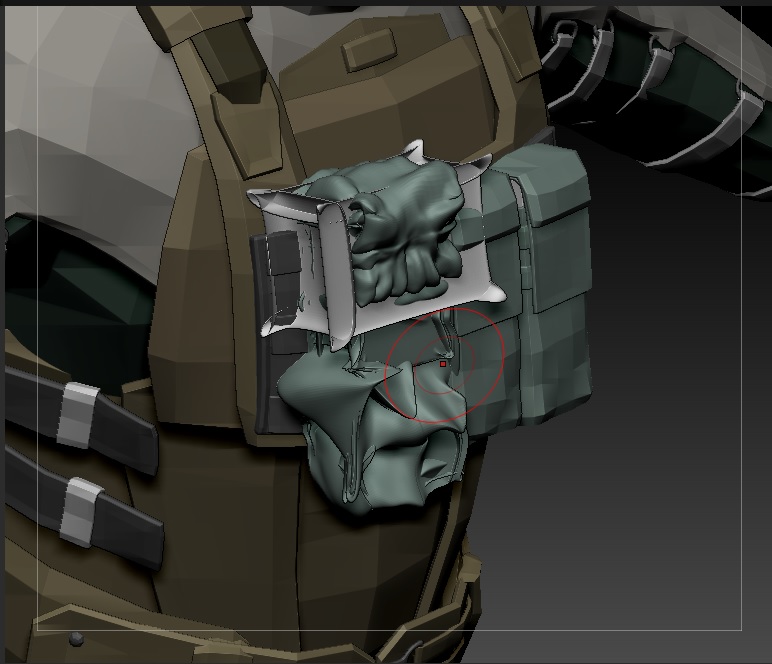

I have tried using Transpose Master, going from TPoseMesh>Unify>(TPose>Sub) but that screws up the mesh really badly (tried this on a low poly object with the same result). Up-dividing after TPose>Sub:

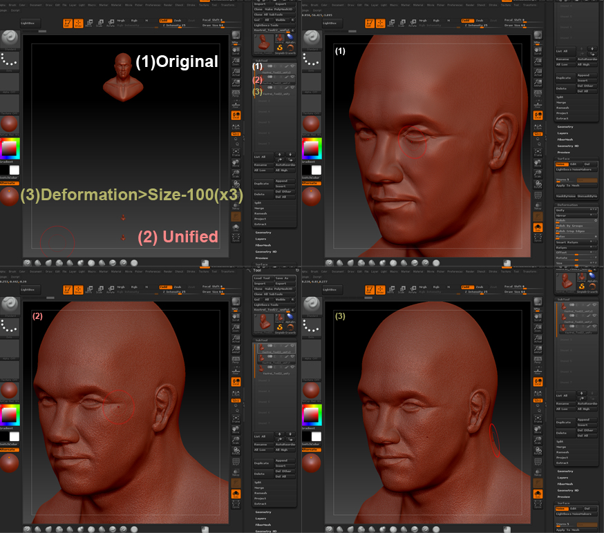

All 3 heads used the default Noisemaker with 3 Scale. You can clearly see that the original head’s noise is all messed up compared to the scaled/unified heads. This affects Dynamesh as well, because on an overly large object, no matter how low res you input for the dynamesh, the density does not change, yet this works perfectly on other objects. How can this be the case if the scale does not matter?

The only solution to this that I have found thus far, is to manually use Deformation>Size (x3) to scale down each indivudual subtool, since the scaling is done towards a common point (world axis) rather than unify’s fit to grid (which causes each individual unified object to be of different scale and obviously off-position).
