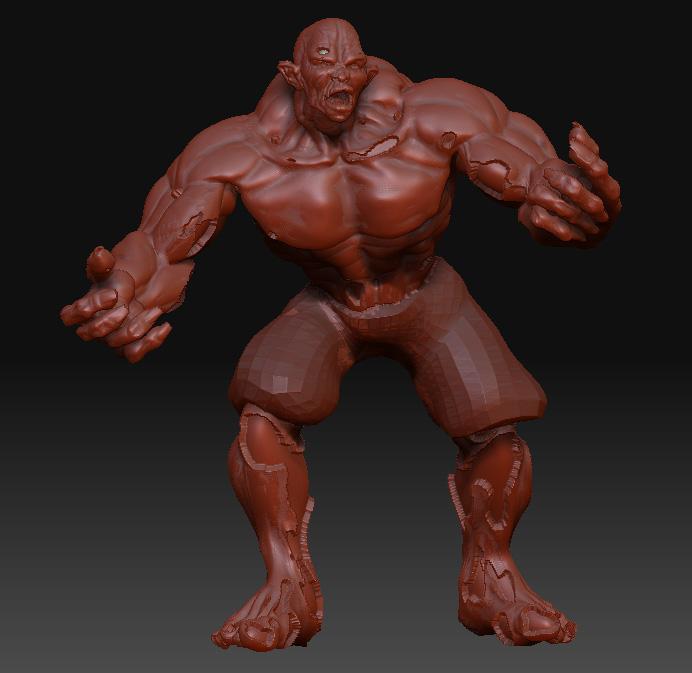

Bad stuff like this? Should double be clicked for both? All of my normals are seem okay. I just checked them for both meshes.
[blankatransferproblem.jpg]
Yep. That’s the kind of bad stuff. Double should be off and the meshes should look good without the “Double” property lit.
I know it sounds like a pain, but here’s how I got past something like this once before. YMMV:
Setup as before, but do not pre-divide your target mesh. Set your source mesh to Level 1 division. Do a project-all onto the target mesh at level 1. Cleanup if needed with the Z-project brush.
Now subdivide your target mesh and set your source mesh to Level 2. Do another project-all and cleanup as needed.
Repeat for levels 3,4,5, and 6. With a little luck and patience you should be projected onto the the target mesh at level 6 in about 15 minutes.
