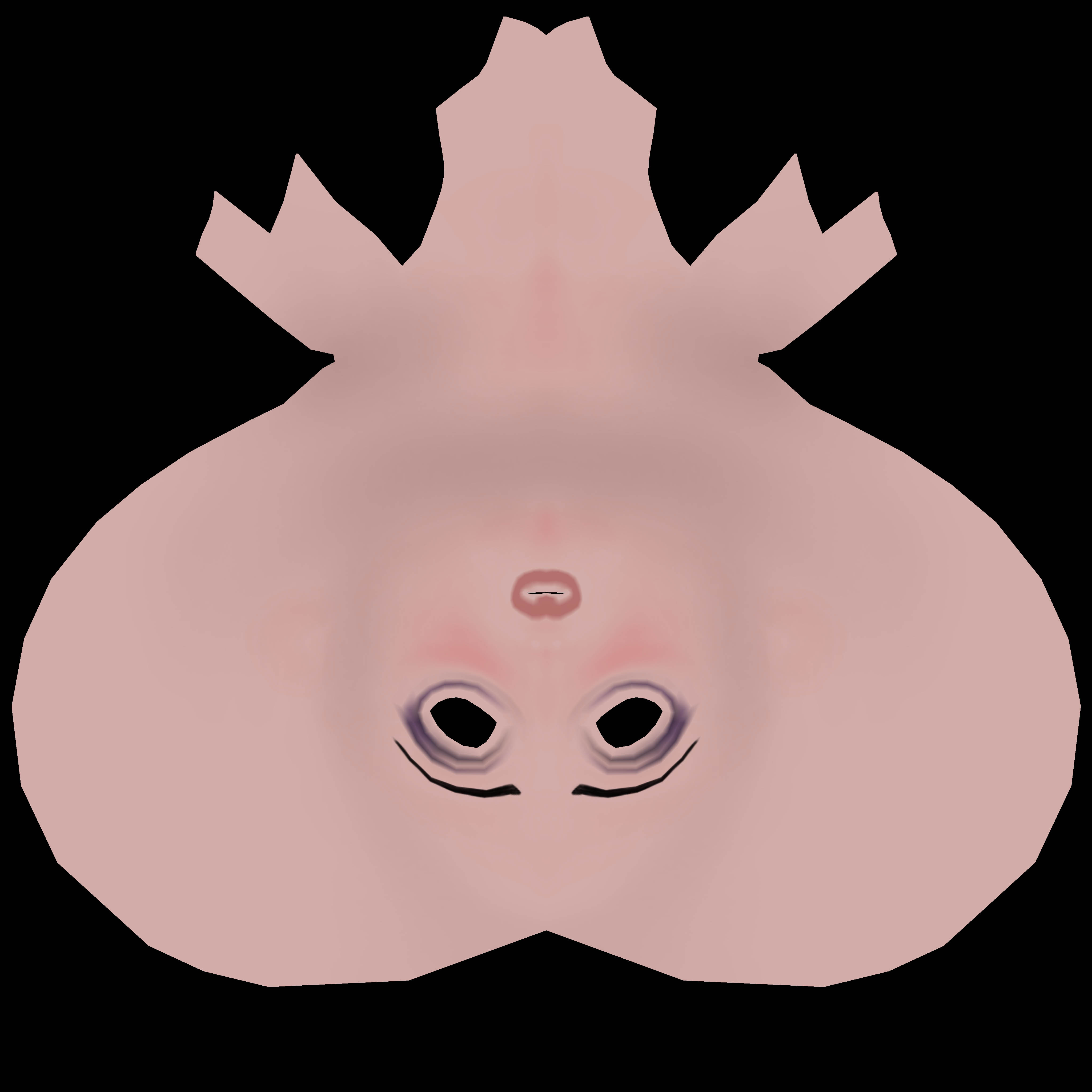

I use Zr6 and when at the highest Sdiv and create the map it is generated as if we were on a lower SDiv. The face model has almost 2 million poly at the highest Sdiv level. The texture map generated is very low quality with jagged edges.
The process I followed to generate the map—
  1. Modeled the low poly mesh in 3ds max
    2)Import it into the zbrush and give some detailing. Then send the lowest level back tho 3ds max for UVs
    3)Import it into the zbrush and polypaint it at the highest Sdiv.
  2. Create the texture by “New from Polypaint” in Texture menu. Clone the texture.
    But the texture quality is very low. Please help to resolve the issue.
    The texture map is attached.

The texture resolution is 2k. I have increased the poly level to almost 4 millions but the texture quality coming out is still very poor.
I am really stuck in this peculiar problem …please Help guys…

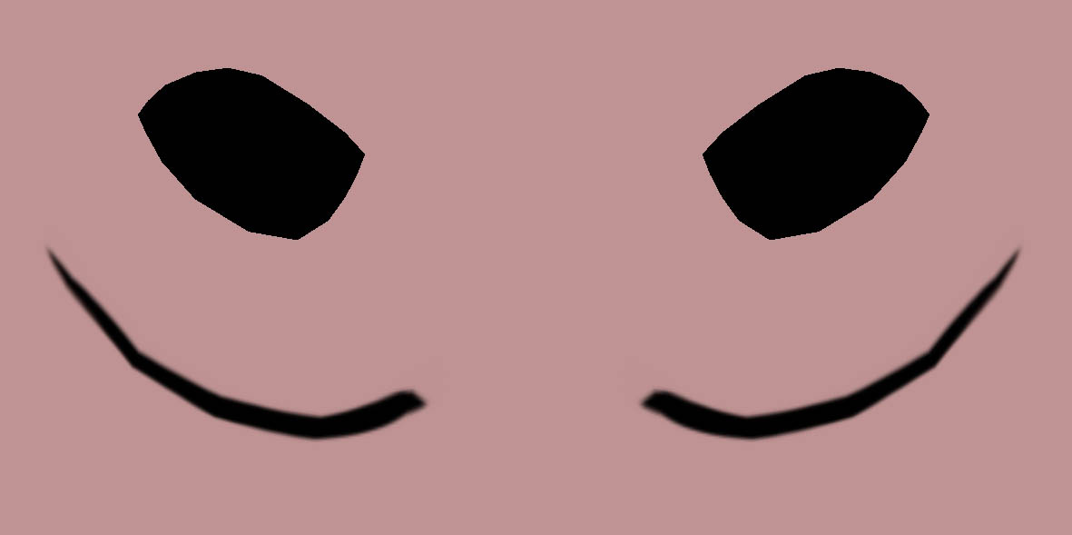

I am facing the similar problem. texture is high resolution i.e. 4096 and polypainted at subdivision level 6 about 2 million active points but it follows the low poly uv map and gives a jagged texture. See the eye-brows in the exported texture (attachment). It looks perfectly fine in zbrush before exporting it.
I am facing a similar problem. polypainted at 2k with 1.2 million active points. the exported texture looks jagged in uv map. see the attachment
