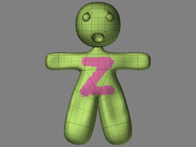

Hello everyone.

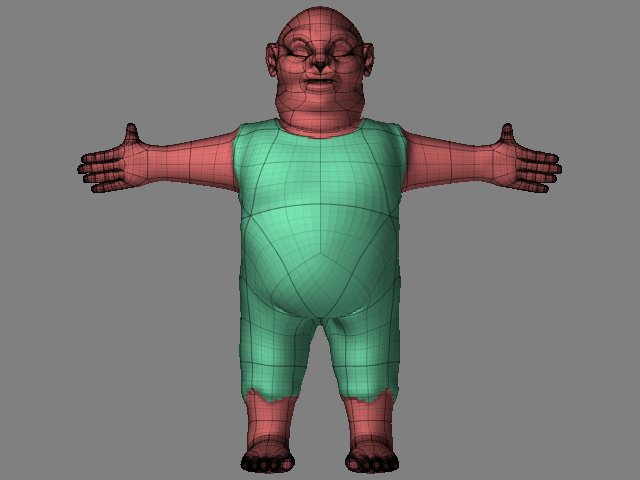

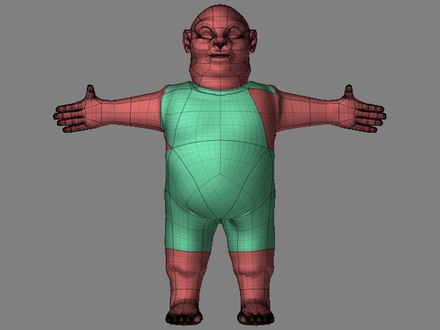

I’m having some difficulty with polygroups. The first picture is what the polygroups should look like. The subdivision level is 5. After I decrease the subdivision level to 1, then put it back up to 5, the polygroups distort, resulting in picture 2. I’ve tried using Auto Groups, UV Groups, and Group Visible but it always distorts. Can I fix this, or do I have some kind of bug in the system? I’m running this on Windows 2000.

Sure. All the modelling was done in zbrush. First, I created the zspheres for the body. Then I sculpted the character using the different tools available. After subdividing it to level 5, I masked the outline of the clothes, pressed “HidePt” so that the only thing showing is the clothes, cleared the mask, and then went to Deformations and used the inflate tool. After that, I went to polygroups and pressed “group visible”. When I lowered the subdivision level to 1, then increase it back to 5, the polygroups are distorted.

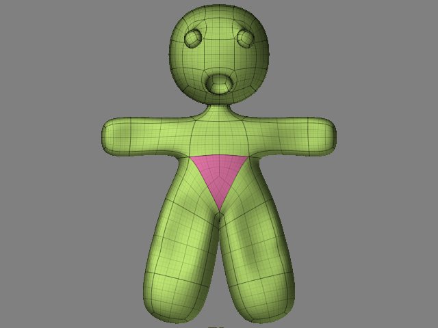

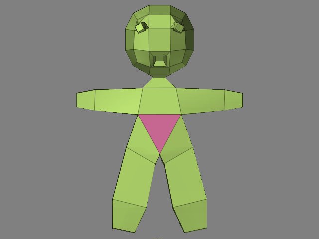

I noticed that when you lower the subdivision level to 1, the polygroups become different. This is due to the number of polygons. But then, when you increase the subdivision to 5, the polygroup takes the shape that it had in subdivision 1, and uses that in subdivision 5. Take a look at picture one. This shows the polygroup that I created. I then lowered it to subdivision 1 (picture 2), and then increased it (picture 3).

What is happening here is a byproduct of multi-resolution subdivision editing.
Polygroups are basically defined from the base level going up. The polygroup info for the highest levels is not stored anywhere. Instead, it’s interpolated from the base level.
When you create a polygroup at the highest level, ZBrush lets you do that. But when you go down in levels, the polygroup info that can’t be translated to the lower number of polygons that you now have gets discarded. So when you get down to level 1 you have a case like what you show where only a single polygon (in that example) is in the group. Now when you go back up in levels the polygroups get reconstructed based on that lowest level. Anything that can’t be derived from that level no longer exists.
