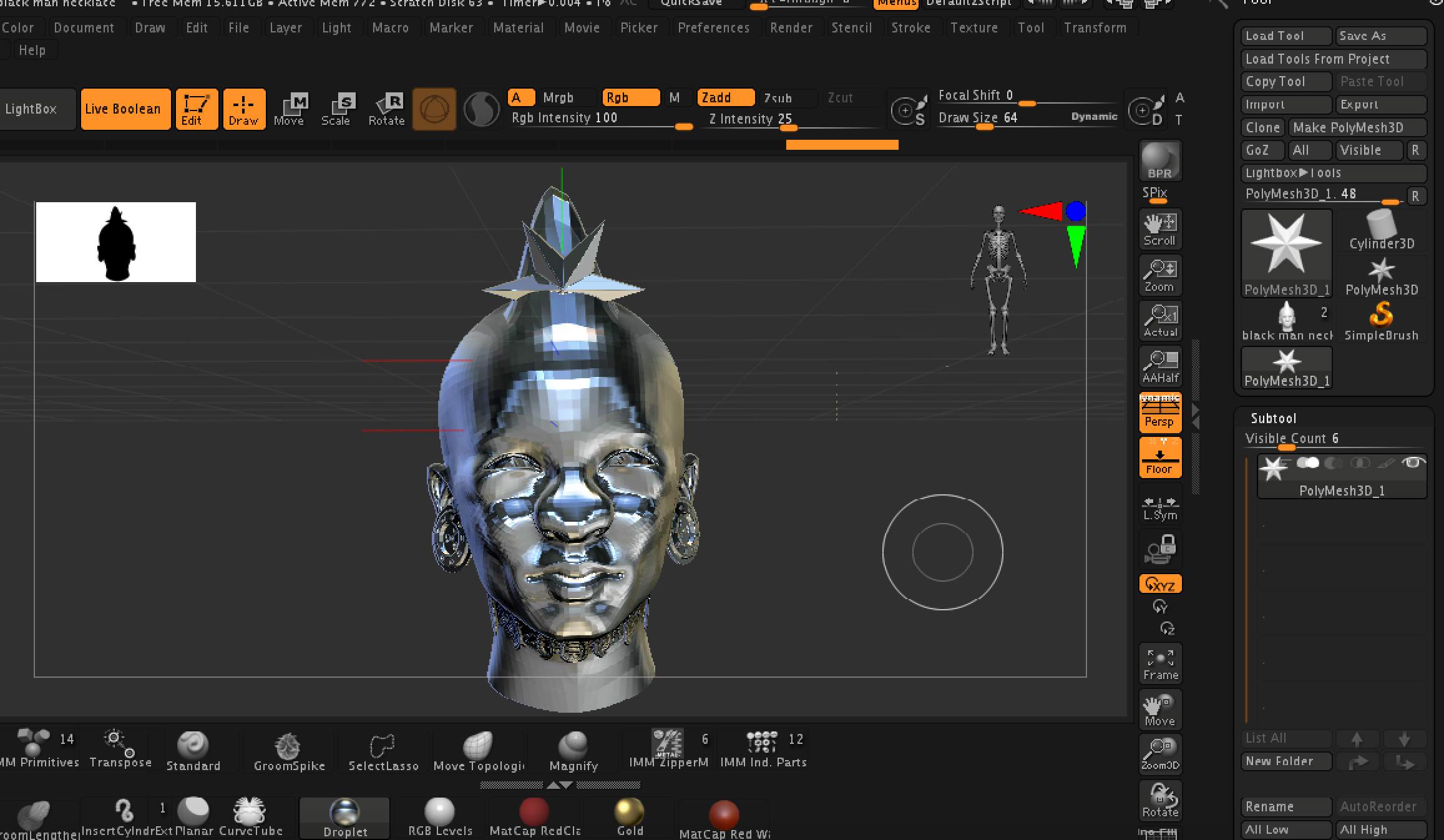

PLs help tool menu not showing tool
Hi! Not sure why the head is showing in the main window but not under the tools, it just vanished and can’t seem to select it ! would appreciate any help​:pray:
Hello @luler
What has probably happened here, is that the head mesh has been dropped to the canvas as Pixols. You can clear the canvas by pressing Ctrl +N. I can actually see the head tool in your tool list above the active Polymesh 3d_1 star tool. Select it to return to working on the head as a 3d mesh.
Please read the following section on Edit Mode to explain why this happens. I would also recommend reading the entire “Getting Started” section of the documentation.
Will def try that thanks!!
Spyndel It worked thanks!! :ok_hand:
