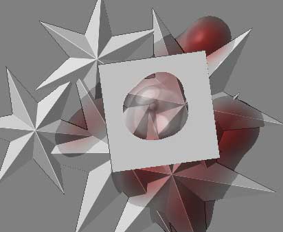

Is there a way to paint a transparent color on a plane3d?
Pilou
The part I’m painting transparent, I want to show thru.
You need to have your plane on a separate layer and also turn of Flatten in the Render menu. Then paint with a material that has a Transparency slider such as GelShader, adjusting the slider to suit.

There is a way you might try. Projection Master sometimes doesn’t like more than one layer so be sure to experiment with this method first and back up any textures by exporting them.
Create a background that will give you something to see through the transparency. Then create a new layer and switch off Flatten in the Render palette.
Select your model and select the Basic Material and adjust the Transparency slider in the Material Modifiers to about -80. Draw your model on the canvas. You should be able to see the background through it.
Drop your model in Projection Master. Using the RGB slider to adjust the degree of transparency, paint on your model. You can use color if you want.
Pick up the model. You should be able to see your transparent texture on your model.
To use your texture in another program: if you painted in grayscale then you may need to invert the texture so that the correct areas appear transparent. If you painted in color, duplicate your texture and then desaturate it before inverting.
