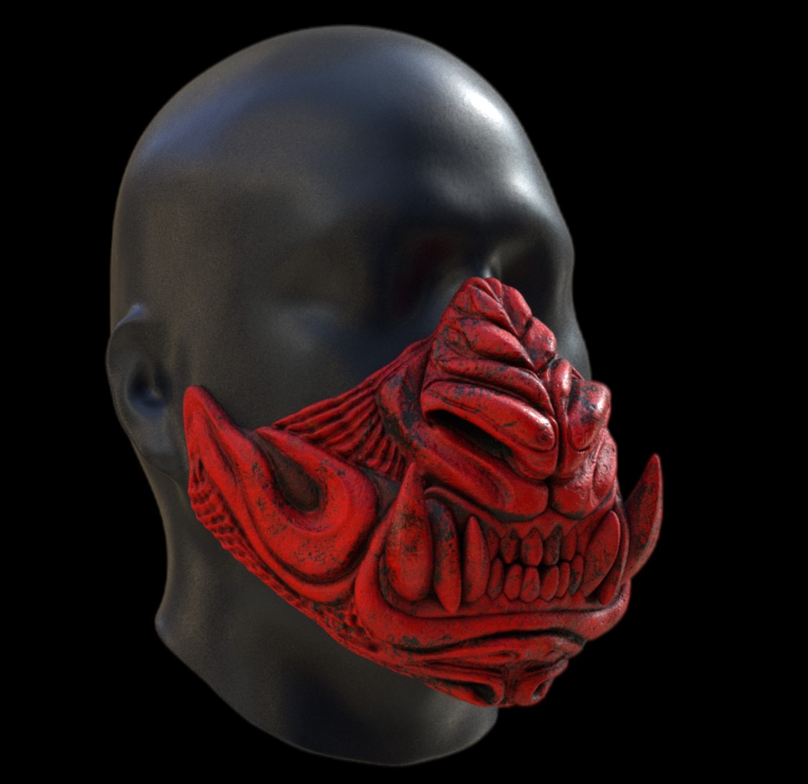

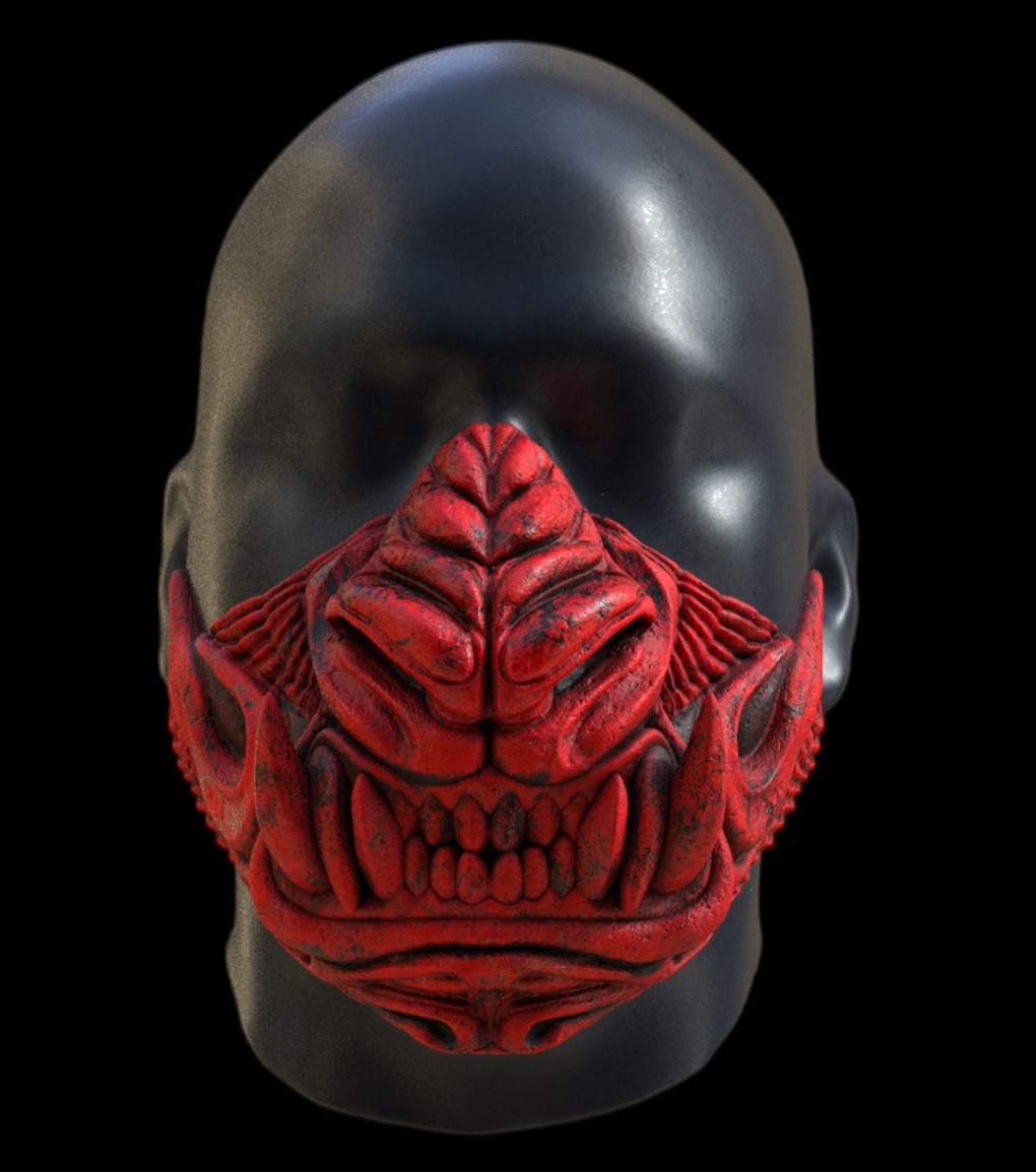

Once the sculpt was complete I took the model into Substance Painter to do a quick prototype of the potential paint job.

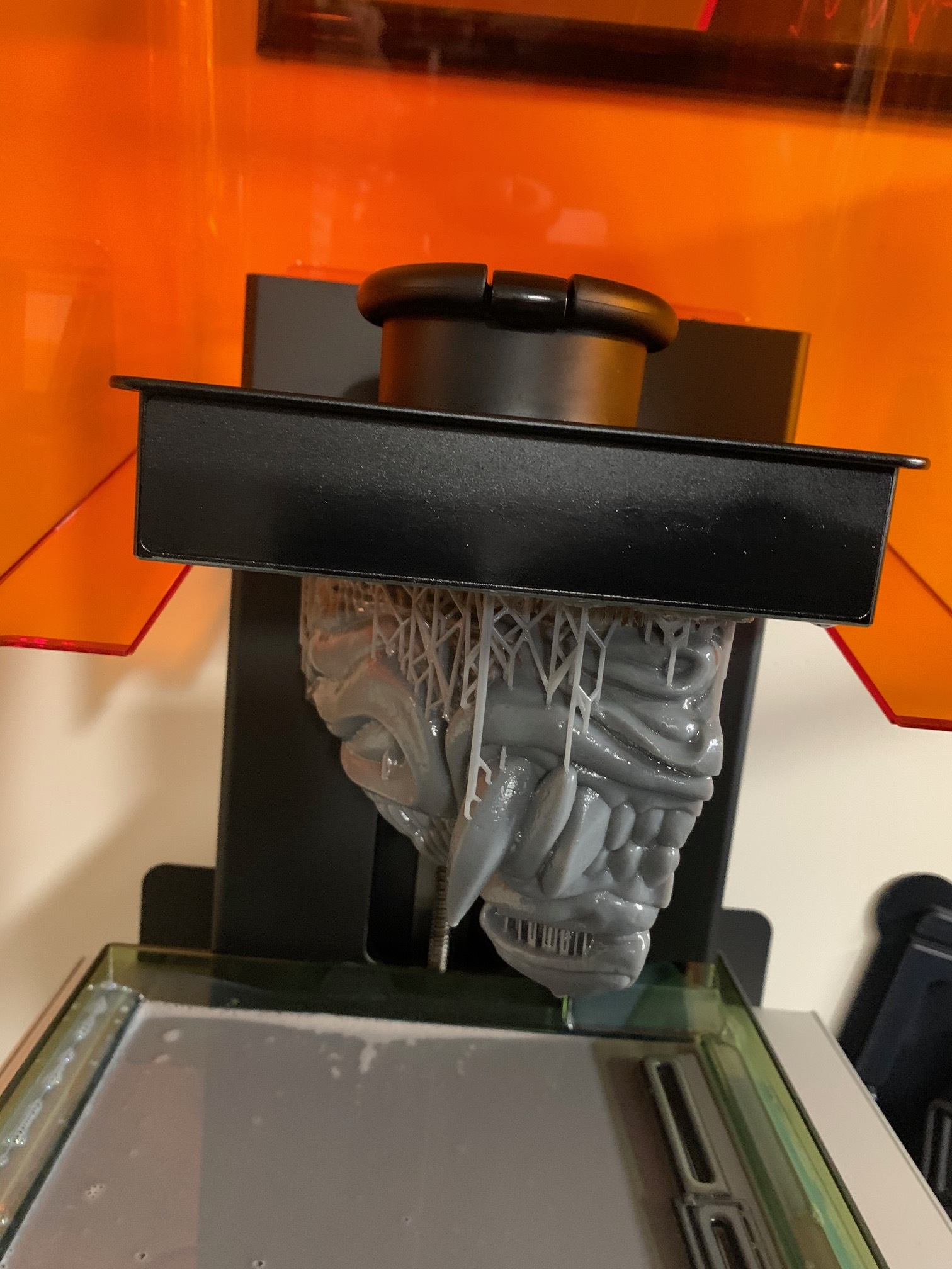

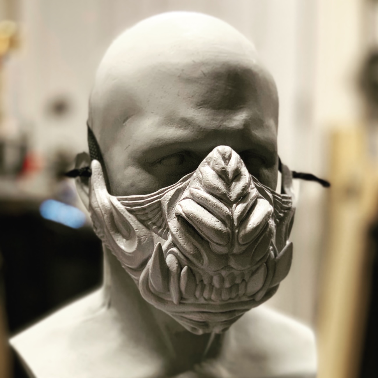

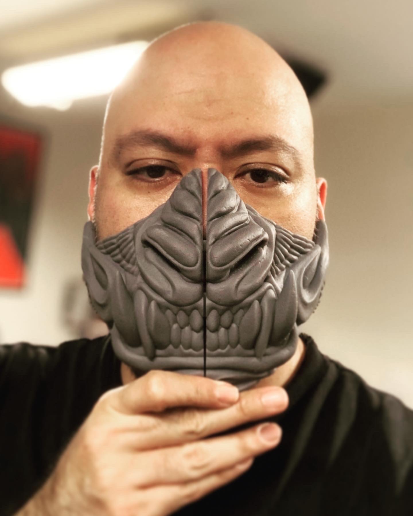

Then I went back to zbush to prep for 3d printing. Using live boolean I was able to quickly set up the model to print. 40 hours later the 2 part print was ready for fusing into one piece. Adding keys made it really easy to assemble and finalize.

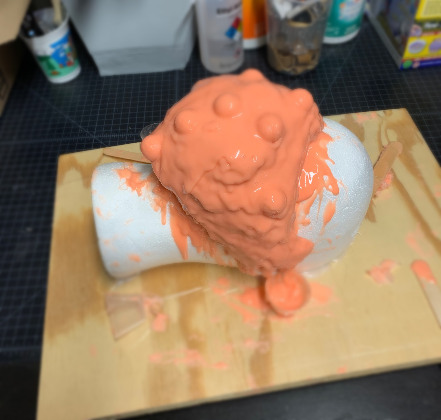

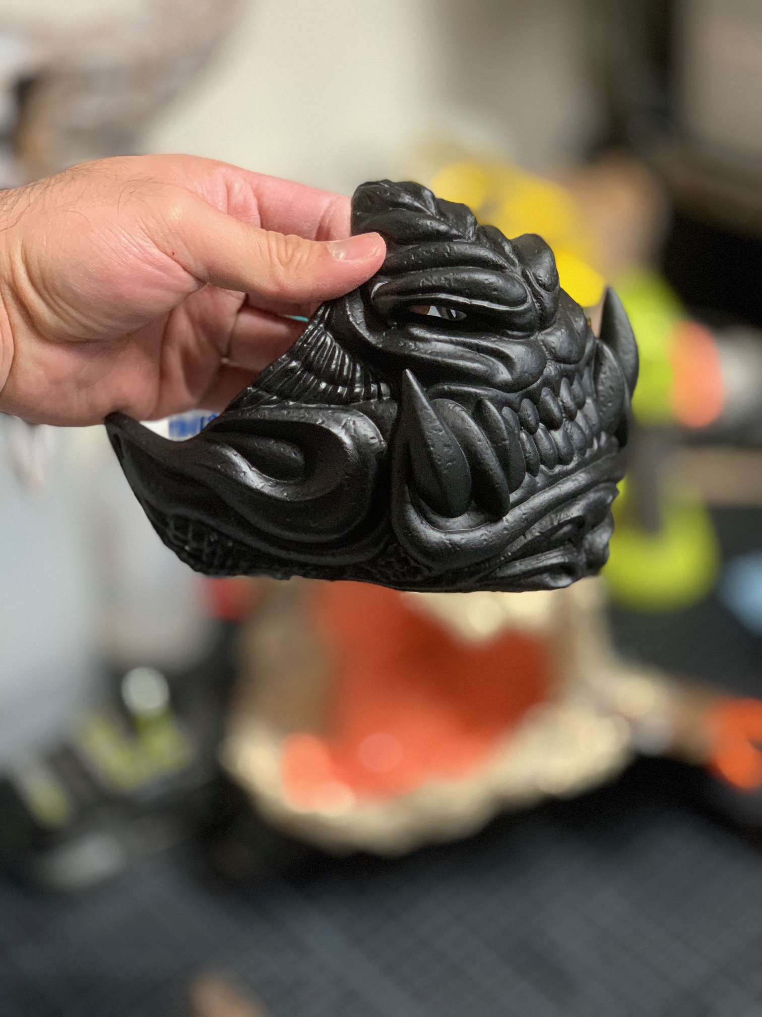

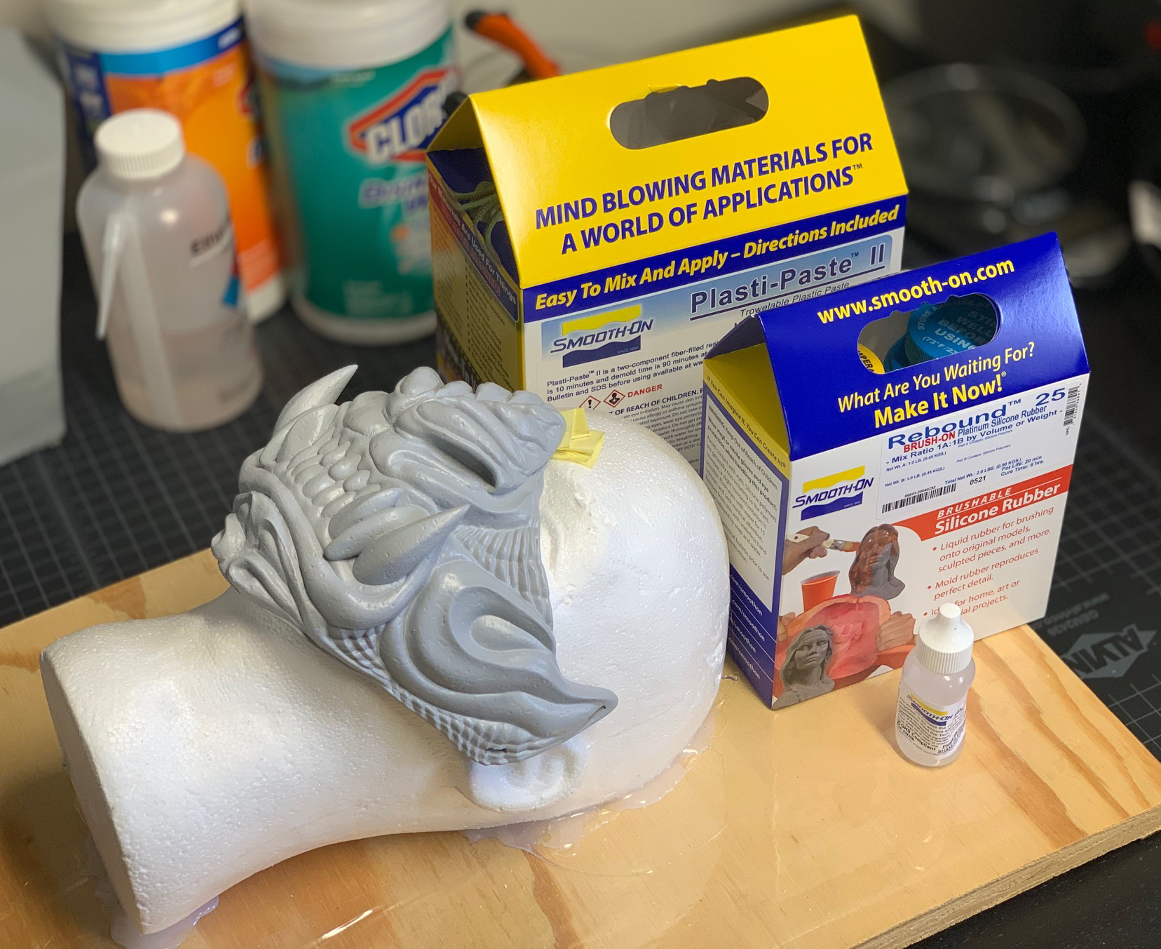

At this point I can just wear the current 3d print. After posting it on social media, I received lots of interest in purchasing one, so I decided to create a mold to try to make copies. Here is a photo of the copies and paint job of the final.
oni01 oni02
