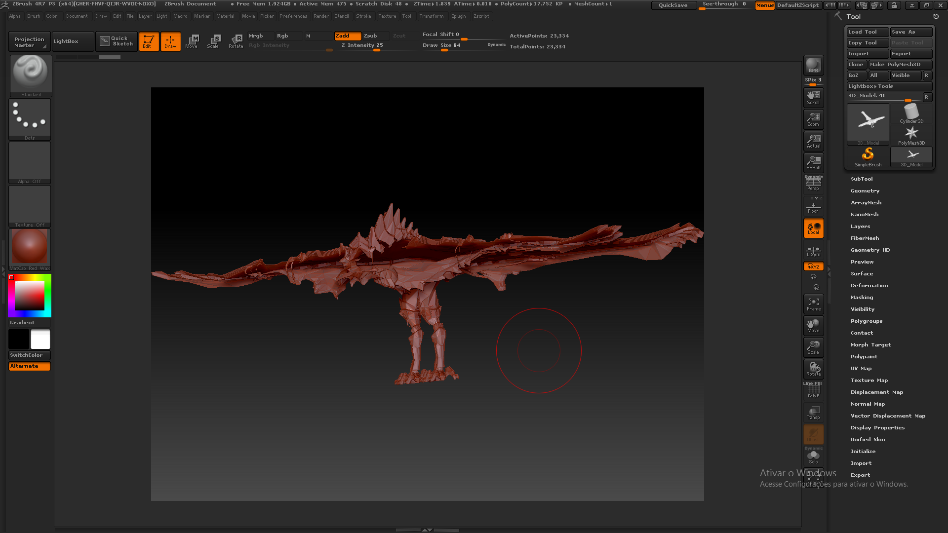

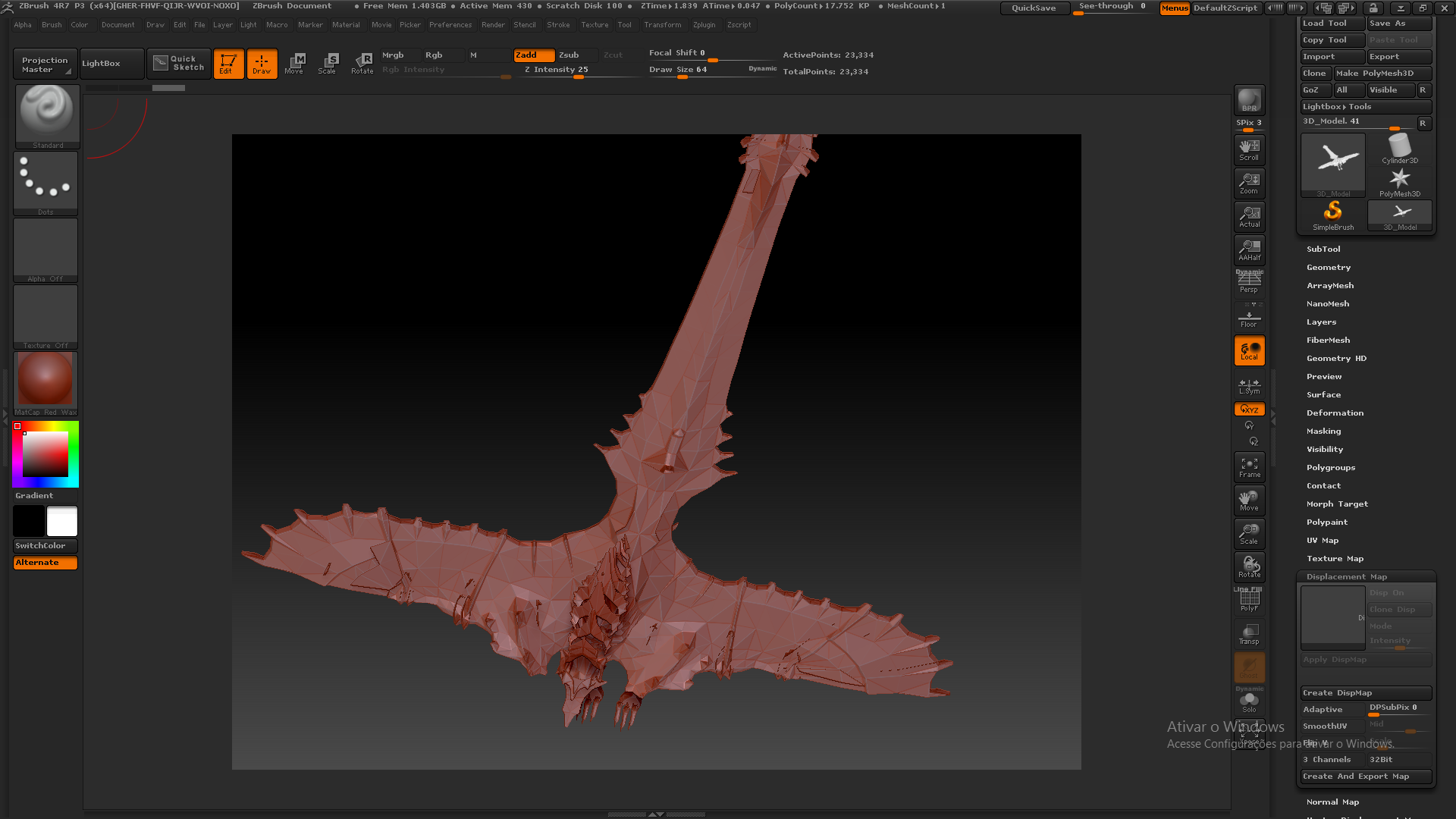

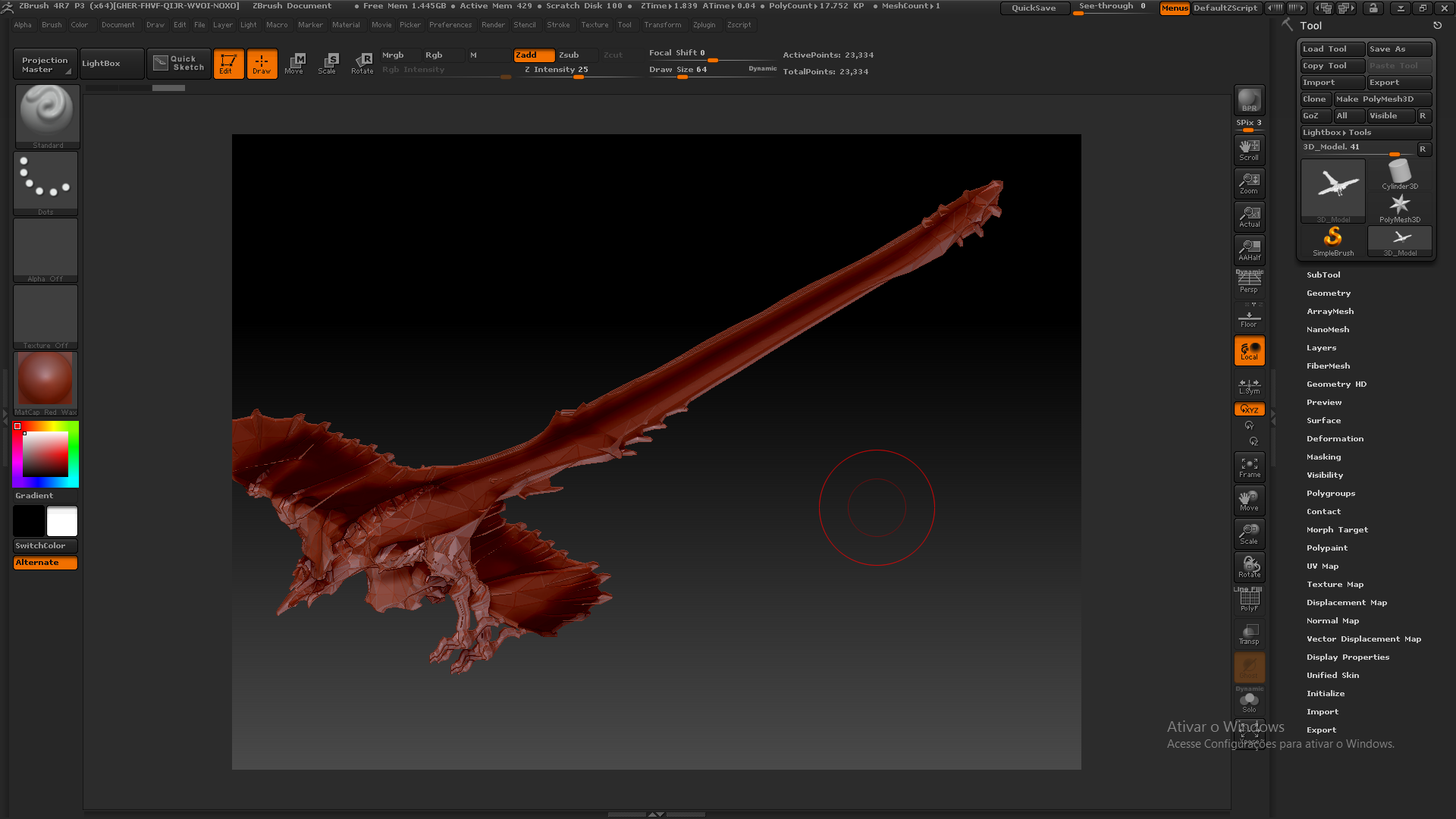

Hi. Well, I have a problem with some .obj models in Zbrush. They looks like hollow, It shows inside de model.I don’t know if it’s a bug or some bad configuration. In others 3D softwares like 3DS Max these model looks fine. I searched about this error but i found nothing, can someone help me?
PS: I’m learning Zbrush
*There are some images
The model’s normals are inverted. You can fix this in the Tool >> Display Properties by turning on Double to render the polygons as double sided. Or you can use the Flip button there to flip them around. Double is best if you need to take the model back into its original software later. Flip is best if you’re only going to be using ZBrush on the model from here forward.
