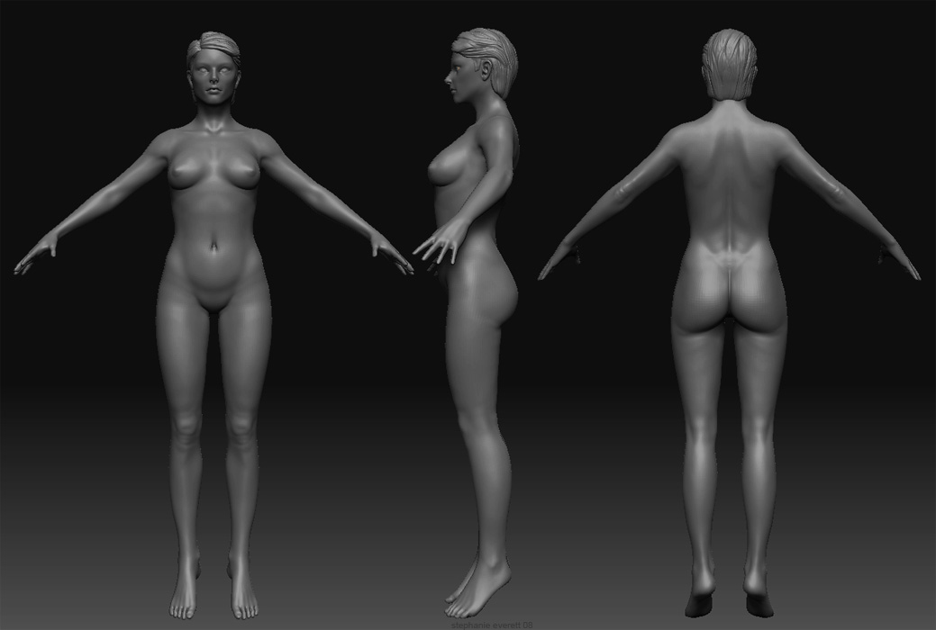

Anyway I’m doing this model for work but I am not happy with it right now. I feel it can be improved alot. My boss, Hazardous helped me alot with this but suggested I post here for more advanced critiques.
I’m still learning and have a long way to go so hit me with all you can give :smiley:
Thank you in advance! <3

Good start, there r problems in the knees, the pelvis, the feet(toes r not strait they point out a bit), the overall curves of the legs(thigh is sopposed to be offset the lower leg) & her crotch needs to go down a bit…
even if she’s floating like superman, her waight needs to be balanced,(in the side view) her legs r a bit loose like a rag they need to go back a bit.
the knees r not strait, recheck her proportions…the anatomy can be better

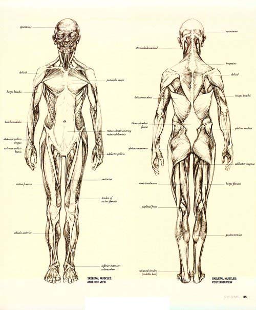

these might be helpfull

Overall I think she looks pretty good, but to me the breasts seem like they’re sitting rather high on her torso and personally I would give her a slightly longer neck.

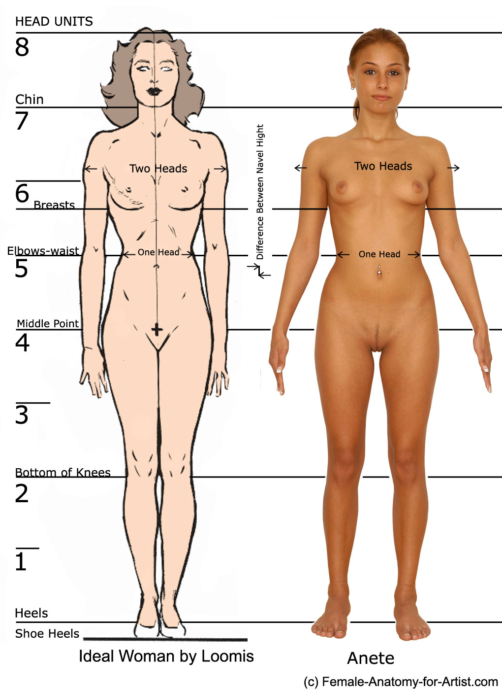

… if you compare her to the image that SIdiMenTion posted from loomis with the live model, your proportions are off. Paying respect to the chart would fix her up nicely.

SIdiMenTion: Thank you very much for the reference and the tips. I will use these today in trying to fix her up. I think I need to go back to sub1 and focus on getting her proportions right.

I wanted her to look like a normal lady so I gave her a bit of cellulite and a bit of a belly. Hehe, my boss tried to smooth them out :stuck_out_tongue:
Thank you for your post and I will post more progress as the days go by. I have to get it done before Feb 26 including texturing.
funnybones: Thanks for those tips, I see what you mean. I will experiment with a longer neck too. I hope its just not the perspective.

I think funnybones is right about the breasts, they’re kinda throwing the shoulders off. The neck appears fine but that might be a good option to lengthen… maybe just a tiny hair thinner. Not too much.

Lumin: I certainly wasn’t offended. It takes alot to offend me lol. I (hopefully) fixed a few things here and there with it. I should have taken a render but was rushed out of the office without the propper time to make one D:
After looking at it for 8 hours a day doing stupidly small tweaks here and there I loose focus on whats right. Its good to get some fresh eyes on it and everyones imput is extreamly appreciated ^^
Oh btw, I gots that toe thing. O_o I was a fairly tall girl growing up so maybe it was adaptation for keeping balanced xD
Tomorrow is detailing pores and eyebrows and stuff. Then next week is all textures. I need it finnished by 4:30 next friday. I need to get the skin looking tops.
SiD: I made her a bit more proportionate I think. I wasnt allowed to make her normal, but I tried to stick to the proportions as much as I could within a “game characters physique” Thanks for your imput ^^

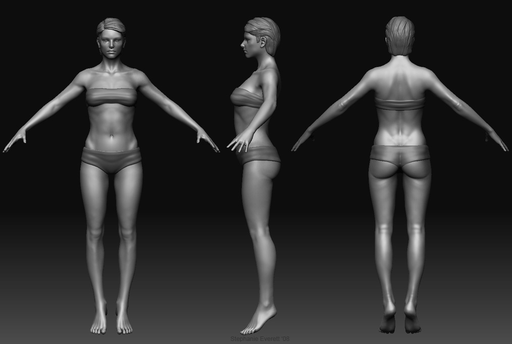

Well here is some progress. Changed the face yesterday, she went though a few different looks before we just settled with a modified original version -_-’ but thats okay I dont mind this one now. I added more fat and made her look less like a alien heh.
Also defined her a bit more. I also adjusted her proportion a bit and tried to point her toes out more, but cause of the angle of the foot it doesnt show it D:

Check the size of the shoulders and head, I think you could make them just a bit larger (head larger and shoulders wider) and the neck muslces are too pronounced. Overall the main proportions are looking good. Also for rigging purposes I would keep the feet postioned flat and raise the arms a bit, inbetween 45 and 90 degrees.
And the jaw goes too far back bring the ears forward, the back of the head may be too large in proportion to the skull, the overall head could be larger.
hope this helps

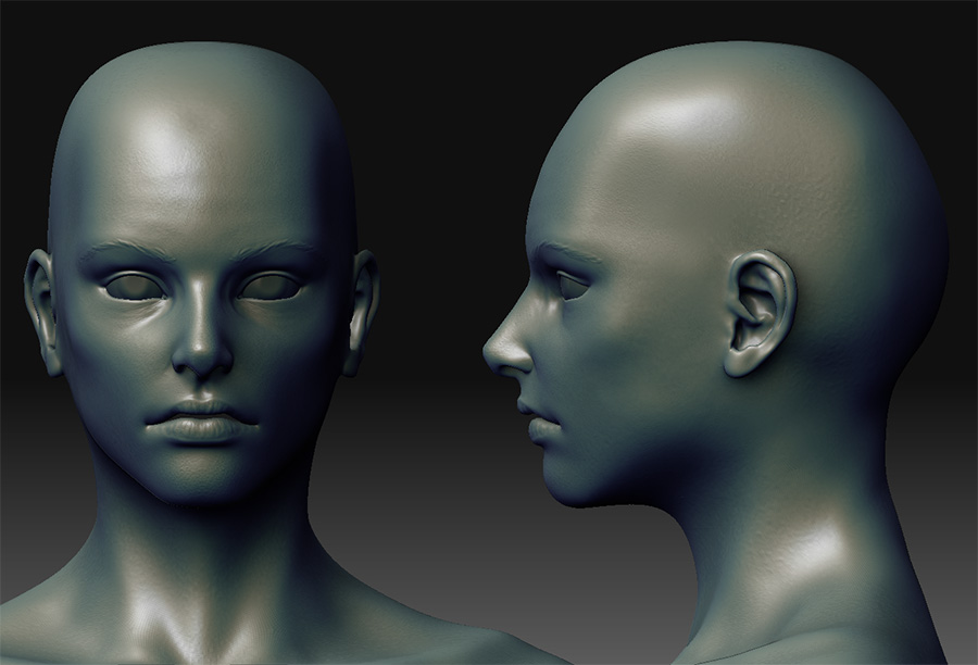

I didnt get much done yesterday as I had to do some FX stuff, but I have started on detailing the face. Now that I look at it the head is too fat at the back. Or something … slaps head
Stop! Image time. Doo do do do…
[Face_01.jpg]
I think this is Erklaerbar’s matcap. Its nice green bronze <3
